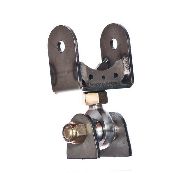

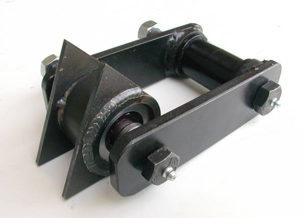

    The upper shackle bolt goes through, then you'd make a shackle based off the outer ring, that will mate to the leaf.
    Edit...
    This is what I was thinking...
    I like the first option better, especially with some hammer hangers

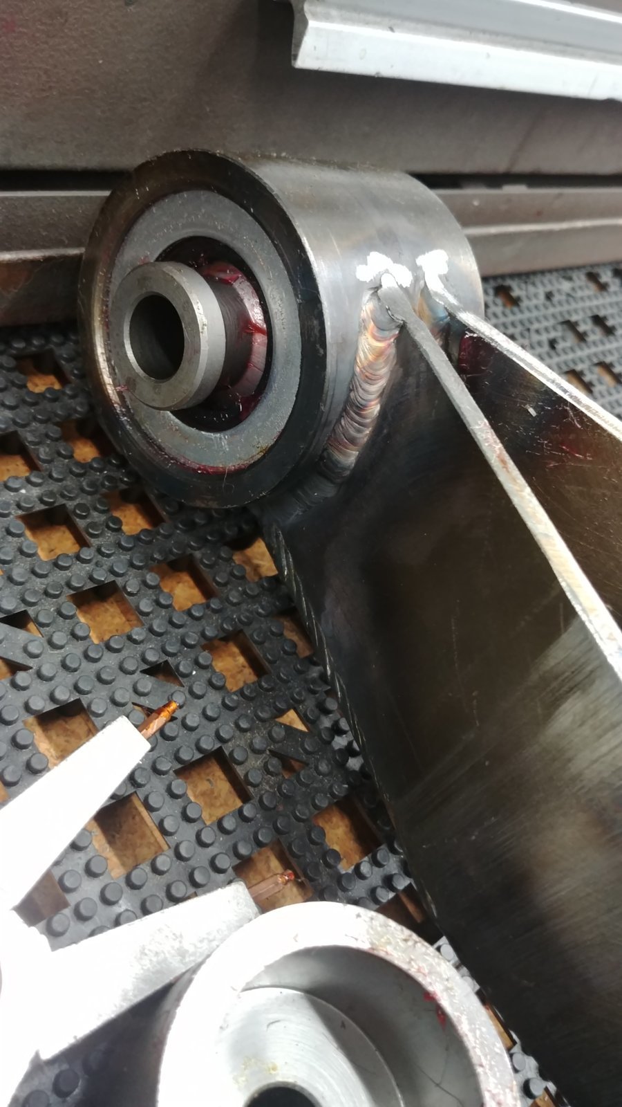

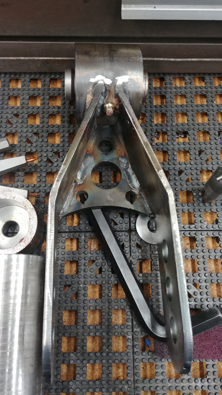

    You weld them to the frame side of the shackle. Here are mine. Had my buddy Adam G. Of Aggressive Fab (builds our cages and what not locally) TIG weld them and the shackles are MIG welded by Eddy when SOS was open and owned by him

    @tacobell007 that is the design I had in mind. Explained better than I, and better pic. I feel that would provide a stronger SHACKLE.
    The other design would be easier to make, and work well. Probably better for something where the springs are under the frame, etc
