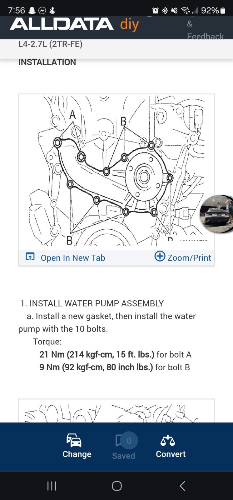

    They don’t need it. The RTV you see is from the timing cover when the engine was assembled.
    With that being said, it doesn’t hurt to put a little on each thread of all the bolts.
    I could look in the repair manual. What engine and year?

    Makes sense. 2010 2tr

    The repair manual makes no mention of RTV.

    Alright just didn't know since those 2 bolts had it on the threads. My manual and alldata didn't say anything about rtv either but didn't want a coolant leak from the bolts if they were in the water jacket

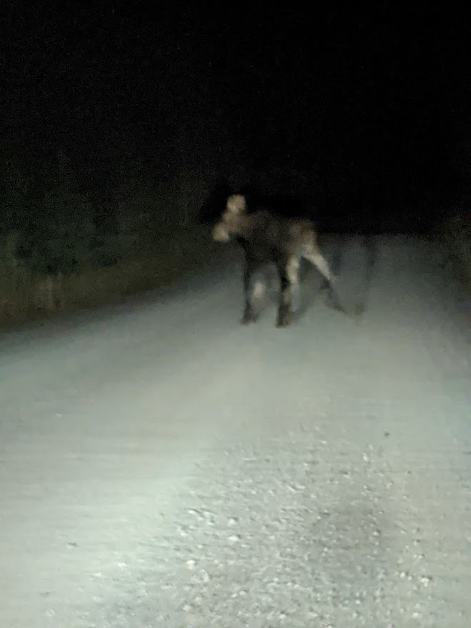

    Im starting to design my front bumper but I am not sure what I want to do for some long range spot lights. Anyone have any insight on this?
    Gotta spot these things when we send it up to NMW after work.

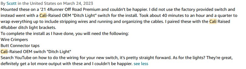

    edit - found this in a review, so maybe they fit?
    Edit again - can't read, that says ditch not fog. I ordered them along with a backup set of traditional cubes, so we'll see what happens. If they don't fit I will return them (Sorry Auxbeam :( ). I hope they fit though!
    Doing new ditch lights, too, one of the smaller sets. And amber from the off, so no covers to deal with.

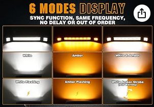

    Something I don't see on the site explicitly. It's two "different" light bars combined into one package, with two independent switches, correct? No switchback nonsense?
    You don't have to deal with this nonsense, if you want to go from amber back to white?
    I'm thinking about the hidden light bar and that's a 30". Would fit nicely.

    2 different switches and it comes with the harness anyway. . I have mine wired into my 8 gang switch. I can have white on, amber on, or both on. I can show you the next time I see you. I also have the Extreme 40" Single Row LED Light Bar (Combo - Spot and Flood) for my roof connected to my roof rack.

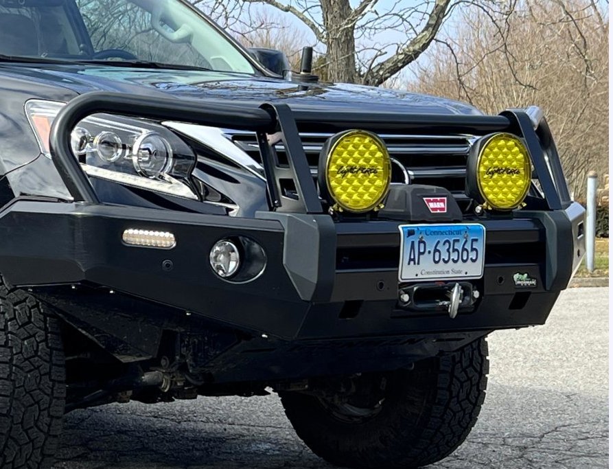

    Im thinkin about it. Im going to make a hybrid bumper kinda like c4's here (but with a crossmember chop and reinforcing the frame without extra brackets). Im not sure if I want to just toss a lightbar in there or do something a little more unusual.
    One idea is to do a pair of Rooo spotters on the front under a hoop like @Roody here.
