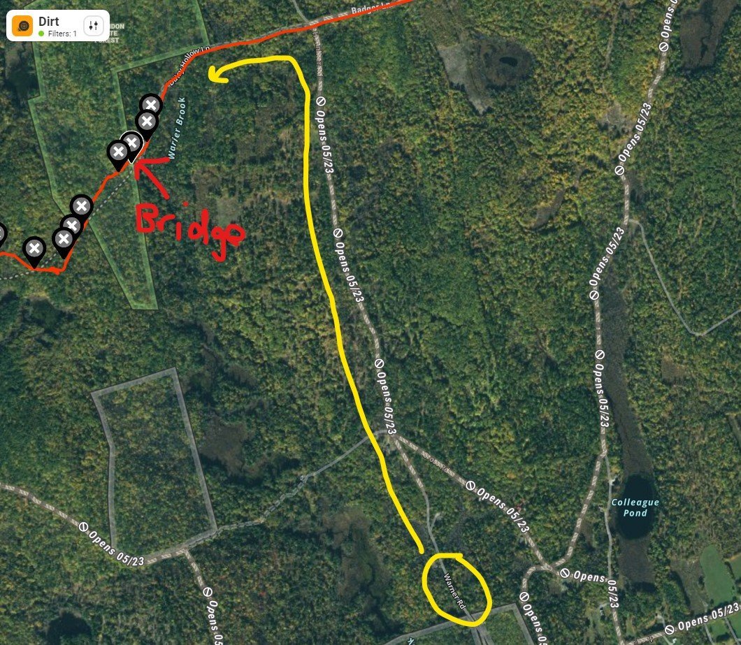

    In the pic of my OnX off road that I put up, with the 4 waypoints.......just as a reference, the first 2 before the bridge are called "suspension tester" and "The Slide"

    Southern NHIMG_2678.jpg going to do a drive by to be sure what we need and that it wasn’t already done.

    I am sure that no one has done anything to fix it up.....when we went through there, we needed to cut up 2 fallen trees in the section just to get through there.

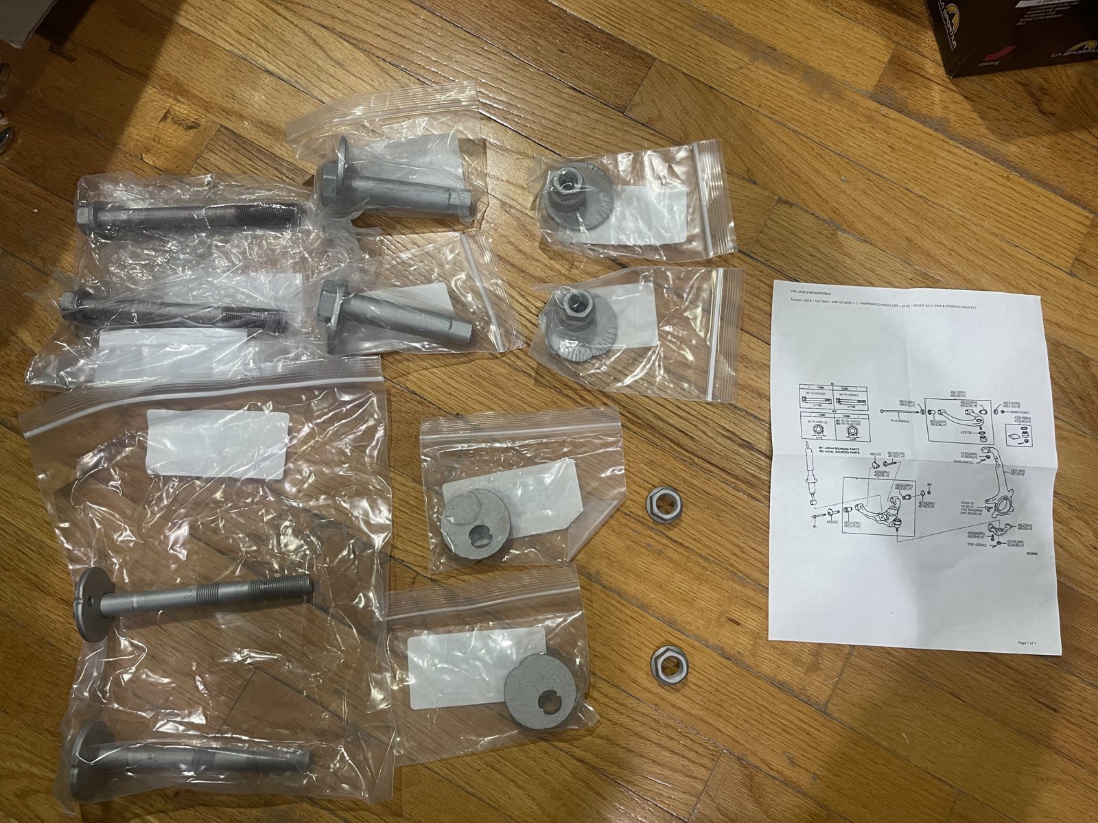

    Hey @crashngiggles does this seem like all the parts needed for LCAs?

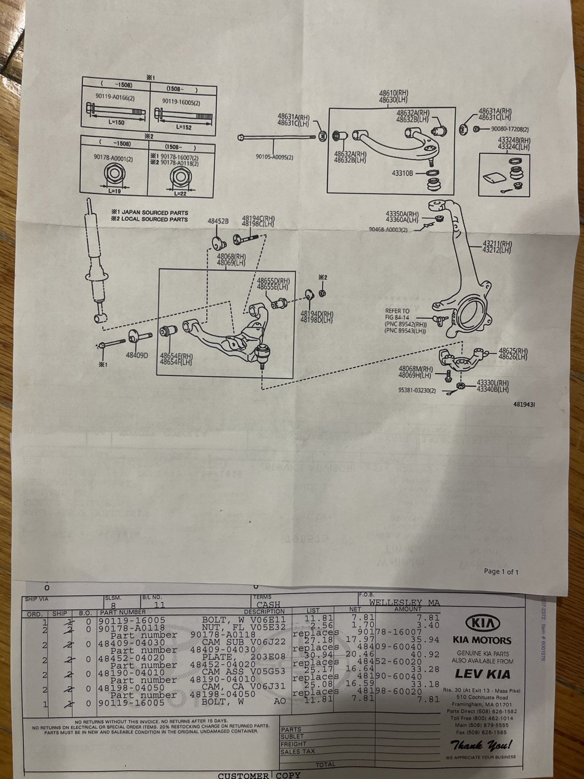

    The spec sheet shows different part numbers for left and right, but the parts guys ordered two of the left hand side stuff. Also the bolt numbers for the rear of the LCA don’t match anything on that sheet.

    Those do look correct.....did the "parts guy" go off of your Vin number? It does look like you have 2 full fronts and 2 full rears....what are the part numbers you have?

    Yeah he did. Here’s what I have:

    Yup, you have the correct numbers from what I am reading. We should be good to go. I'll remember to pack a shitload of antiseize lol.

    You're missing the lower control arms
