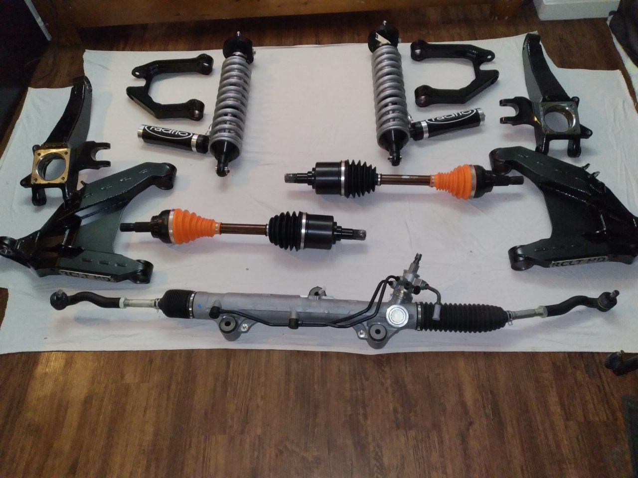

    Not much to see yet.. Cam tab gussets welded in, steering sector shaft extended, new steering rack is in. I need a new high pressure line and tap the rack threads (my fault). Need to put front diff back in, then its just bolt it all up, add new brake lines, bleed the brakes, refill fluids, weld in the limit straps and lastly an alignment. I think that's it. Still a fair amount of work but the harder stuff is done. And yes I will adress the paint when im done.
