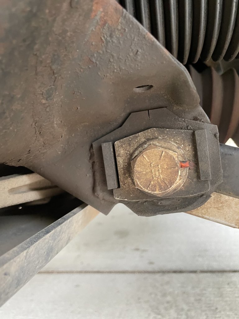

    Tacotabs have a lot of slop/ play within the can tab opening. Like more than 1/8” and it’s a common thing. Torque needs to be 250ft/lbs or they slip. If I was keeping I would add a bead or something to fill the void.IMG_3507.jpg Not my pic.. mines worse and flattened one of the tabs
    guess you can have first dibs
    fatfurious2[QUOTED] likes this.

    Yes the bison stop cams have more adjustment, but mine have slop too. I got mine for free, and they came with copper tubing to go inside the LCA. I also have TC cam tab reinforcements.
    Sorry about the quality of these pictures. But there is definitely slop. Maybe 1/8" ?

    I have KPO's and they fit really well. You can take a look sunday.
    We can also measure the opening and just make ones that actually fit. If you have your alignment dialed in you dont need the octogon

    So your complaint with the tabs having too much movement is between the cam and the tab right? Its not between the bolt and the bushing?
    If its the cam and tabs lets measure it Sunday and I can make you parts with whatever clearance you want.
  15. Nov 14, 2024 at 11:43 AM
    #8735
    AllTacosFloat
    AllTacosFloat [OP] If yours sank you’re entitled to compensation
    Nov 26, 2019
    #311742
    7,137
    John
    Boston ish
    Has lockers, a skewp and a bit of droop.
    Yes, cam and the tabs there’s a gap. The other ones can be returned but should be here Saturday.
    I’ll get there early to help set up whatever and we can talk options.
    At this point do we just weld the cams in place?

    I mean, welding them in place is an option but that is pretty irreversible if you ever want to change LCA alignment settings.
    If they are in and fit well enough for you then that's the easiest option.

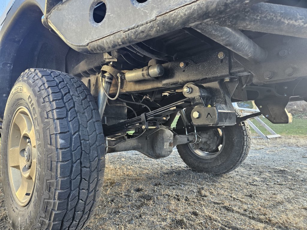

    Done and not an ounce of daylight to spare.
    My lower shock bolts were finger tight when I went to remove them :confused:
    Other than that, NBD, just troublesome to do alone as a skinny fucker.
