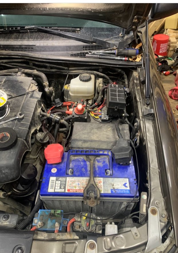

    I’ll check my battery, I have a backup in the garage that is ready to go.
    I’m assuming it has water damage. I’m going to rip it all out including the roof rack and light bar and try to get it all organized and start over with a new aux panel. Should have done that when I first got the truck.
    steering rack bushings? I have a stethoscope I can bring. We’ll find it
    starting over because your stuff is all pretty and mine is a potential fire hazard!:rofl:

    Nope. The clunk is from the passenger uni-ball and the squeak is from the driver uni-ball. I looked at it Tuesday after work.
    and the passenger side upper control arm bushing is shot

    Id imagine thats a sticky relay partially making contact. Auxbeam setup?

    Yep, it’s an off brand one because I don’t like logos… all sealed so I can’t do anything. Might do my own or go spendy with a switchpro.

    I like doing my own, relays dont last forever, id like to be able to replace them.
    Maybe a little messier but if any components go bad I can just replace 1 thing

    That’s exactly why I was thinking of doing my own. Sealed seemed like a good concept but it’s a pain right now.
