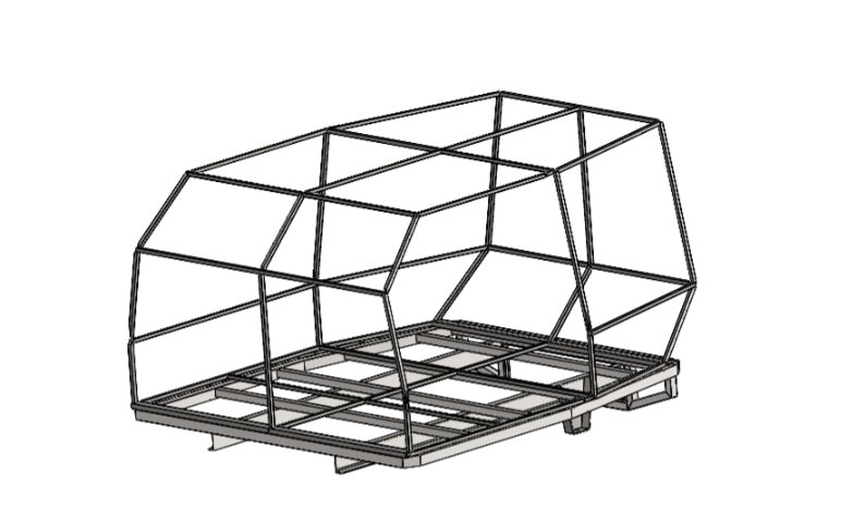

    Doood that looks rad, what's the est weight?

    I’ll get some weights tomorrow. It shouldn’t be too crazy though

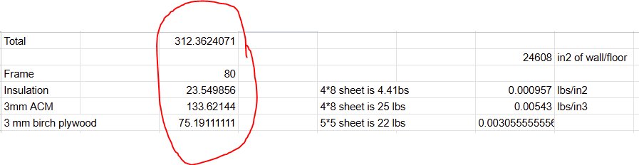

    Base flatbed including aluminum deck is 258 Lbs at the moment. Does not include the center drawer, side storage, fenders or headache rack.
    I'll need a hitch so add 40 lbs to that.
    Camper is comin in at 310 lbs but I need to strengthen the frame a bunch for all the junk I need to mount to the back and add like doors and windows.
    Its all very reasonable weights it seems. We will see when it actually comes all together

    I think the Tundra camper didn't have windows, it was a cave. I think they had a roof vent though. Might get some inspiration from them, I'm sure he has pictures laying around somewhere. If I remember correctly it was a full wood build though.
    Don't forget mounting hardware and brackets too, with weight concerns. That little stuff adds up quick.
