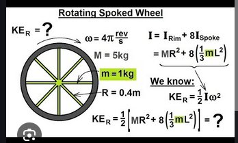

    There's a lot of math here, but the thing I want you to look at is the moment of inertia (the resistance to changing of movement, IE higher takes more gas to get going) uses the distance from the axis as an exponential (for both the wheel, and the spokes), and the mass as a linear relationship.
    You add some pounds, and it won't do much.
    Add an inch, and it's to the power of 2.
    So if you're really focused on the MPG and driveability, my opinion would be the smaller diameter 6 ply tires that will be more squishy on the rough roads, and take less gallons per mile with the smaller moment of inertia. The trade off is they're not as cool, and you're driving a brick on wheels anyway, they won't be some magic wand that gets you to 50 mpg. You might go up by 1.
    CTSpruceMica and Roody[QUOTED] like this.

    Man I wasn't expecting the math class haha. So it's not the mass that's the issue, it's how far away from the axle it is that causes the issue and is felt 2x? Either way, more mass = bad is the takeaway, whereas a tire that's 1" taller overall only nets 1/2" extra ground clearance

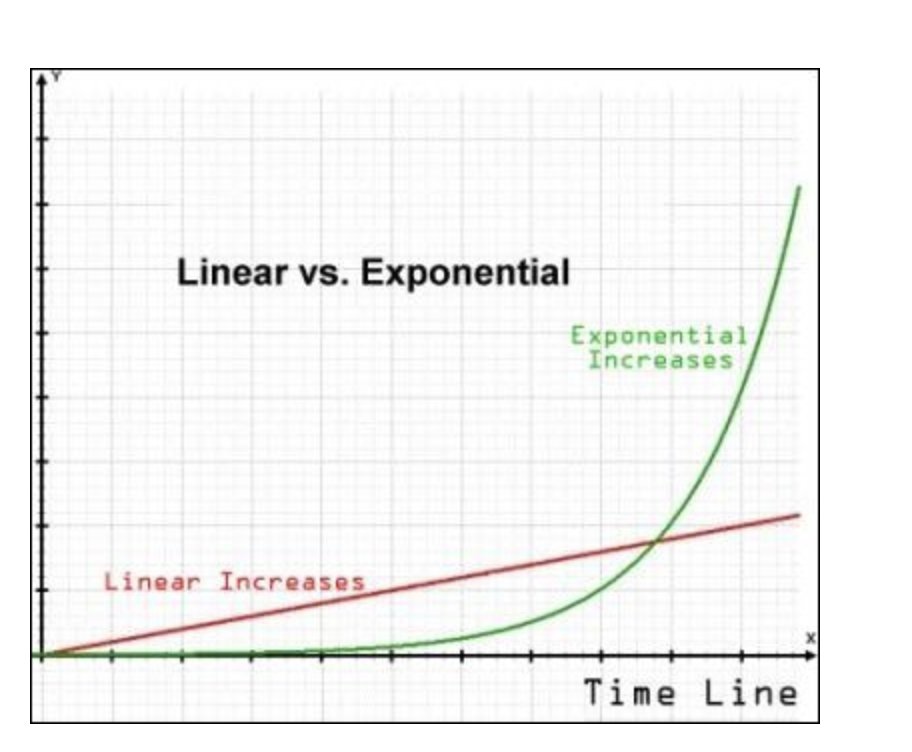

    :rofl: it's me, and I'm sober, you can expect math.
    It is felt to the power of 2. This chart is a random google result, so ignore that it's time and growth instead of mass/diameter and inertia.
    The distance is exponential, the mass is linear. Adding more mass does less than adding more size.
    To be fair I would actually need to run numbers and see what the situation is.

    Because I can
    So in short, the KO2 and the 255/80 are roughly the same mass. 52 vs 54 LBm, but the radius is different. The resistance to moving (what takes gas to get going from a stop) is 10% more in the KO2 though.

    You're a wizard. In my decades of being obsessed with tires and everything related to them, I've never seen this concept explained this way. Extremely helpful!
