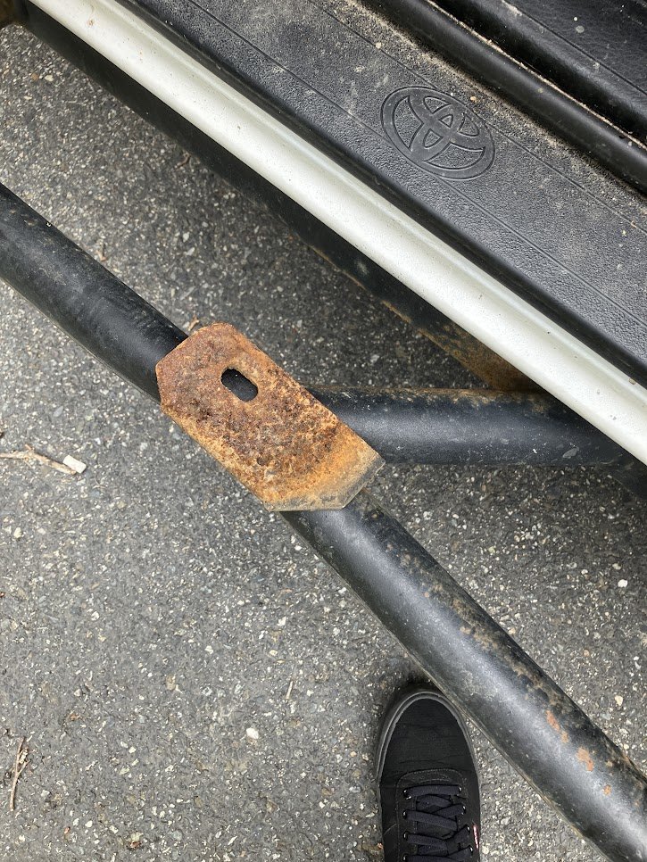

    Cheers thank you!
    3/16. Thing's beefy.
    I also may have spoken too early, it does look like there might be some tack welds, but no beads. So, non structural whatever it was, and unlikely from my truck. Probably going to ignore that it ever happened.

    Im going to start putting random pieces of steel under your truck

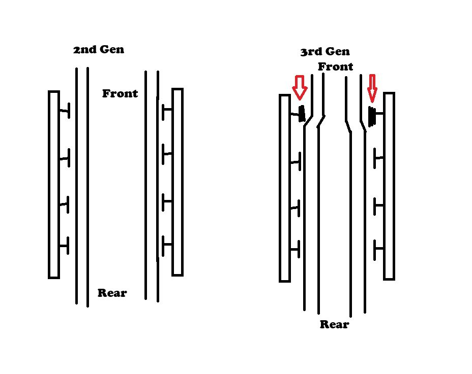

    Yes I have a second Gen, and I do have SOS sliders but I have installed SOS sliders as well as a number of other sliders on 3rd gens and the connection point is a little bit different on the 3rd gens than it is on the 2nd gens. There is supposed to be a spacer or plate that is to the front connection point because it needs to a little thicker due to the 3rd generation Tacomas having a slight "Dip In" In the angle of the frame. I'm going to see if I can attach a, and be it, horrible drawing that I'm going to whip up really quick in MS paint to show you what I mean. did it come from that front area? I apologize because in the picture it is very accentuated but not that much of an angle in real life on the frame like it is in the drawing. the Red Arrows are where it points the thicker mounting point in the front of the truck.

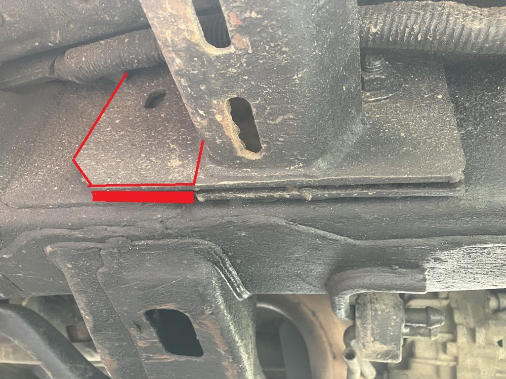

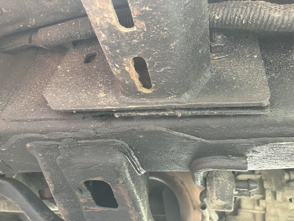

    Hmmmmm....
    I don't have the front bolts in, they're super gumbi to get to them.
    Now that I'm looking at it, the shape looks like it's a two piece backing plate behind there? Both sides look like this - where there's no "plate" behind that missing bolt.
    But the size, shape, and slot cutout looks way too conspicuous to be not from there.....

    Yep that does look like your phantom piece...... It looks like it would have been placed right behind the main plate on this side.

    I have to decide if I put that bolt in or not anyway. I need to drop these off for a clean and repsray I think.
    I'll also have to see if the other one is actually gone or not, might still be in there.
    Yessir! It looks like there's a gap between the two for clearance of something between them in there. Not sure without digging in, but I was just rolling around to see if I could take pictures under there, not grabbing the whole shebang.

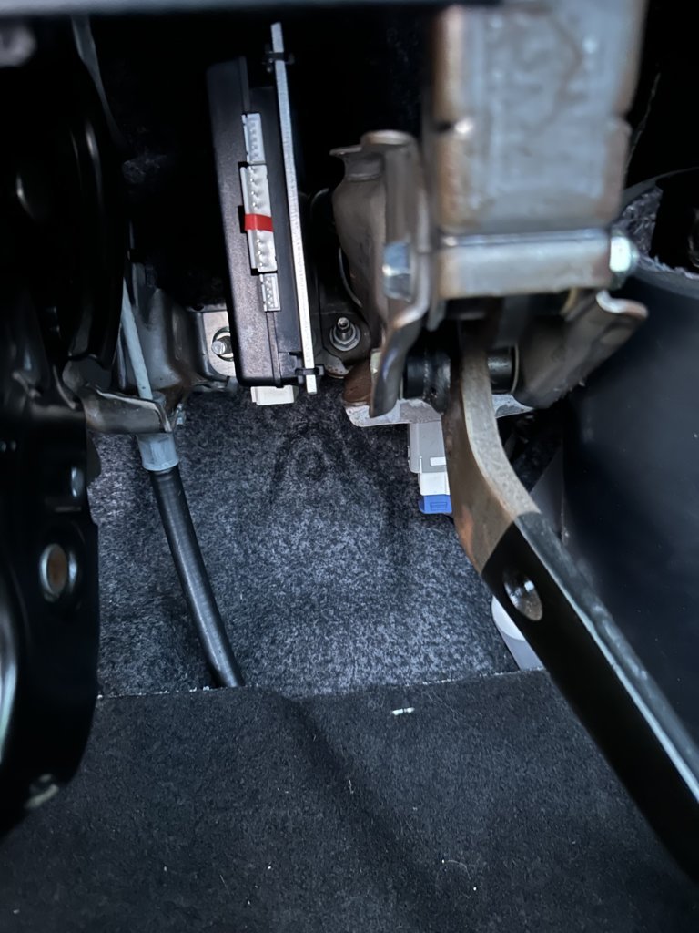

    Remote start module mounted securely.

    Yes it did. Thanks again. Had to mount it before wiring it.
    Used double sided tape on the back of the module plus three zip ties to hold the module to the panel.
