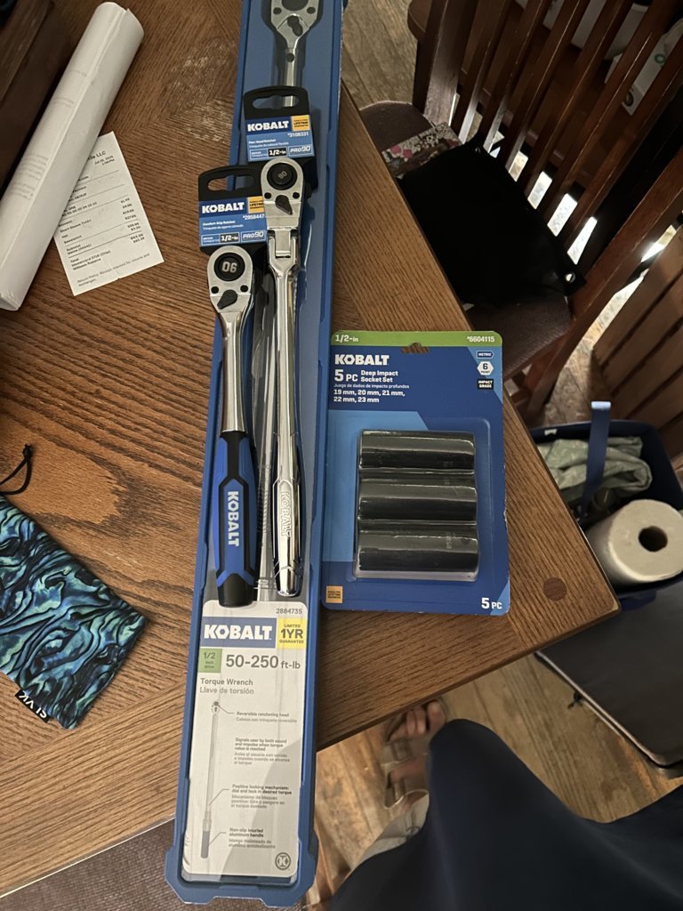

  16. Jul 29, 2025 at 2:36 PM
    InCogNeatOh Parts
    InCogNeatOh Parts Well-Known Member
    Aug 16, 2023
    #431373
    557
    Too Fing hot today, left the runner at work and went shopping instead.
    Kolbalted up, I think I got the sizes covered. I am a little concerned that I got deep sockets, but it was the best way to get all the sizes I thought I needed.
  17. Jul 29, 2025 at 4:56 PM
    super_white
    super_white Well-Known Member
    Feb 6, 2012
    #72230
    8,612
    Harry
    Connecticut
    2012 Tacoma 4X4
    Good assortment of sizes but you're right, always try to use a shallow socket on whatever you're doing.
