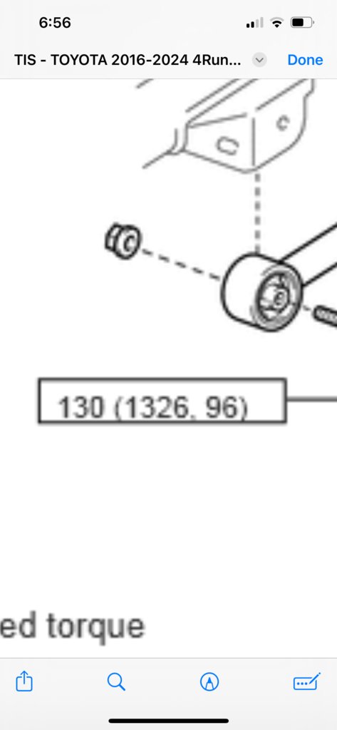

    Possibly torqued when the suspension wasn't fully settled and the bushing wore prematurely?
    Here's the torque specs should you need them:

    Thanks for the specs, what number should I use?
    130(1326, 96)

    The last one. 96. Those are foot pounds.

    They were at 96 at least.

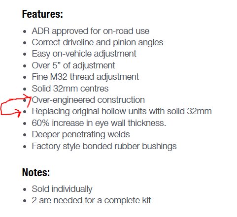

    Those ironman lcas annoy me. I dont know if they teach engineering there.
  14. Jul 31, 2025 at 4:51 AM
    InCogNeatOh Parts
    InCogNeatOh Parts Well-Known Member
    Aug 16, 2023
    #431373
    571
    Why do they annoy you? If I need to replace, what would you suggest?
  15. Jul 31, 2025 at 4:58 AM
    TacoTuesday603
    TacoTuesday603 I welded it helded
    May 3, 2021
    #364592
    3,409
    Jack
    New Hampshire
    2011 OR DCFB
    Fox and Locked suspension 63's Skinny 33's
    Its not a trailing arm, trailing arm is when you mount the shock on the link to get some motion ratio.
    1.25" solid bar is not how you make a strong part. A greater diameter tube with enough wall thickness to not dent would be up to 2x the strength at the same weight. Like Not-A-Ross used the typical 2" OD 1/4" wall dom. There's this basic concept called moment of inertia.
    I will look into it a little more, with how little lift you have I dont think you need adjustable ones but I am not as familiar with the platform.
