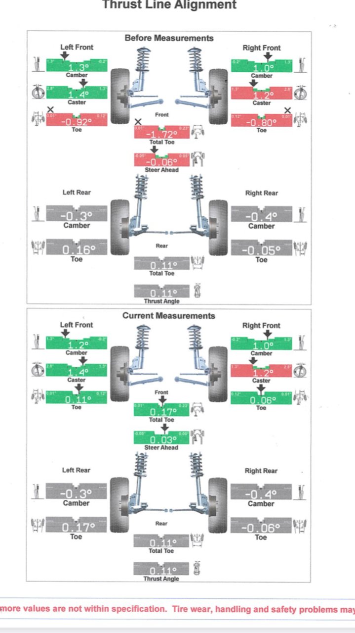

    Would you guys be ok with these numbers?
    They told me my tie rods were limiting the toe adjustment. I need to adjust my spc ball joint angle in order for them to improve the caster and camber, but I dont really want to pay for another alignment right now; or do tie rods.. at least not right now.

    My dumb ass looked at the first one and was like "Eh if that's the best they can do, I wouldn't be happy with the toe, but otherwise it'd be okay - chalk test would be a thing"
    Then saw that was the before :rofl:
    I'd say chalk test it and if it's good enough, then it's good enough!

    As long as you are not rubbing anywhere with your tires, I would be ok with these numbers. How are your tabs doing?

    Caster seems low. Should be about 3.5? How does it drive and do you rub?

    No rub. I went to the max position on the spcs to give the most clearance, but went a tad too far I guess. Before I was the complete opposite (a position on the spc chart) and definitely rubbed a bunch doing sucker pond. Thats why I pushed it the other way, albeit too much.
