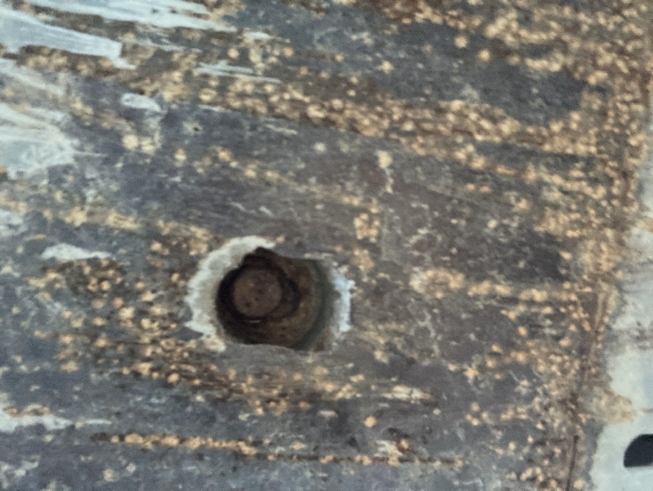

    welp. That throws a wrench in my maintenance plans. I have a higher chance of finding Atlantis than I do getting this out. Spinning freely and going nowhere. Of course it was the last of 6 bolts too. Skids not coming off. I think I can do atf but can't do center or front diff with it on. That's going to be a spring time issue. I might ask for help getting that bolt down. I was able to lower the skid a smidge and MIGHT be able to get a sawzall blade back there but I'd rather have the skid and the as is diff and ATF than no skid for the winter while I figure out wtf to do to fix it. Hopefully just the bolt is F'd and the threads on the frame are in good shape. But either way that's spring time Rob's issue and I'm not risking f'ing with it now when I have to get to NC in two weeks vs the alternative. If the weather is still warm enough when I get back I might take a whack before the winter but most likely that'll be a spring time Rob's issue.
    Edit @jpereira2
    Good news is with the bumper, the fronts still pretty easy to access without dropping the skid. Bad news is - that bitch ain't coming off before WW :(
