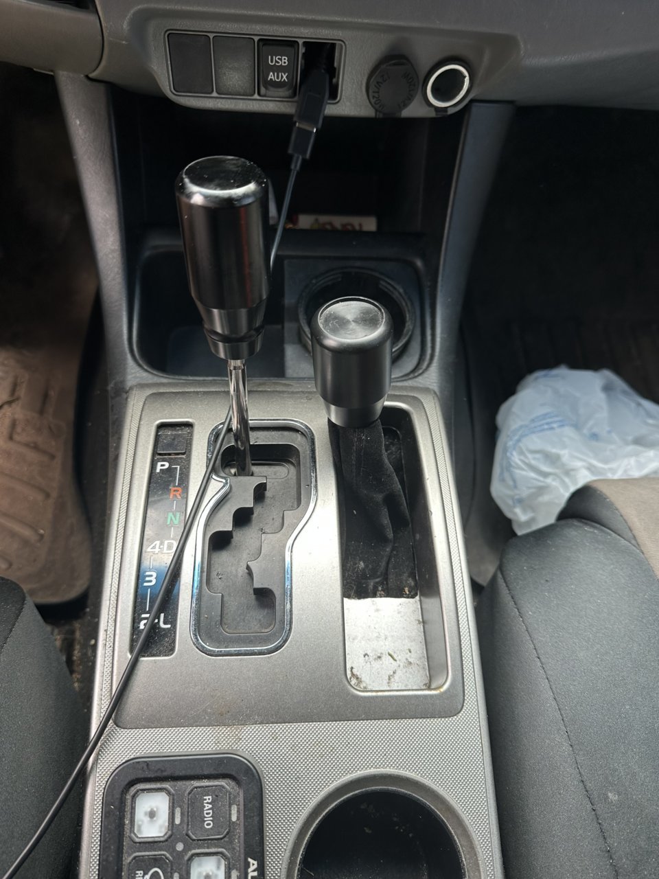

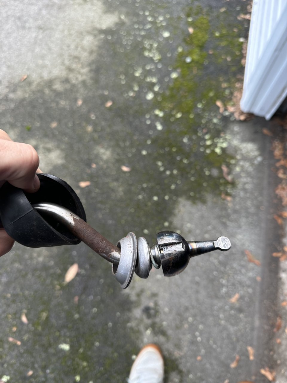

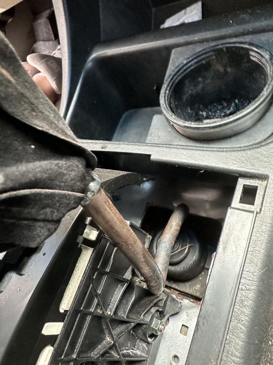

    this is what the bottom of the lever looks like(you’ll need to reuse it). I just cut it low and welded a 1/2 rod on it. I also was lazy and didn’t want to thread the rod so I cut the other end of the shifter off and had that welded on for the knob lol. Worked out cause it holds the shift boot up. IMG_2601.jpgIMG_2602.jpg IMG_2603.jpg
    I also did the tube swap. 4WD ecu is completely disconnected in my turd

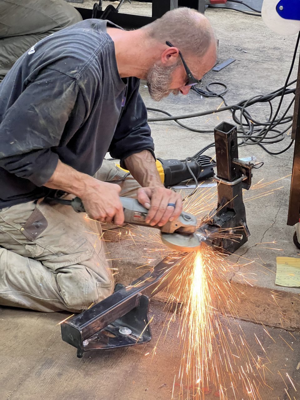

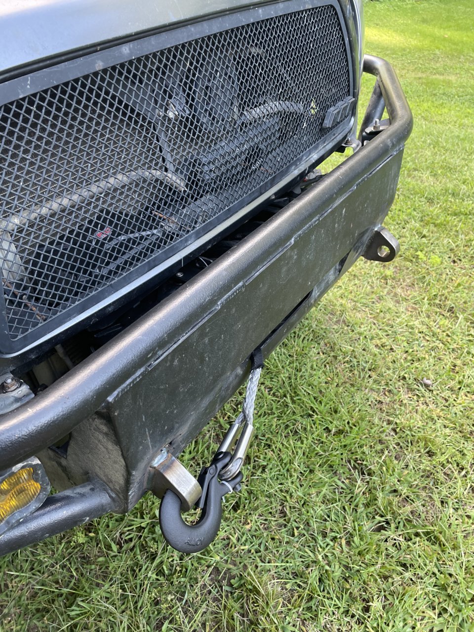

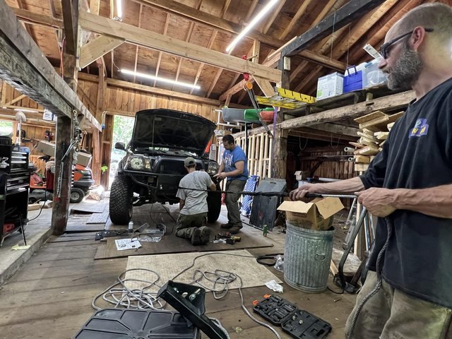

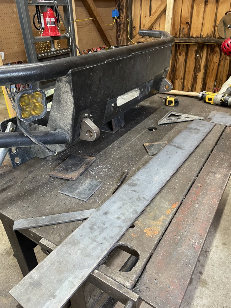

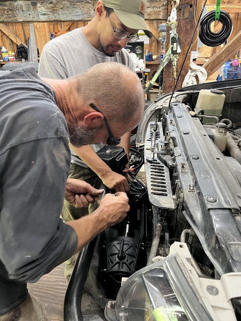

    Mod day with @TacoTuesday603 was great as usual! Always great to work with Jack, he does what you’re looking for then makes it extra beefy.
    Matt and I both needed recovery points on our fronts and I finally got my winch on:bananadance:
    thanks James for taking pics! Mr. and Mrs Parts made an appearance, hope you guys had a nice lunch!
