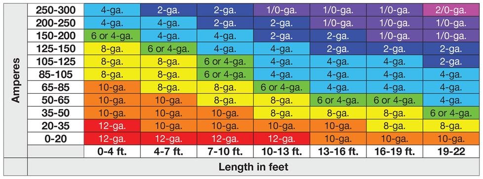

    Hey another electrical question - running from the battery to the back seat, to power a 45L fridge, and a second set of USB ports for charging phones/speakers/etc through a 12V panel.
    10AWG good for this? Or should I step up to 8?
    I'm going to run to the bed, too, that will 100% be using 8.
    Fridge:
    Rated input current (DC), [A]
    5.2 A at 12V DC, 2.6A at 24V DC

    I’d just get one roll of 8 and call it a day. Save cash by getting the bigger roll too

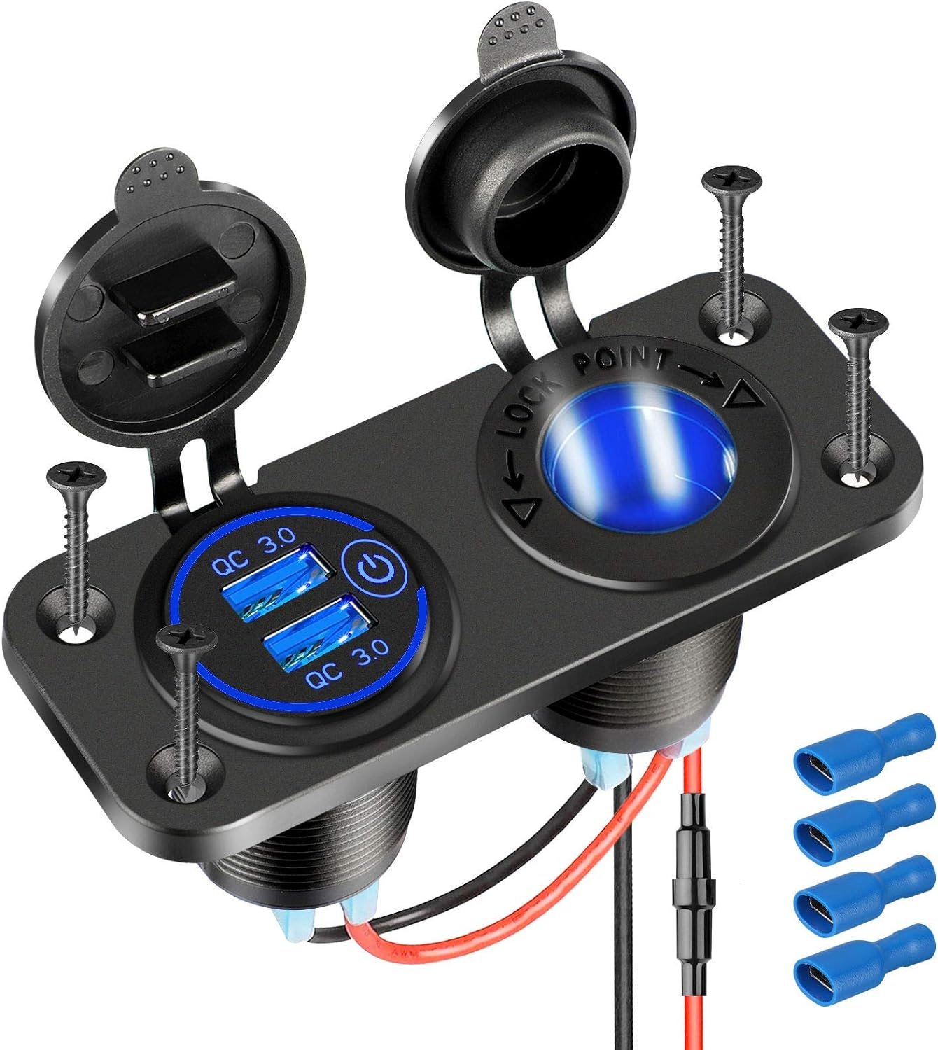

    Found this which i kinda like the idea of.
    https://a.co/d/dowtKK9
    Good call and i think that'll be my plan. Fridge will be on 8 i think. Lights can drop way down to like 12 or 14. Radio might need 12 though so maybe that'll be it across the board.

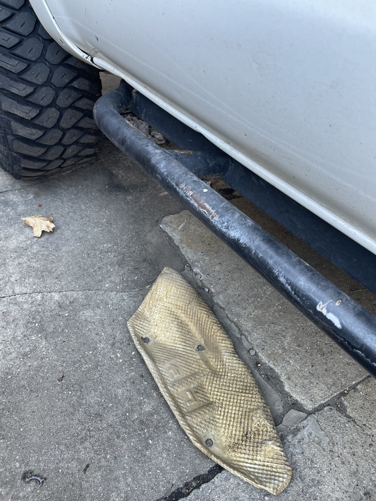

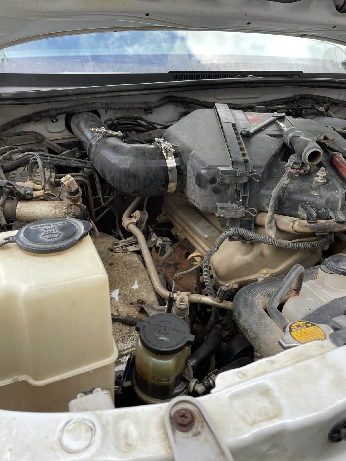

    Did the anti rattle mid and cowl intake on the last few days.IMG_1979.jpg IMG_2008.jpg

    How do I get the mud out of my vents:rofl:

    Pull the dash. :eek:
    It what I had to do to remove the dog hair that was in my truck when I bought it.

    :eek::eek::eek:
    I guess it’s staying until I have a better reason for pulling the dash!!
    I don’t mind that much

    DEEP water...
    But, that'll create more problems than you want to solve...:D

    Long ass Q tips… lots of em. Lol

    I’m going to wipe it down with a Q tip and vacuum it up and out with some small tubing attached to the shop vac.
    Happened turning around and driving thru a puddle that didn’t look deep but the mud sure was! With I could have scene it from outside the truck!
