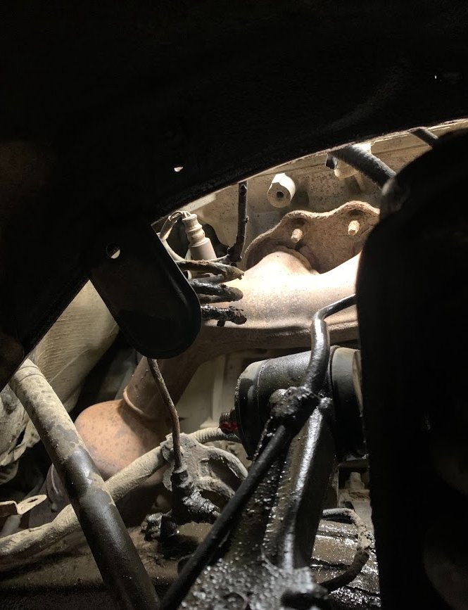

    It was one of the front twirly lines.
    Going to replace all the front hard lines as soon as I figure out what to buy
    Brake fluid everywhere

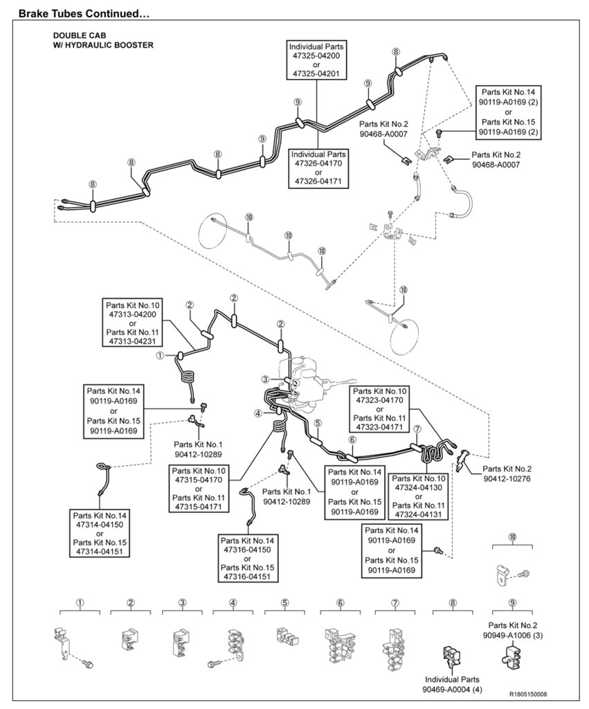

    Anybody got a diagram for the front hard lines? Maybe @super_white

    Does this help?

    Very helpful, thank you

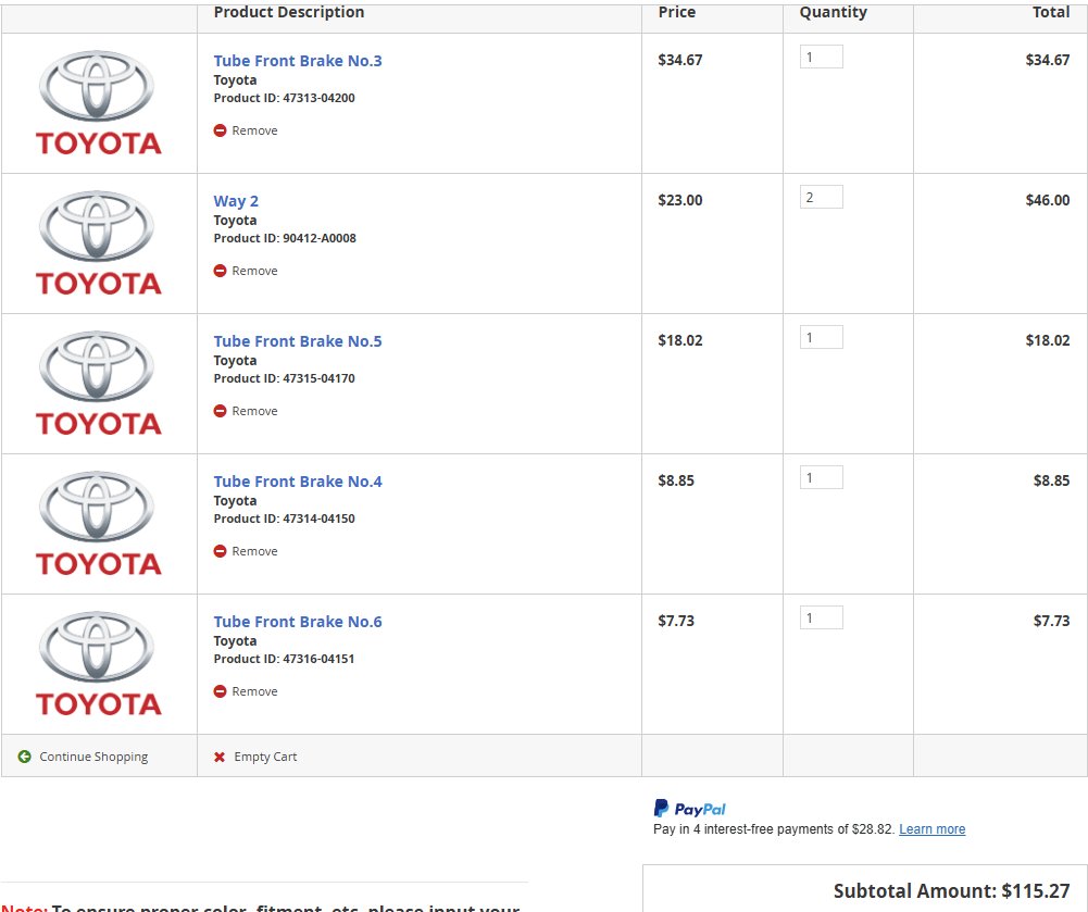

    Its a little weird for me to say this but I'm just looking for a bolt on affair. The brakes are not what I need to be screwing with right now.

    They arent too horrible surprisingly.

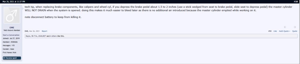

    @super_white good advise below or bad? I will be disconnecting both front lines from the master

    That is what I do if I need to open up the brake system, it works well!

    I've never had to use that procedure. If I replace a caliper or wheel cylinder, I pinch off the flexible line. If I replace a component (master cylinder, ABS actuator, etc.), I bleed the brakes normally using my vacuum bleeder. I usually let each corner gravity bleed for a couple seconds before using the vacuum bleeder. But that depends on what I fixed.
    What line/lines are you replacing?

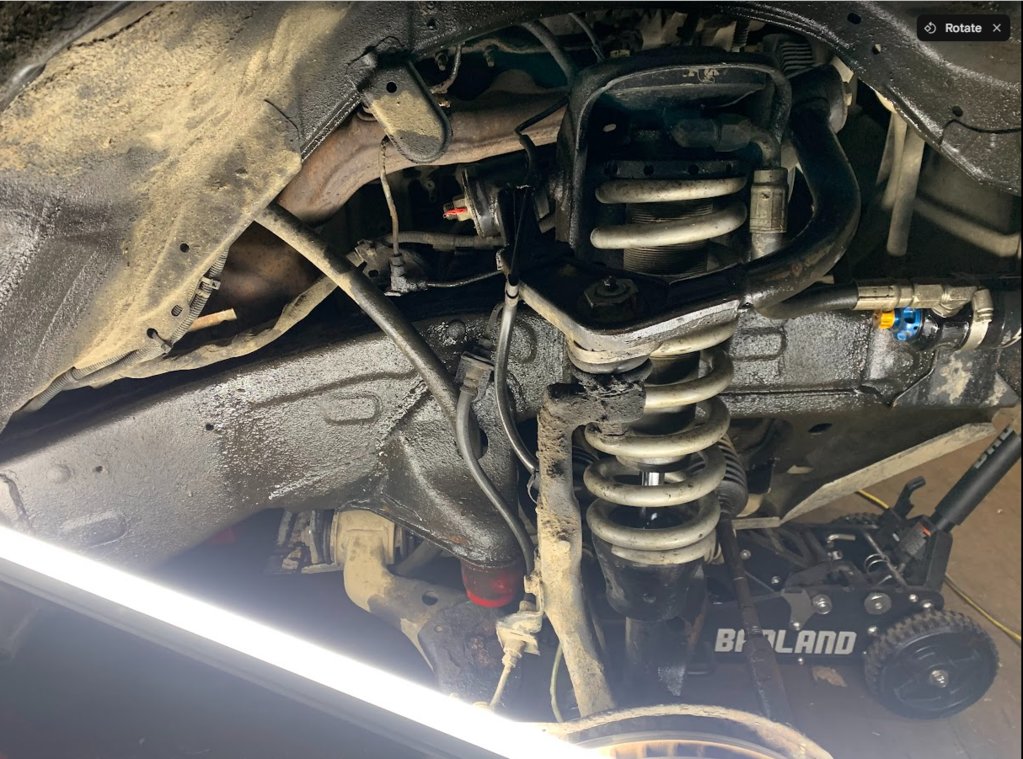

    All the front lines. From master/abs thing to caliper

    If your just doing lines then a regular brake bleed will work. You can use a small rubber plug to keep fluid spill to a minimum. https://www.amazon.com/110PCS-Silic...sprefix=rubber+brake+line+plug,aps,115&sr=8-1
    One thing. Protect your paint, brake fluid loves to eat paint. If you do spill some, do not wipe it, pour water on it.

    Theres a non-zero chance it's why my bedside looks the way it does, not fully sure when it could have happened but I have an idea.
