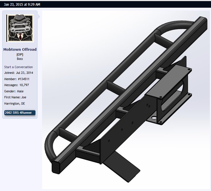

    You're more motivated then I am. Its not that hard but I always end up doing it in a driveway in the cold.
    I just worry about corrosion between the slider plate and the frame plate.
    Making them bolt ons does not seem like an easy task. Mobtown tried and came up with this. Unsupported leg on the back aint great. He wanted 100% bolt on no hole drilling so We probably could put a support back there.

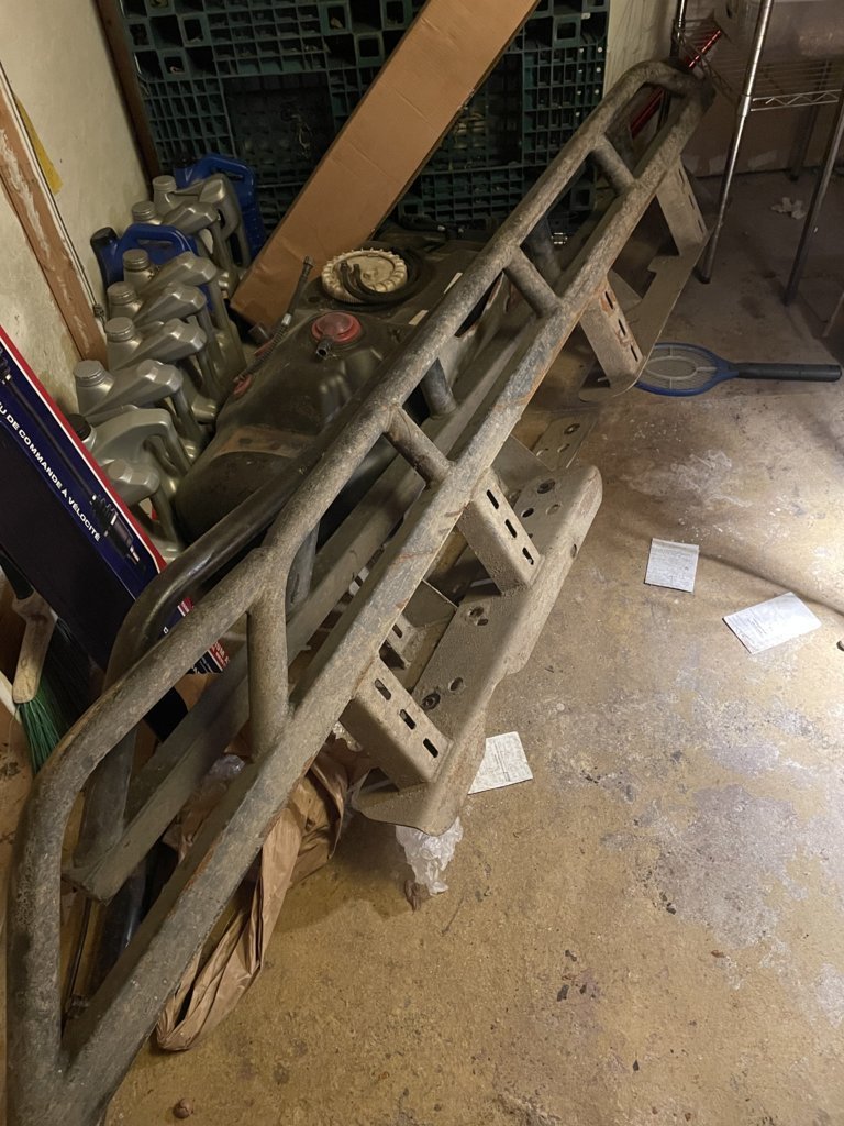

    Fair concern. There was nothing when I took them down the first time, but I took them down after about 6 months at the end of 2020. They stayed off through the winter, I put them back up after the spring road trip in 2021. So they've been on since then, they'll be coming off in spring of '25, so a 4 year window. We'll see what it looks like under there.
    I say that, but....There's every chance it doesn't happen :rofl:
    Throw up some newspaper on the doors, wire brush the rust to a solid 75%, hit it with primer and rattle can bed liner on the truck, and off we go!
    I have the SOS ones with the upward facing goop collectors. This is the picture from John's thread, I knew I'd seen them recently! The material connecting the slider to the plates is an upward facing V. They collect a ton of dirt and muck. They take a pounding ( :p ) BUT they get gummed up. That's part of wanting to take them off is doing a good clean, make sure there's no real rust forming anywhere. If there is, patch it up now before it becomes a problem.
    Oh that was a joke for drilling holes into Harry's frame. Making them into bolt on would be chaos. For 300$ and a couple skilled welders within beer-shot, I would highly recommend weld on in that case :D
