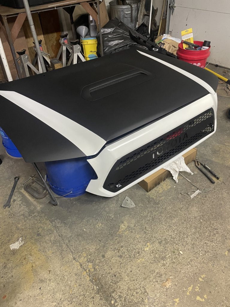

    Been working some crazy midshift hours and lots of ot but been plugging away at the 2.5 conversion. Not sure if the white stripes will stay as the whole thing is getting a new white paint job soon. Glare on white sucks and flat black is free…
    Officially have all the parts ready and painted. Hood and grill came pre fucked, matches the rest of the truck perfectly.
    Maybe I’ll get them on this week pending life.IMG_3673.jpgbad mockup but the lines do match up nice with the grill.

    Looks good, trd panda edition

    That is going to look awesome!!!

    Can't wait to see this on the truck

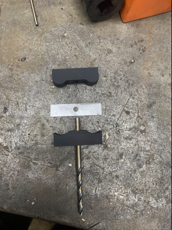

    Everyone that does anything need a 3d printer. Exploded a clip that holds the lines for the heater core.
    5 minutes of design time and 20 minutes of print time makes a small die set.
    Little vise action

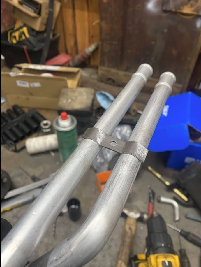

    Fits perfect first shot

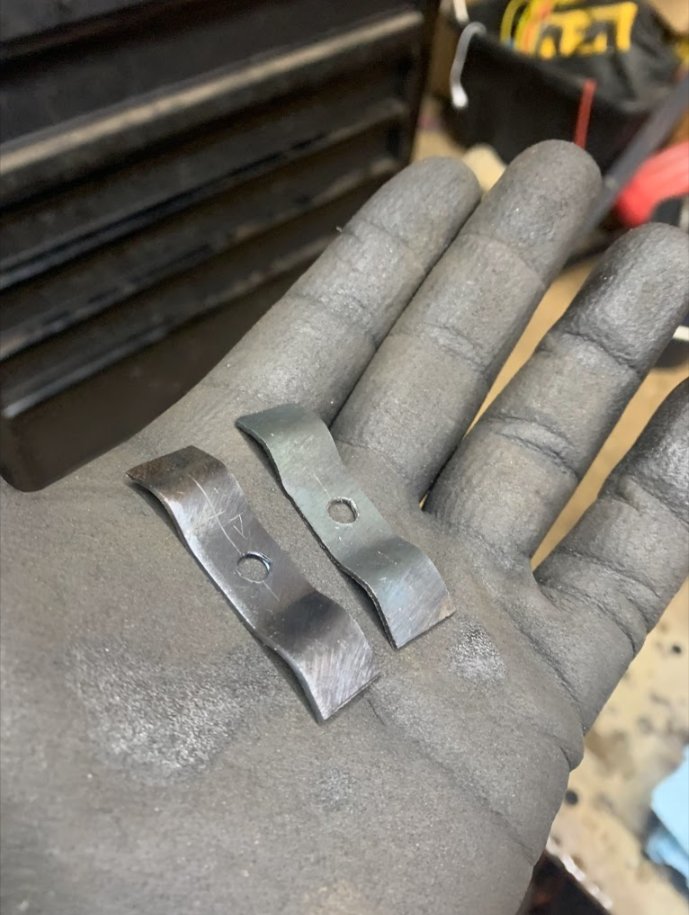

    A little redneck hot bluing, heating up to 400F then quench in wd 40. This adds some corrosion protection and is easy when its 20 deg in the shop.
