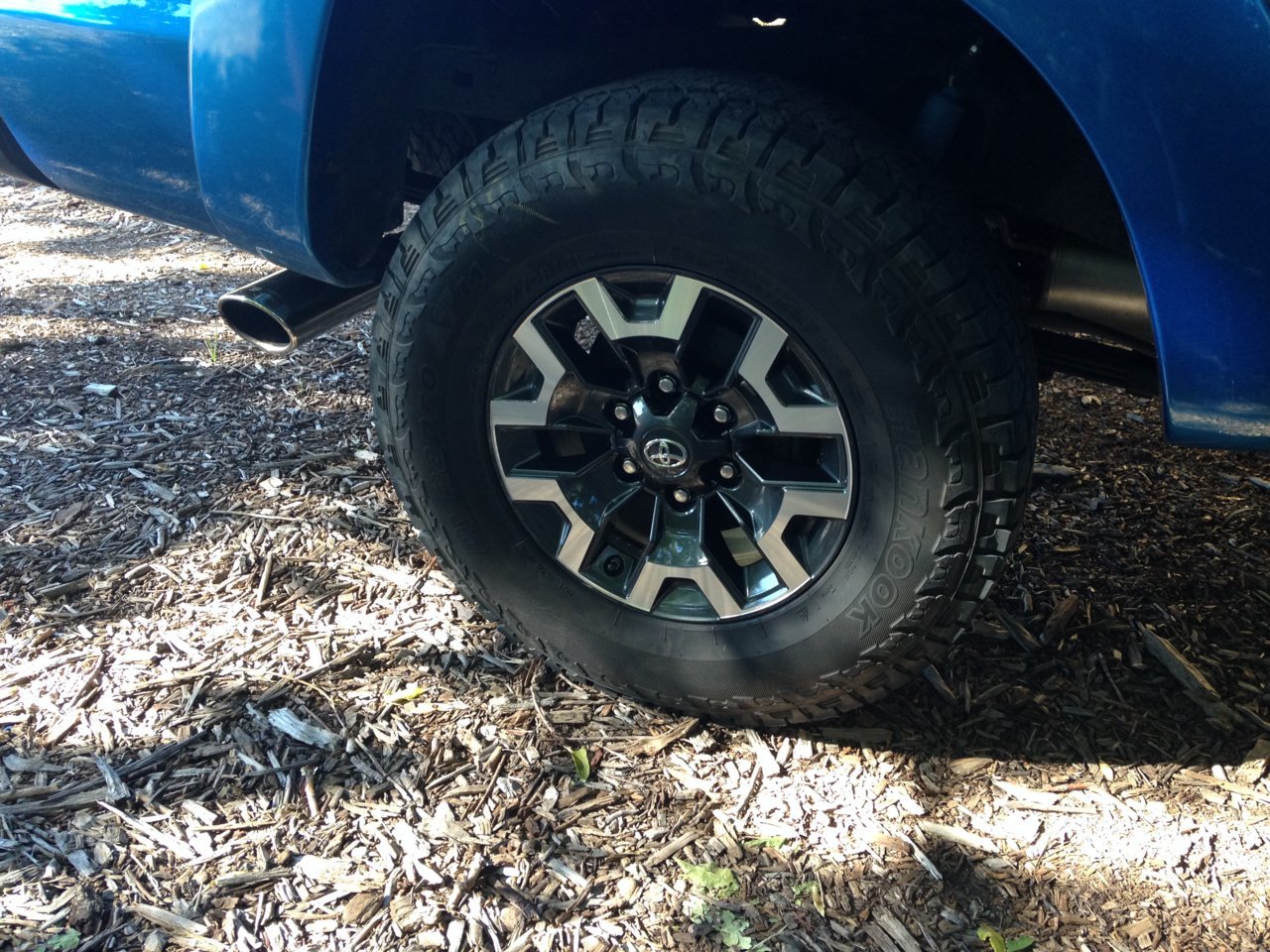

    I know it is pricey but the TRD cat back exhaust is top quality, fits perfectly and has a great tone without droning. Shown here on my ‘10. See you on Weston Pass on 11/17.F924D584-9161-4AAB-A0EF-15B9AE7BA9B1.jpg
