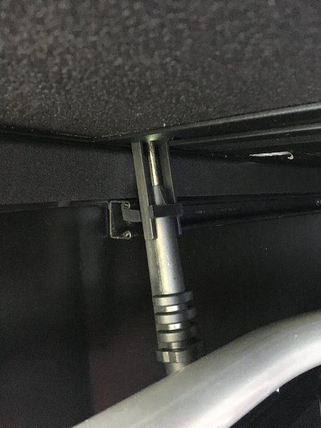

    That's what I do so you can't pull it up-

    Just tighten the 10mm nut in the base of the handle... that will tighten the rear pull down thingy's.... don't tighten too much... you could deform the cover...!!
