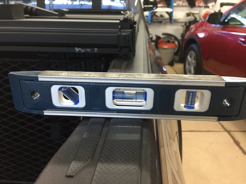

    The other thing to check is how level the side caps are. maybe 2nd gens tilt outward a bit for water to run off? 3rds gens are dead flat.

    wouldn't that depend on how level the truck is parked?

    Yeah. But a few degrees outward slope would make a huge difference, unless you are parking on a lot of hills. I dunno, just wanted and excuse to go play around the truck. :)

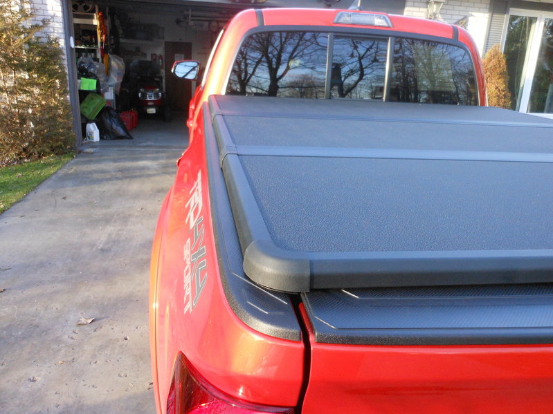

    I saw the gap you are referring to and filled it with a few pieces of "peel-n-stick" foam weather stripping before installing the cover...
    Here are coupla pics... No rain yet... They do say DO NOT overtighten as you may distort the cover.... In a pic from someone else, I noticed that his seemed to by higher at the front and rear... He may have overtightened and distorted it.. be careful, I guess.

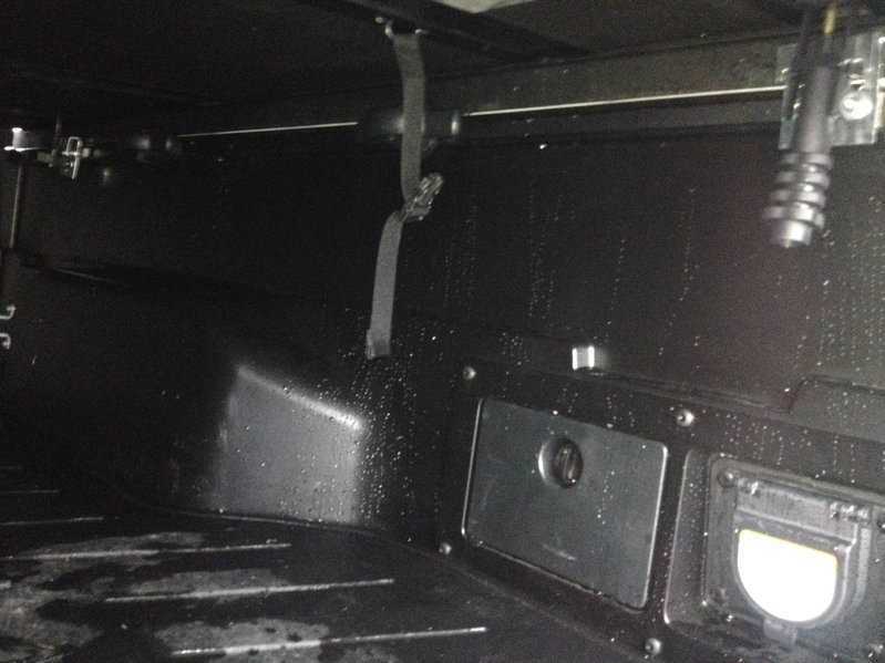

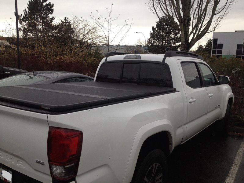

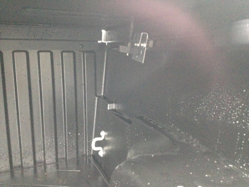

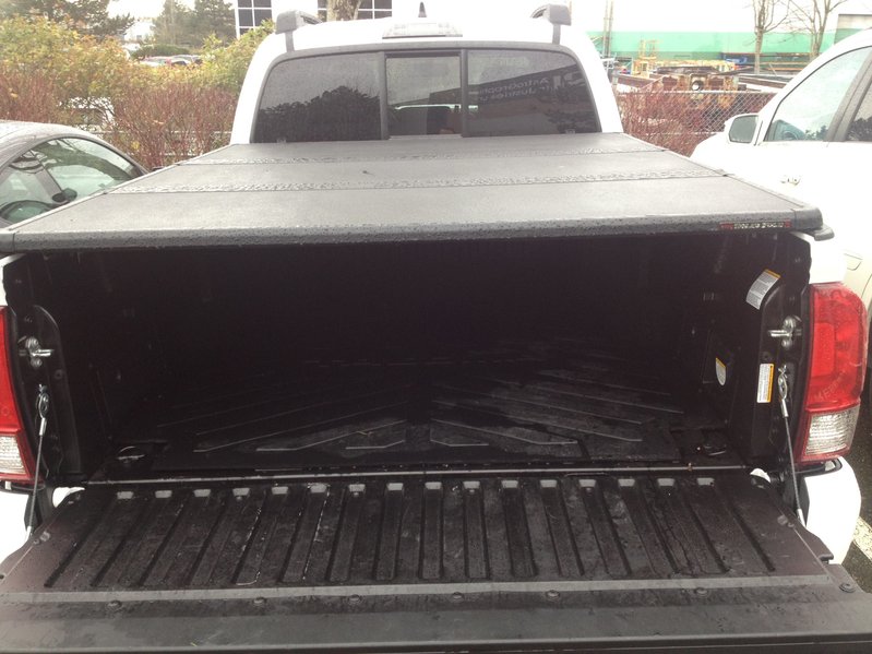

    Ok, just went outside at the office as it's finally stopped raining for a bit. There is water in the bed, not as much as anticipated. As you can see near the rear the bed mat itself is pretty dry and is likely still damp from the rain yesterday when I didn't have the cover on. The most noticeable water is near the front of the bed where the gaps are, once the water gets in there is can travel along the bed-rail and drip everywhere. This is my theory anyways as the seal looks great everywhere else!
    I'm going to play with a couple options to try and fill these gaps, like @over60 I think I'll put some weather stripping in there. I'm also going to explore the use of a conformable vinyl to completely cover the top rail and gap, put it right under where the cover sits. I want to prevent water from entering this area as much as possible.
    I also adjusted the tension on the clips and will see what works better, it was a little loose so I tightened them a bit more for a better grab.
    IMG_3295.jpg IMG_3290.jpg IMG_3291.jpg IMG_3292.jpg IMG_3293.jpg IMG_3294.jpg
