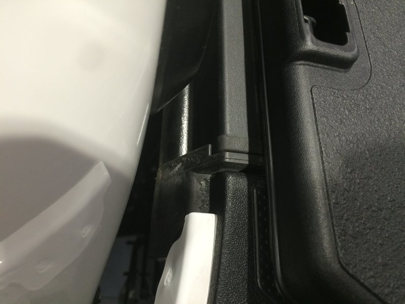

    image.jpg image.jpg I installed the Extang 2 hard cover and took my 15 through the car wash. It is leaking through the two gaps in the bed on the can side. While at the dealer today I checked another 16 with the factory tonneau cover and it had rubber plugs in the gaps. I fornthebpaet numbers from parts but they couldn't order them because they are not available. Can anyone else get these two parts?

    It is watertight except for the two gaps in the bed rail that is closest to the can. I have a few other posts in the part numbers needed for the runner inserts to plug the two gaps. Dealer cannot get the two parts yet but they come on the Taco's with factory tonneau. 62541-0410 & 62542-0410

    I'm going to get some rubber door window molding to fill the gap. I also have a rubber seal behind the cab and a tail gate seal that goes up the sides and bottom mine seems to be dry car wash and rain
