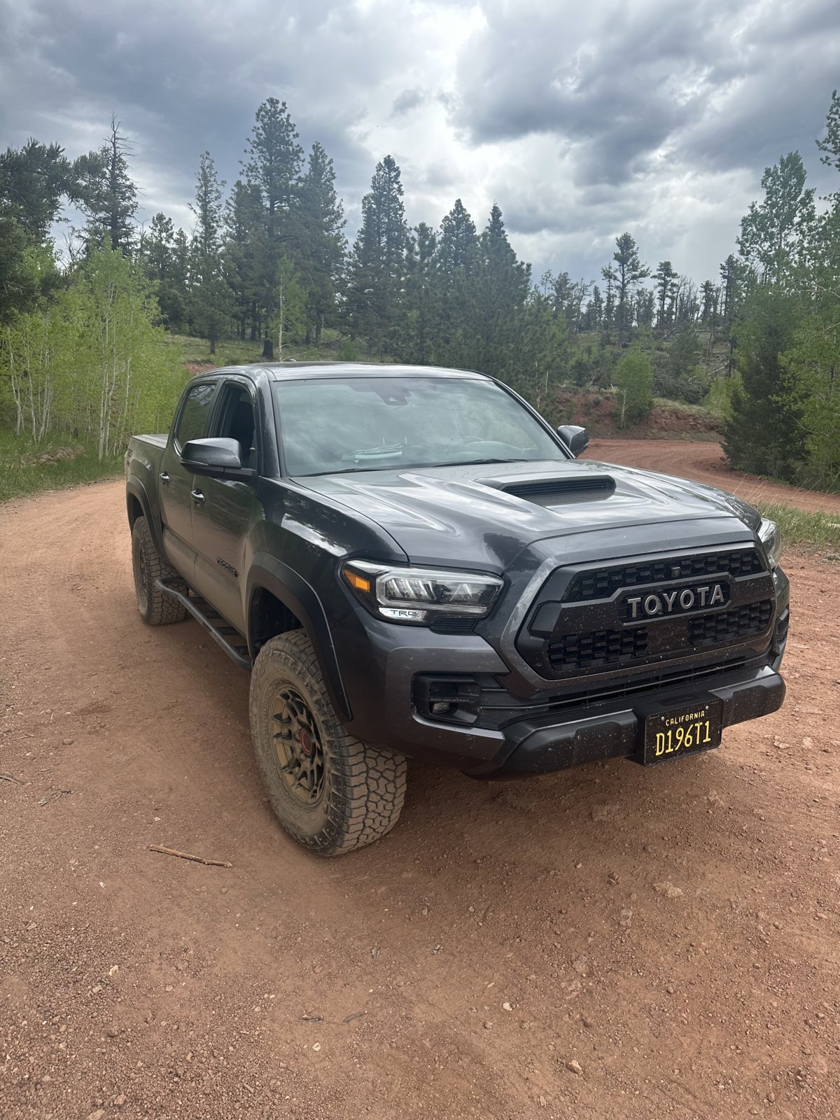

    No not E. I guess they are SL 116T. I specifically did not want E rated. That is why I did not go BFG. I had the AT3W on my old GMC Sierra and they worked great in the snowy mountains.

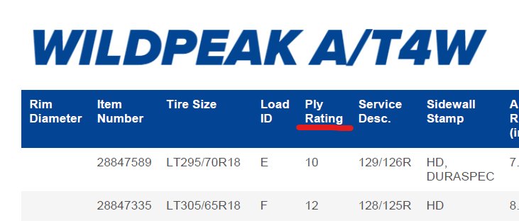

    It should be noted that the load rating is not an indication of # of plies. The "Ply rating" doesn't even correspond to an actual number of plies. An E tire does not necessarily have more plies than a C or SL. In fact, most of the time companies don't actually report how many plies are used in their tires so it's not even info we have access to. When you think about it, this makes sense. In our modern world there are SO many different types of materials and designs. You can imagine a scenario where a VERY durable tire is made with a low number of very durable plies. And another scenario where a very weak tire is made from a multitude of very weak plies. More plies does not necessarily mean stronger because all plies are not equal.
    I think it has more to do with sidewall stiffness and overall sidewall/carcass design. Usually high load rated tires require very high pressure in order to handle that load. You'll notice that the LT tires are normally rated for ~80psi but if you look at these SL and C load Falkens they are only rated for 50psi. If you look thru the specs you'll notice there are definitely tires with tall sidewalls (large aspect ratio) that still have high max load ratings.

    Ran into that with the Cooper AT3 XLT's I was looking at too. It's nice that Falken reports the ply number directly (10 in this case). Rubber/tire technology has come so far. I was quite surprised how smooth the 123/120S AT4w's I got ride despite the ~3400lb load rating. They're cooking up some real good tires there at Falken HQ.

    Only hit rain one time so far in Colorado, but my wife was driving. She never mentioned anything, so I assume good. They are brand new though and have full tread.
    In Central Ca, we don’t get much rain. I was more interested in the three peak snow rating. We spend a lot of time in Lake Tahoe in the winter.

    Take another look at that spec sheet from Falken. You'll notice they don't provide the ply "count" and instead, it's a ply "rating". Those are not the same thing.
    Read thru all their materials more and you'll see that the "Duraspec" sidewall that comes on some of the AT4W sizes is actually a 3-ply construction. However, those same tires have Ply Ratings anywhere between 6-12 depending on the specific size you're looking at. As you can see, Ply Rating does not indicate # of plies used.

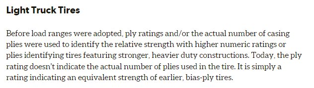

    For some historical context and an explanation of what Ply Rating actually means, here's an except from Tirerack (see link below for full context):
    https://www.tirerack.com/upgrade-garage/what-are-load-ranges-ply-ratings

    (I not you)

    Yeah, it's easy to do. Especially because 99% of what you read online is people equating rating and count while also saying anything but E rated are going to be fragile glass tires you'll shred on the first tiny rock you find. I don't doubt that it used to be much simpler to generalize like that but I think with newer tire tech and all the neat stuff companies like Falken are doing that you simply can't use these specs as a stand in for durability.
