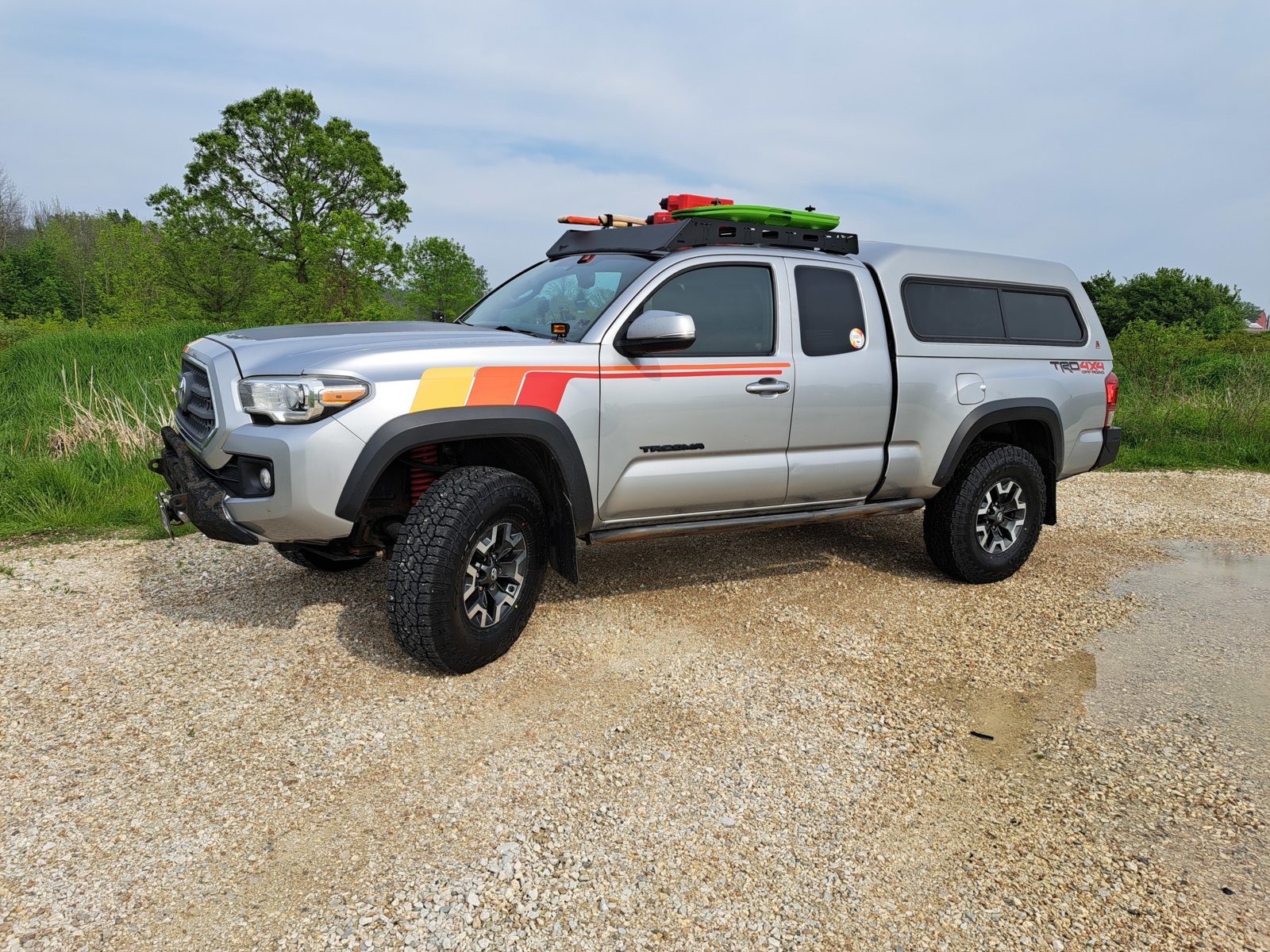

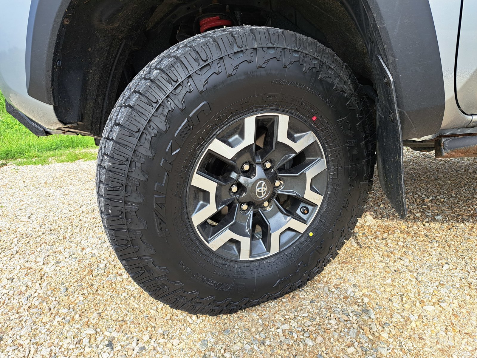

    Thanks for sharing! I've been looking at this option for my next tires, and this definitely helps. Can you share a picture of your truck with the 255/85/16s? I've been looking at getting that size as well. Thanks!

    Thanks! Nice truck! What size lift to you have?

    Thanks, I'm running about 2 1/2 (maybe a touch less). The rear springs are shot, add-a-leaf is the only thing keeping it somewhat level at this point... probably put the new ones in tomorrow, Ironman 4x4 Heavy load (440#).

    I'm looking at the same tire. Any rubbing? Not just driving on flat ground but while articulating.

    On either side, at about 3/4 to lock, I will get a real minor rub. I am running RekGen mudflaps and have 1" spacers. If I pulled the spacers, I could probably eliminate the rub, or I could likely have the alignment shop make a minor adjustment. I did take a heat gun to the inner fender liner, which did help a little.
