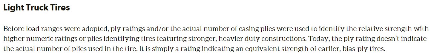

    Sorry to break it to you, but you're the one who's wrong here. Those ply numbers you're seeing are "ply ratings" not actual number of plies.
    https://www.tirerack.com/upgrade-garage/what-are-load-ranges-ply-ratings
    Falken's Duraspec sidewall is a 3 ply sidewall yet you'll find this sidewall on C and E rated tires. My C rated Wildpeaks only have 3 actual plies but they have a "ply rating" of 6. Technology has basically made the number of plies irrelevant. Because now you can use fewer, stronger plies to achieve the same load rating and durability as you used to get by using more, less advanced plies.
