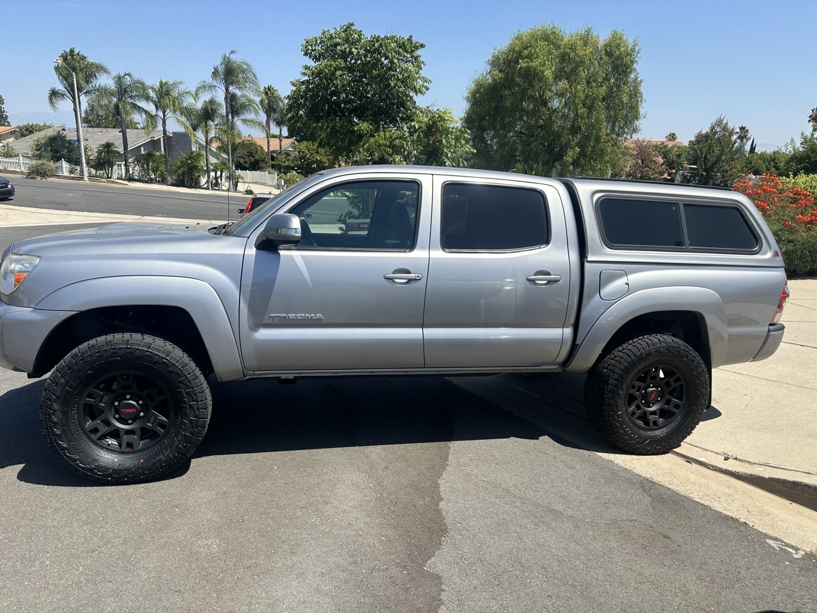

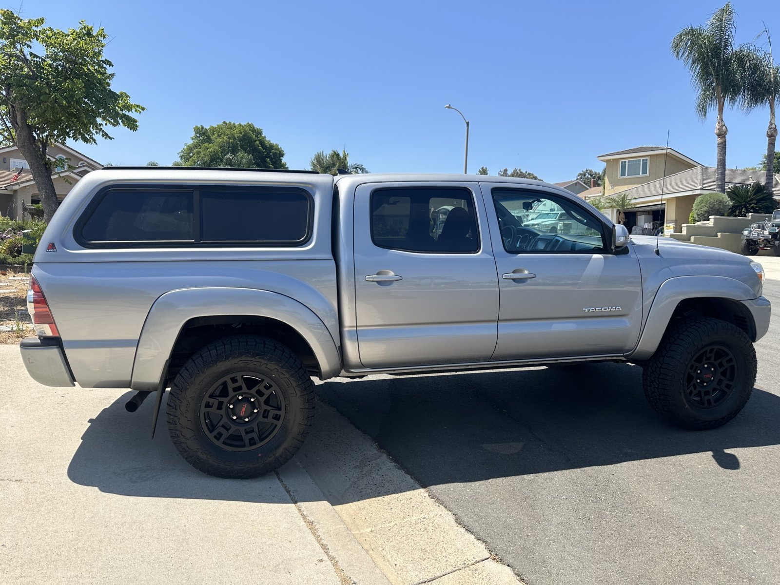

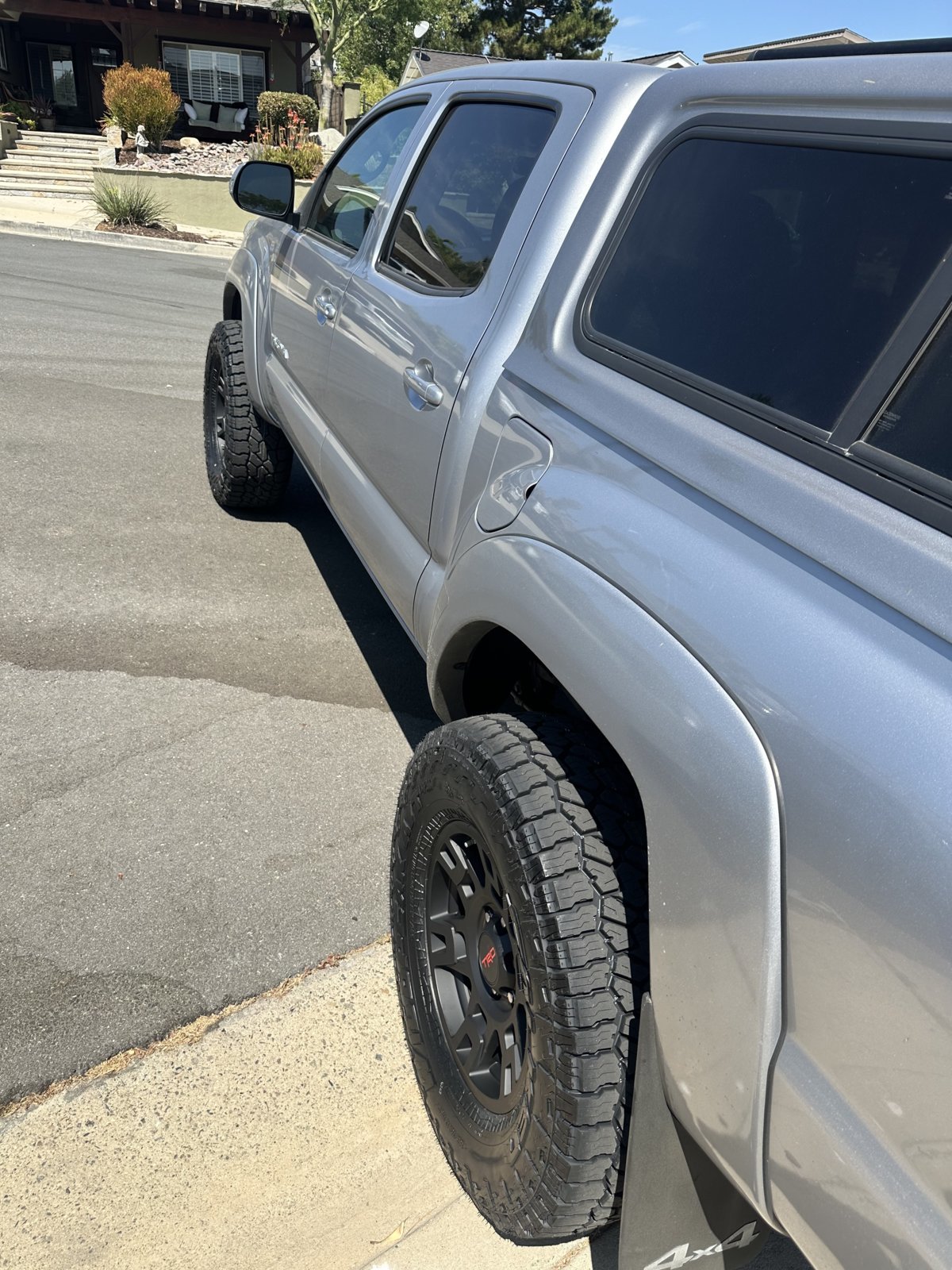

    Got the 255/85R16 put on today. Had to remove my front mud flaps and still very slightly rubbing on bit of the fender liner. Going in for an alignment in a couple days then will assess things from there. Pretty smooth though from my short ride home. Coming from a 265/75 Ridge Grappler.

    Looks great!! I’ve been so close to pulling the trigger on a set of 255s recently but I have a strong pull to the 265/75 e rated falkens as well. Plus I’m debating with myself on where to prioritize my next purchase. I have a Diamondback SE sitting in my cart begging me to finish the checkout :annoyed:

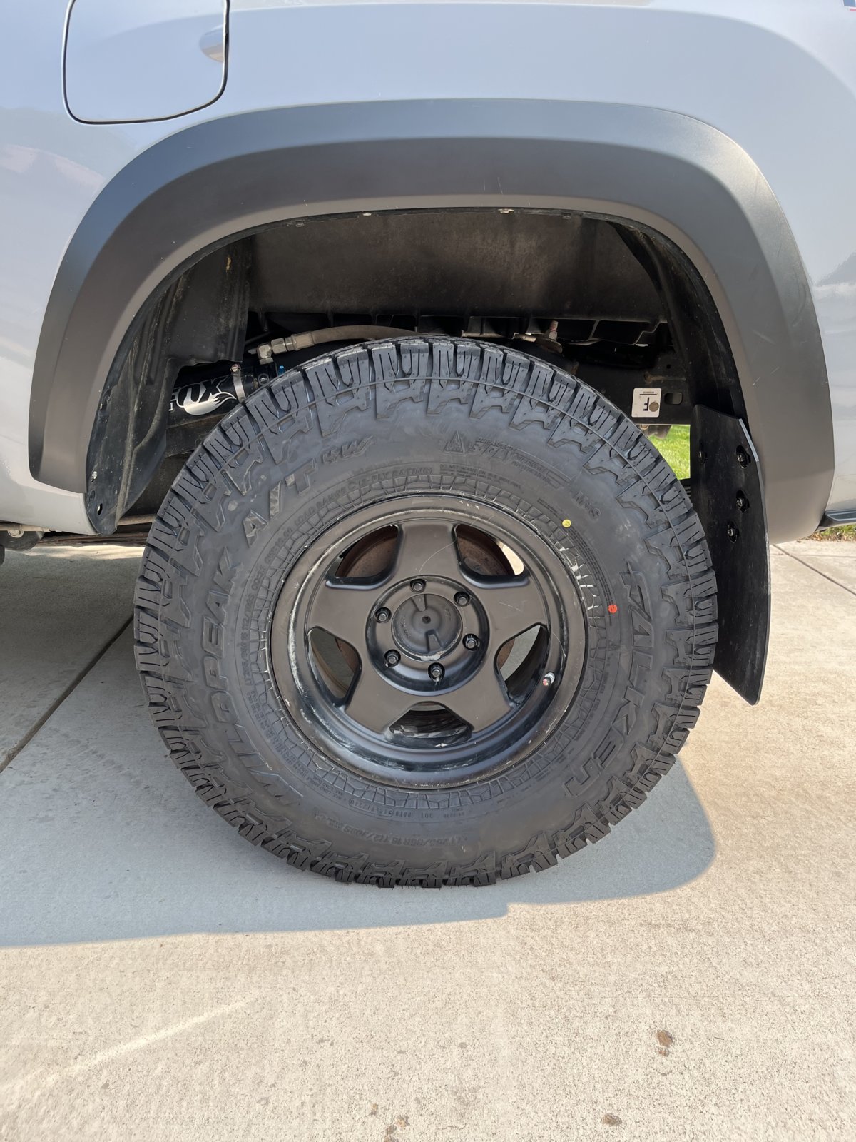

    Added some at4w e rated 285 70 17 so far so good (been running the at3w on my last 10 rigs or so

    Lookin good! What are the specs on your wheels and lift? I've been looking at making the jump to 255s as well.

    The wheels are SCS F5 4.5 backspace, 0 offset
    Suspension is Fox 2.5 w/ adjustable reservoirs all around, Dirt King UCA's, Icon RXT leafs

    Thanks for the feedback. I'm running the same wheel specs. Would you say you're running around 2" up front? Please let me know what the results are after alignment. Seriously considering doing the same. Thanks!

    Yeah, about 2" up front and in the rear. But the alignment will determine how well these fit and if I need to cut/trim.

    This looks great and has convinced me, after much internal debate, that 255/85R16 is the way to go. Gotta ask, what sliders are you running there? I like how tucked up in there they are as well. Thanks!

    They are RCI sliders with the 20 degree angle.
