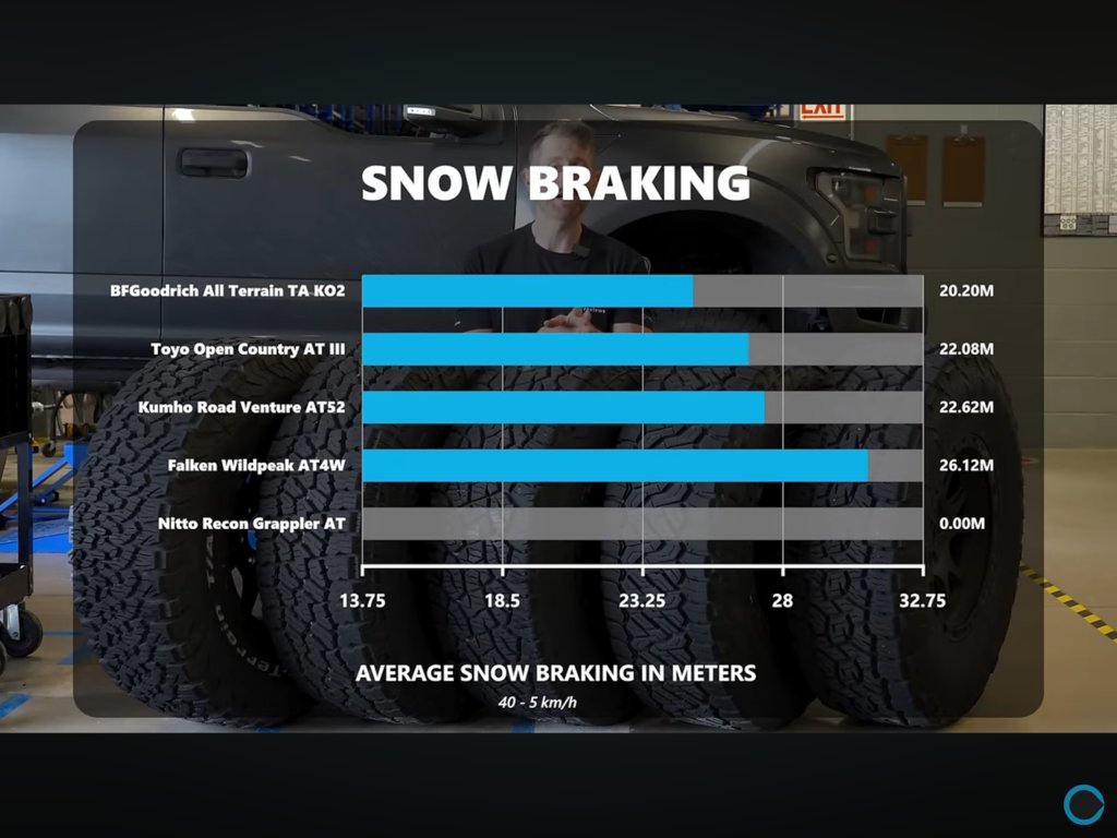

    Like I said over seen all the videos. That one especially goes against everything I've experienced. K02s were meh for me, a bottom tier at tire. By all account's the k03s are lot better but they aren't cheap either and given my feeling on k02s I wasn't ready to try out bfg again. Funny thing about my at4ws is they were significantly cheaper then the other options, paid 1570 cad for my set of 285s. So that's was a big plus in my books.

    Watched every video. My wife thinks I’m a mental case. Discount tire said I can swap the tires and they are being super flexible with me. As of now I’m considering the SL Falken 285/65/18 but that’s not as tall as I want (32.6”) and the grabber ATX in SL 275/70/18 (perfect size but the guys at Discount said that nobody buys them .. which makes me question their quality). I could also get e loaded Nokians. I hear they run comfortable (but people also said that about the Falken Es). I also could do the new Nitto G3s in 275/70/18. I’m in information overload not sure what to do. Just want a decently tough tire that will not feel like iron over even the tiniest bumps and has the diameter I want.

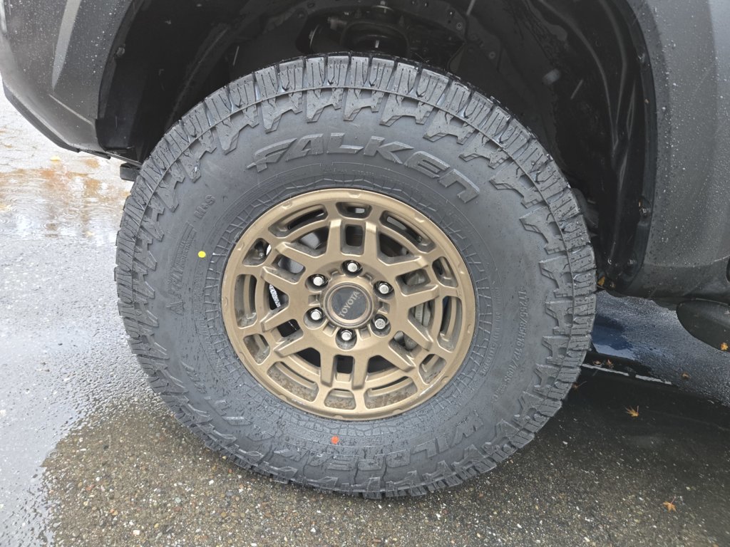

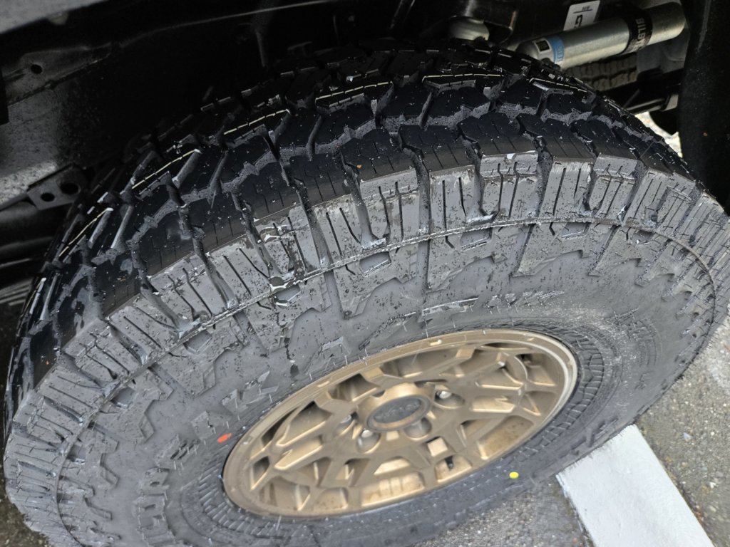

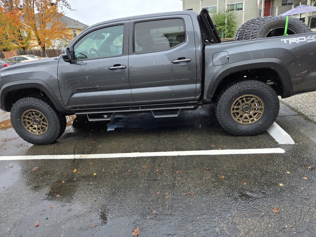

    These are terrible photos but I after wanting to switch over to the new AT4s since they came out in 255/85r16, I finally went over to America's Tire to get a set. I'm coming from Wild peak MT01s in the same size. I don't mind the stiffer ride or the noise from MTs but I couldn't stand the lack of grip in wet weather so I finally switched to the AT4Ws now that we finally have ATs in that size that isn't the Coopers. I haven't had a chance to do much driving with them yet since I had to get back go work after the tire installation, but they're a lot quieter, as expected, and so far they felt like they ride smoother. From a dead stop, if I gave even 10% throttle with the MT01s, the rear tires would lose traction and do a mini burnout in wet conditions. I can floor it from a dead stop with the ATs and not lose grip.
    One thing I got completely wrong was the weight between the 2 tires. For some reason I had it in my mind the entire time I had the MTs that they weighed 59lbs each. The AT4Ws in this size are 58lbs so I thought "oh cool, they're not too different in weight so my mpgs shouldn't drop, maybe even get better." I looked on the specs sheet on America's Tire's website last night and turns out the MTs are actually 51lbs?? So I'm actually adding 7lbs per tire on top of the 11lbs or so that the MT01s had over the factory Wranglers. Again, I just got the new wild peaks so I can't say for certain if it's had an effect on fuel economy yet. Here's some really shitty photos I took while trying to get out of the rain earlier today:

    Nice truck. Curious if you had to cut or trim anything running that size. I know some people do and some don’t but haven’t seen a lot of chatter concerning these specific rims. I have a trail edition with the same bronze wheels and a 1 inch lift. Please post a long term review when able.
    thank you in advance. Happy holidays

    Thanks. My truck has a 2" lift on the front and 1.5 rear (6112/5160). When I first switched to 255/85r16s, there wasn't any rubbing even when off roading of compressing the suspension and turning into a driveway. That was on stock UCAs. I got OME arms earlier this year and ever since I put them on, they've rubbed when I turn into my drive way going faster than 5mph. It's rubbed when I off roaded, too also when turning the wheel and driving through a dip or uneven ground. Basically it rubs when the wheel is turned and it gets pushed back enough to either hit the fender liner or the body mount right next to it. The place I took it to for the lift is the same place I went to for the control arms to be installed and I've noticed that while they do a fantastic job at installing my lift, they're not the best with alignments so I took it to another local auto shop recommended by someone else on TW and the guy did do a good job, but I'm still rubbing. Before I took it to this guy, both my front wheels were rubbing. After, the passenger doesn't rub but the drivers front still does to this day. I asked him to adjust the caster to 3.5 or high as best he can and he got it for the passenger, not the drivers which is probably why it's rubbing. I'm planning on taking it to an off road dedicated shop eventually to have the alignment dialed in. I even called them, Beep's Off Road in the SF Bay Area. First thing thr guy asked me was what truck, lift, tires, and upper control arms and I asked him if he could dial in the caster to 3.5+ with the set up I told him over the phone and he said shouldn't be a problem. Now I just gotta find time to drive my ass down there, lmao.

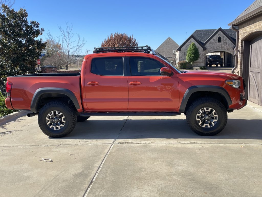

    Part of the skinny club now with 255/85/16 AT4W’s! Not much clearance, and the spare was damn tight. And a pox for four generations on the engineer that decided the spare tire hanger needed to bolt in from the top.
