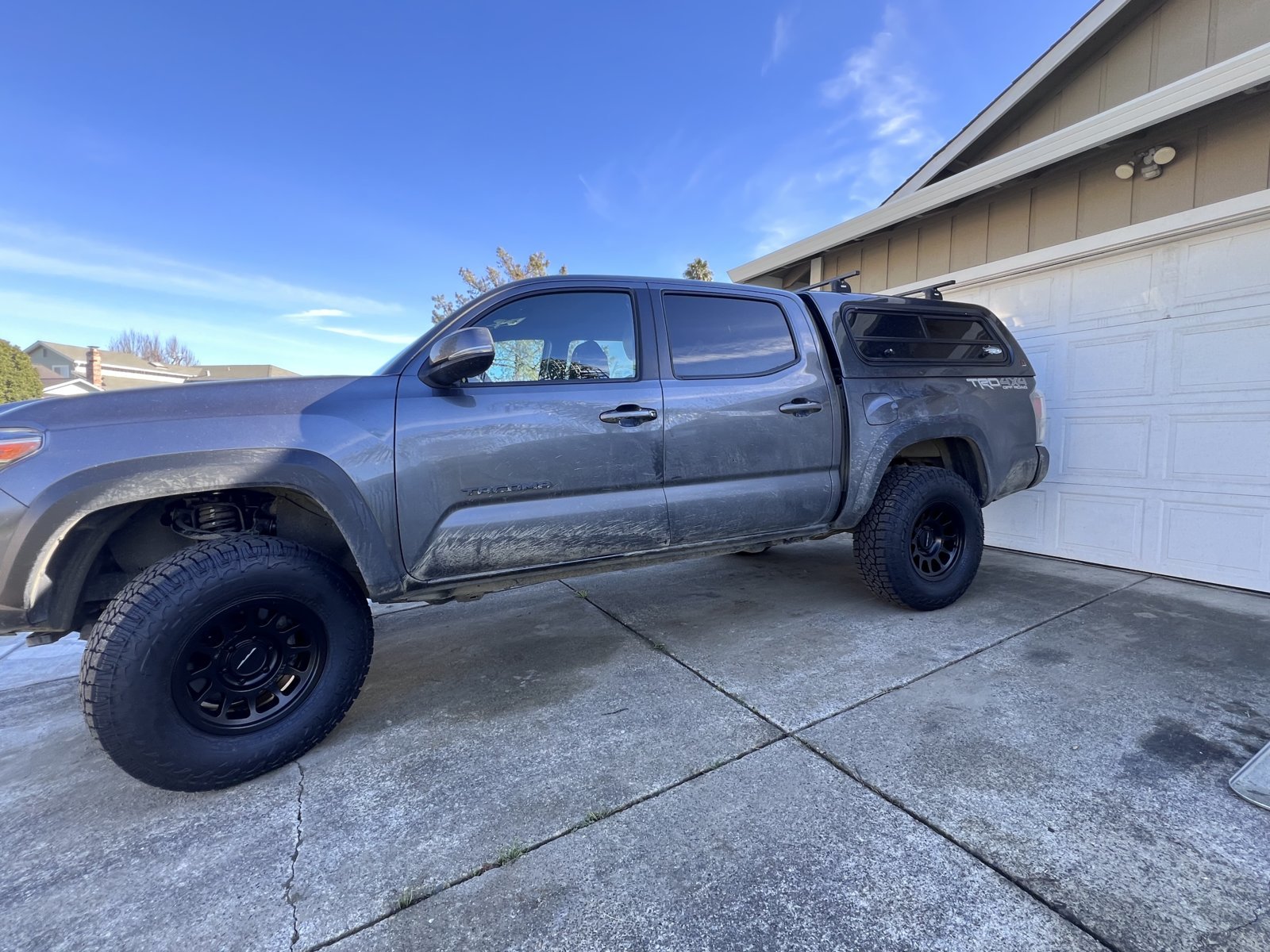

    Here’s the new falken wildpeak at4w
    On my 2021 off-road
    5100s all around 2 inch lift front 1inch block in back
    On 16” methods

    Wow :eek: I can’t believe you got a set already!!!!!
    Those looks awesome
    SoCalSB, LarryDangerfield and lamjam like this.

    Looks great! Thanks for the photos

    Lookin good @Dabigchee! Now take one off and weigh the suckers :)

    Those look great. 265/75R16 on 16x8 + 0 I assume?

    Yup 265/75r16 +0
