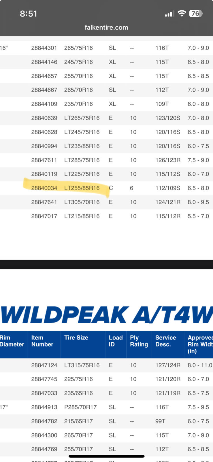

    anyone run 255/85/16 on a 16x8? Going to need to replace my 265/75r16(already a heavy tire) ridge graps by the summertime and the tall skinny interests me.
    I was thinking about going 285s but my truck only has a 1.5 lift in the front so I don't want to deal with rubbing issues. 16x8 -12 SCS wheels.

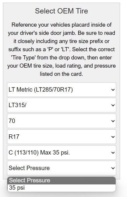

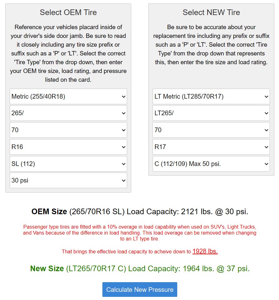

    They did a decent job lining it out, however, there is just a bit more to it that they left out. P-metric and euro-metric (in other words, anything metric and not LT) has a 10% overage factored in that you remove when switching to LT-metric tires. so the load you are actually trying to match is 1953 lbs (2149/1.1).
    They are correct that the load capacity for an LT-metric tire STARTS at 35 psi. Which is why it's "recommended" to put the tires there even if it's significantly higher in load capacity than your stock tire at that pressure. It's probably mostly CYA, because of there not being any official ratings below 35.
    No, they definitely don't feel the same, that's for sure. If both are at 35 psi, the E will be considerably stiffer due to the sidewall. However, what I'm saying is that for a certain load, they both need the same pressure (until you reach the max load of the tire). For example, I've looked at LT265/70R17 C and E. When calculating their new pressure based off of stock pressure, both support the exact same load of 1964 lbs at 37 psi. The C or E doesn't change anything, both support the same load at that 37 psi, and the E will ride rougher. However, the C will max out it's load capacity at 50 psi on that size vs 80 psi on E (or 65 psi on D).
    So this is where things get interesting and introduce things I've never seen before. You are absolutely right that an LT315/70R17 maxes out it's capacity at 35 psi. It also starts its capacity at 35 psi. So it is actually only officially rated for 35 psi:
    I probably shouldn't have said you were way overinflated. Really what I meant is that you are significantly below the "recommended minimum pressure," which I think you already know. If you did run at 35 psi and had nothing but trouble, then I can see why you lowered it. I don't really understand why the industry doesn't rate them to lower than 35 psi. I guess they expect anyone running LT metrics to truly be using them in an HD environment and usually sticking to stock sizes where it naturally keeps the pressure above 35 psi naturally (for example not running 35's on a mid-size).
    So the new tires will still have the odd 35 psi only rating, and you will still want to run them wherever you ran the current tires at for the same load (25 psi or 28-30 like you said), but it will be a softer ride for sure switching to C's. It's just unfortunate the industry makes it confusing by not rating them below 35 psi. And I learned something in that 315/70R17 also maxes out at 35 - that to me is just odd.

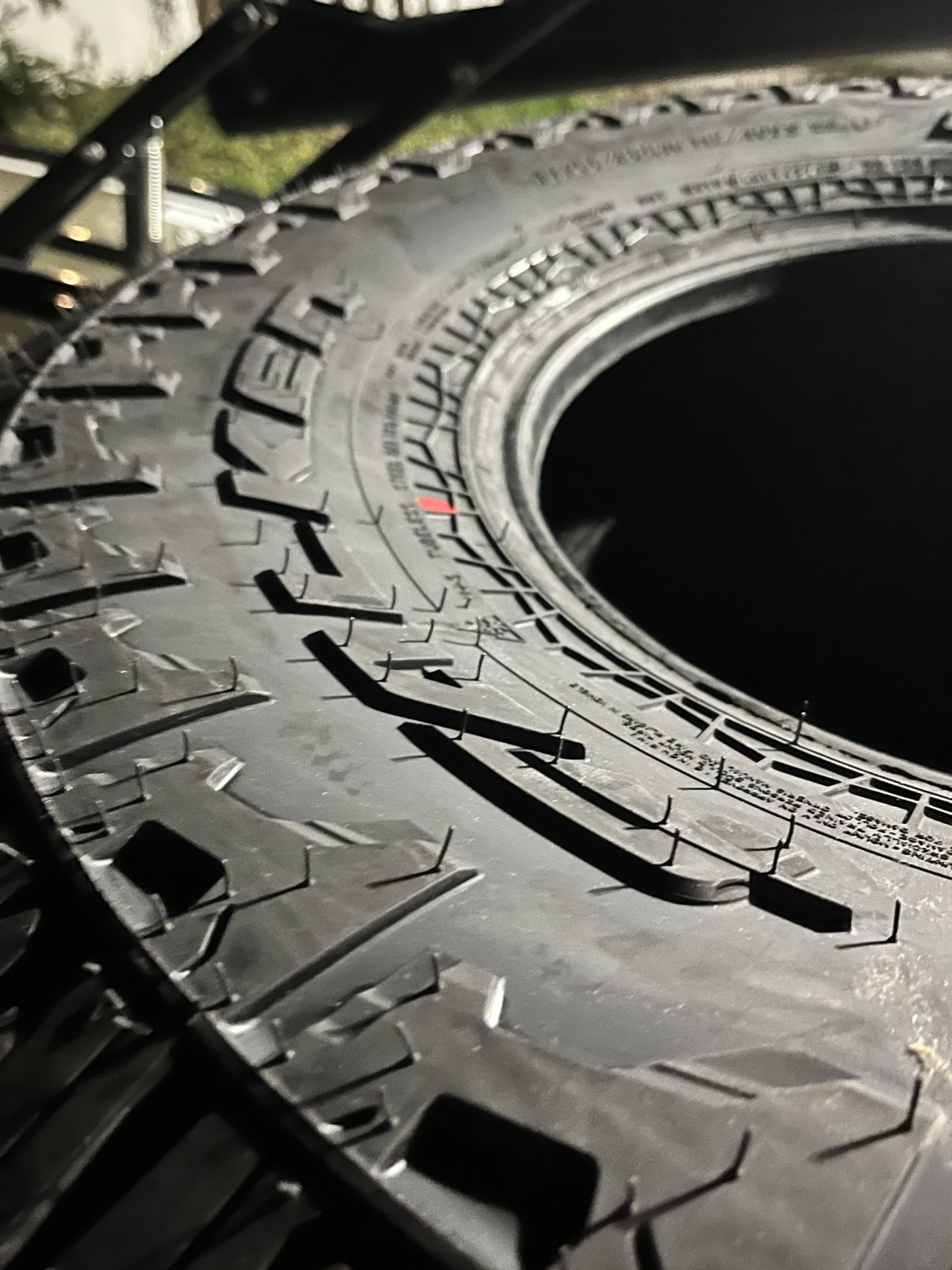

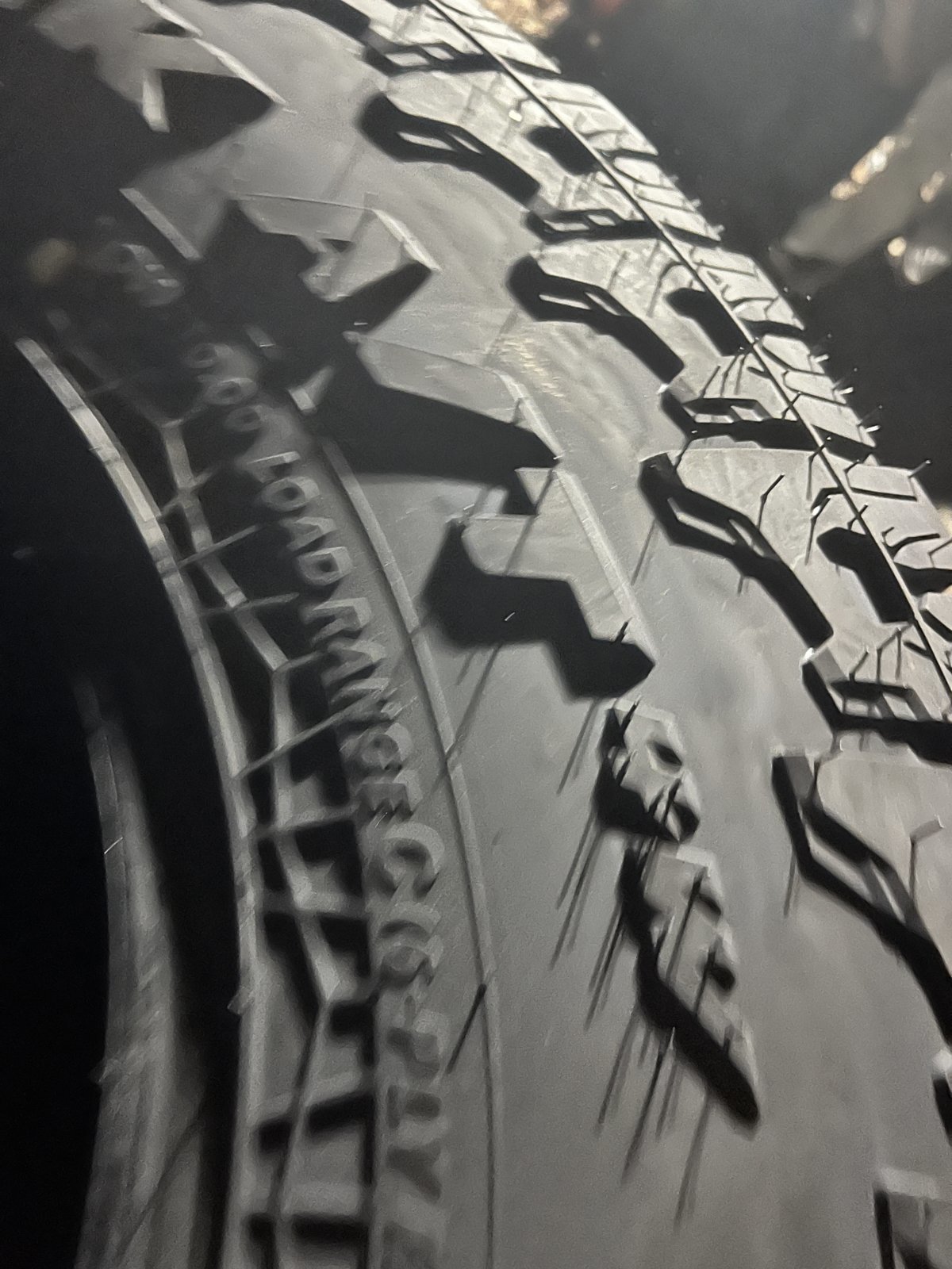

    Tires arrived today, they are in fact the new at4w’s. Wheels come next week, I’ll update when they are mounted!

    So you’re saying Falken made a 255/85/16 Wildpeak AT3W……!!!?

    Could be the opposite side of the tire? Maybe one is raised letters and one is not?

    That size in the AT4 has a different sidewall, called Duraspec. That could be why they are not protruded.

    Also, the wildpeak and falken text are raised on the opposite side

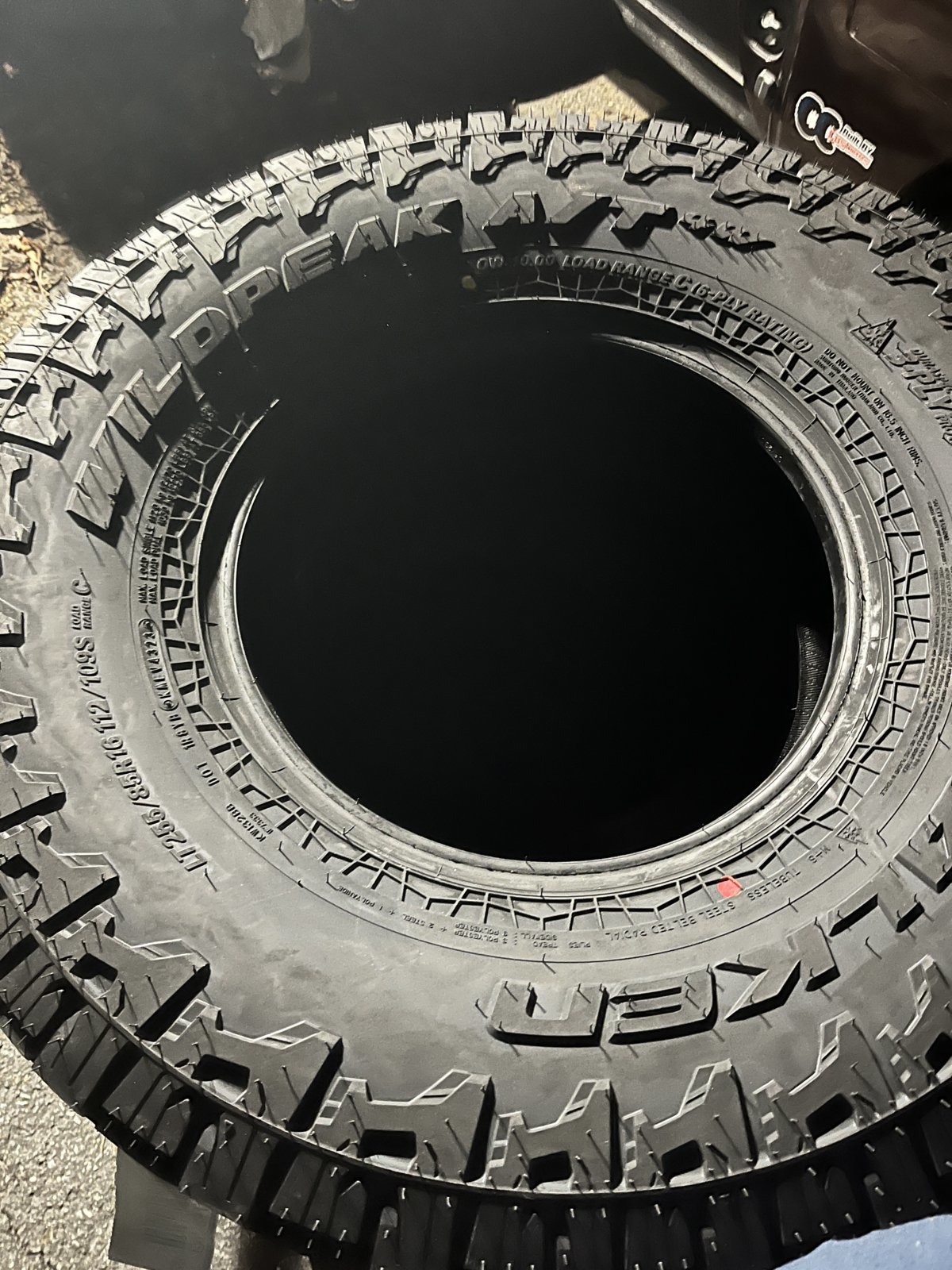

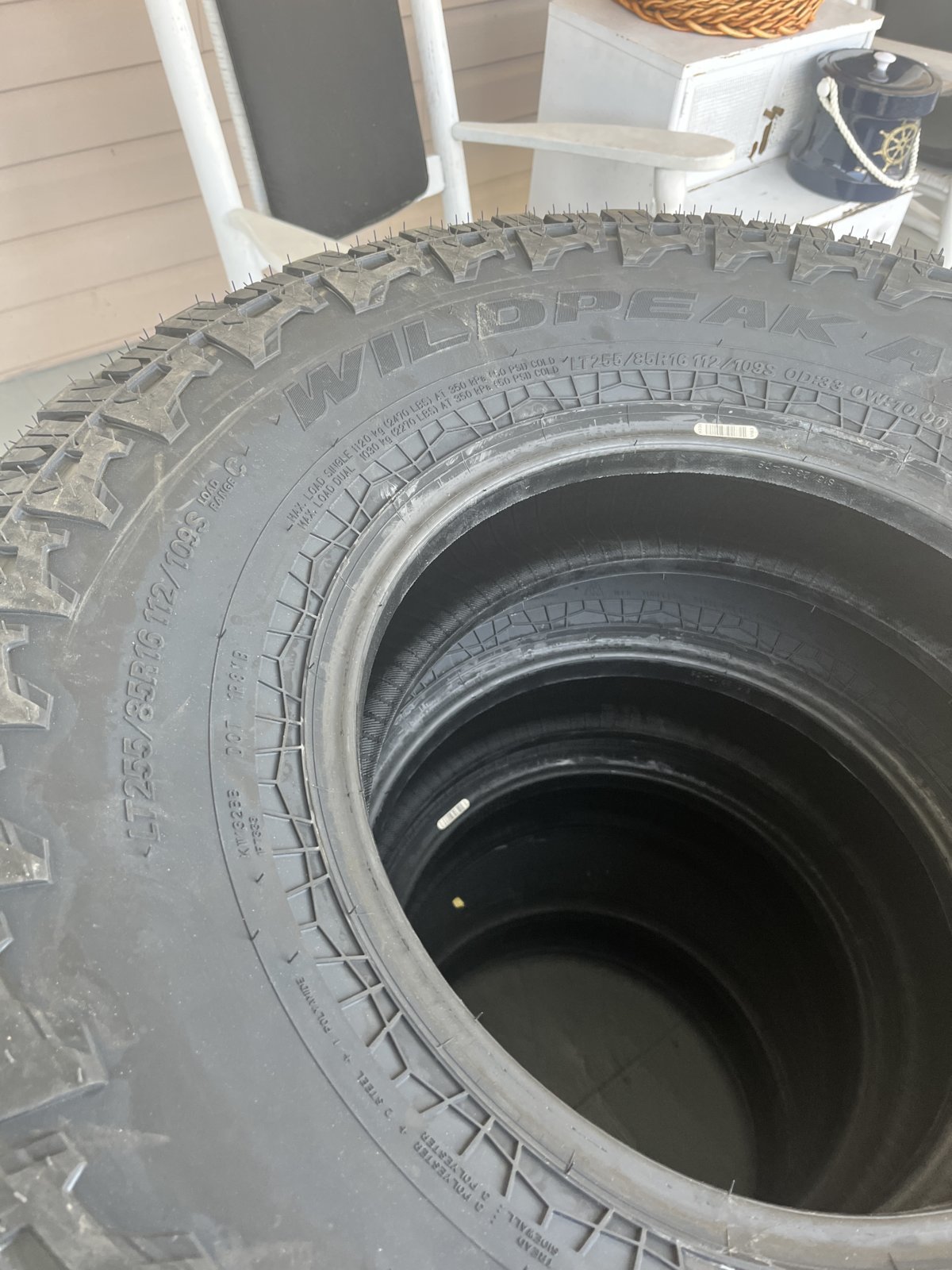

    More pictures for the non believers…
