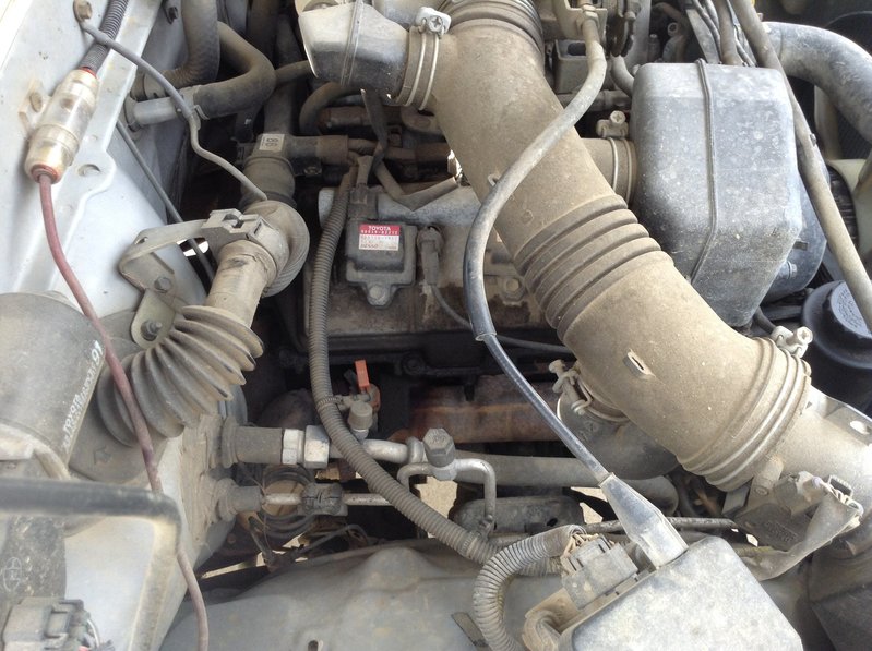

    Check to make sure the valve cover bolts are tight, they often loosen up over time. I could literately turn mine by hand so I tightened mine up and they haven't leaked since. Not sure if the bolt is loosening up or the gasket shrinking over time.

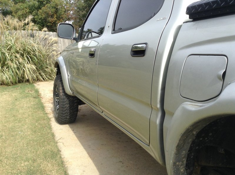

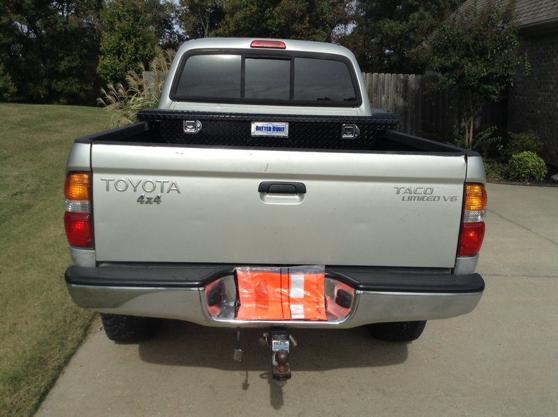

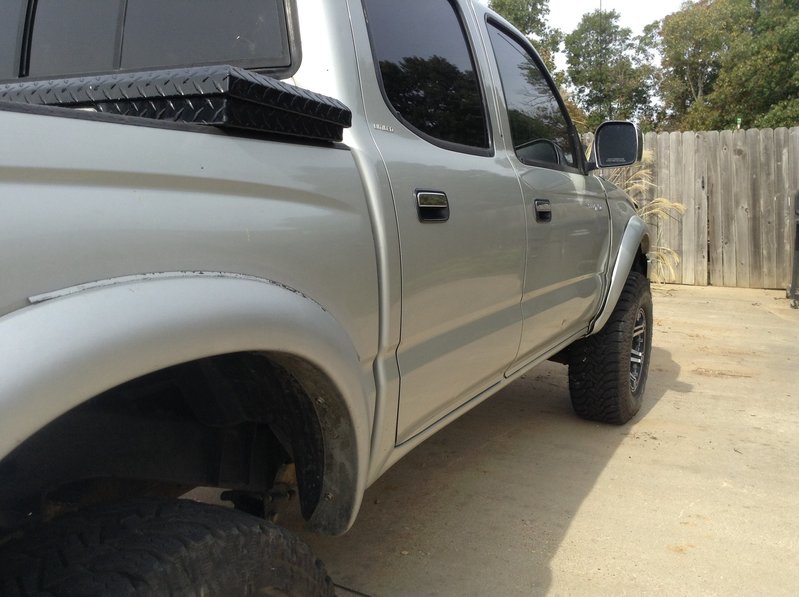

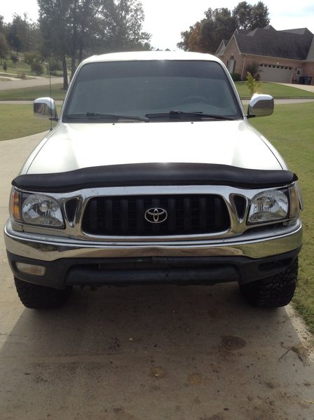

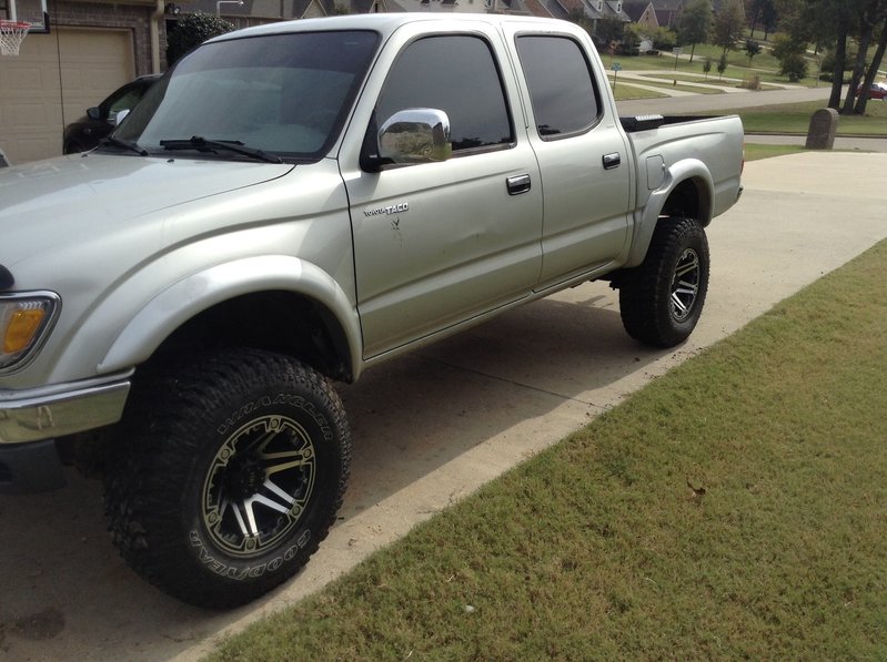

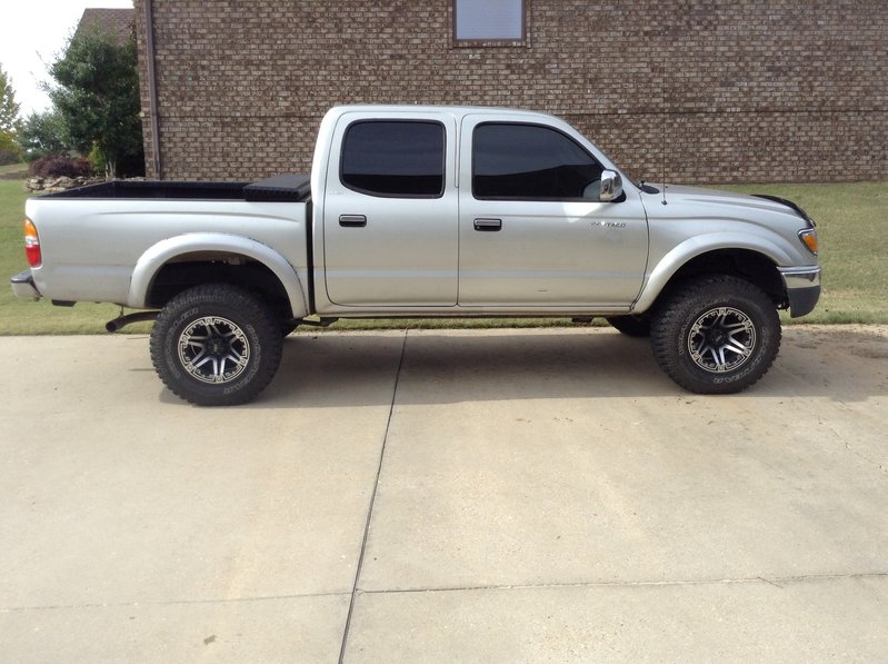

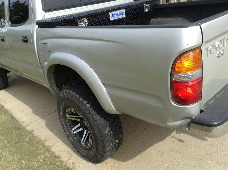

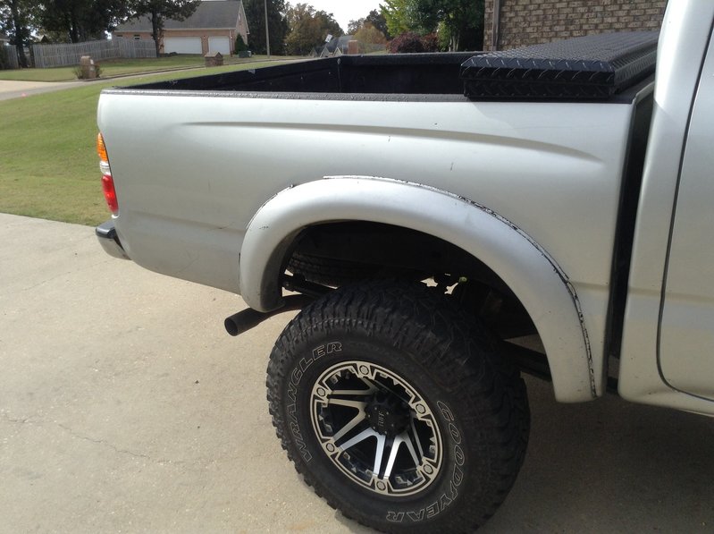

    Thanks for the replies and for being patient with a rookie. Here's some of the body. The side bed panels probably look a little worse in person. There's quite a bit of spray paint.

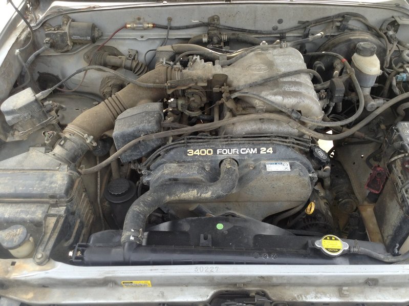

    Looks like a pretty heavy leak, mine was pretty light. Might as well replace when you do the timing belt and water pump as well.

    That doesn't look bad. If it truly is a limited that is in your favor too. Withthose miles I would keep it if it drives well and interior is in good shape. If the bed bothers you have it fixed eventually. Remember that acetone will take off spray paint but not automotive enamel if you don't rub too hard.

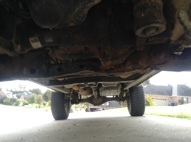

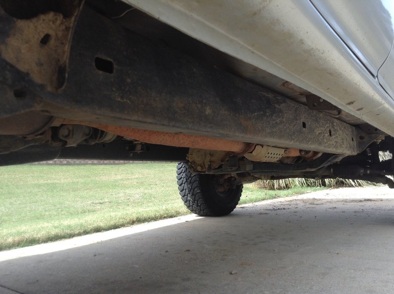

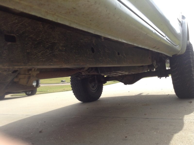

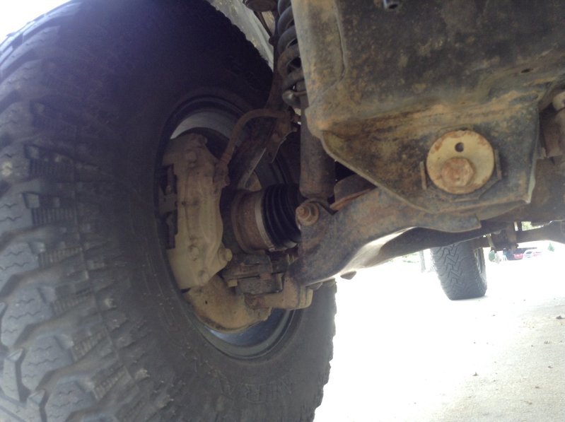

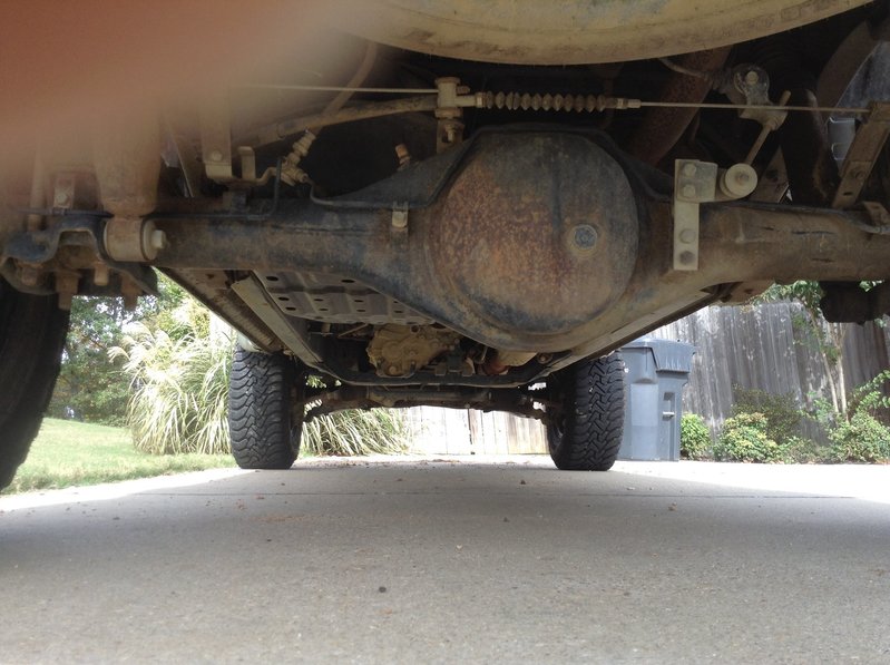

    Thanks guys. What are your thoughts on frame?

    From what I can tell the frame looks alright, she does need a bath though. The frame rot tends to start from the inside out. Frame looks the same as my 99 that was a SoCal except the last 2 years it has been an Indiana truck.

    nothing looks too bad to me. The frame looked good. Only thing that looked rusty was the exhaust.

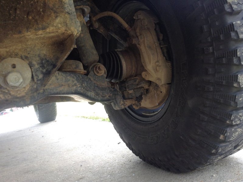

    Front driver side control arm looks a little rusty but hard to tell from picture. I also noticed it looks like you don't have a skid plate.

    It needs a little love. Can't wait to see what happens next.

    I think it was a great buy, just the last owner was a kid who didn't know what the hell he was doing. Years ago I saw my cousin spray paint his rims while still on the car as well as his wiper blade arms with no prep. Teenagers do dumb stuff to try to modify their car. He probably thought matched paint would look the same so over spray wouldn't matter.
