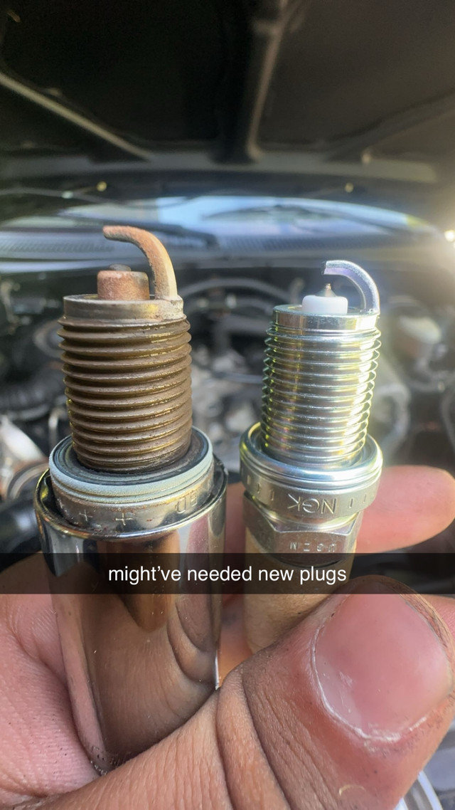

    Never been happier with a vehicle purchase. Coming on here with a couple questions as a first time tacoma owner. The truck spent its a good chunk of its life in Mass where it accumulated a fair amounts of rust, nothing too major from what I can tell, however this brings me to my first question of what all should I be looking to replace regarding the 23 year old suspension to improve ride quality or just components that are prone to failure, so far i’ve heard some things about the LBJ’s. Then my next concern is with the 2.7 what should I be looking to replace as it didn’t come with any service records, I just replaced the spark plugs and coil packs which made a noticeable improvement in performance, i’ll attach a photo of how bad the plugs were,
    made me thing they had never been replaced so im at the point where i want to assume nothing has been changed besides oil in this truck since new. Thank you for everyones time and acceptance on this forum, if there’s any thing else you think I should know as a first gen owner I would love to know!!

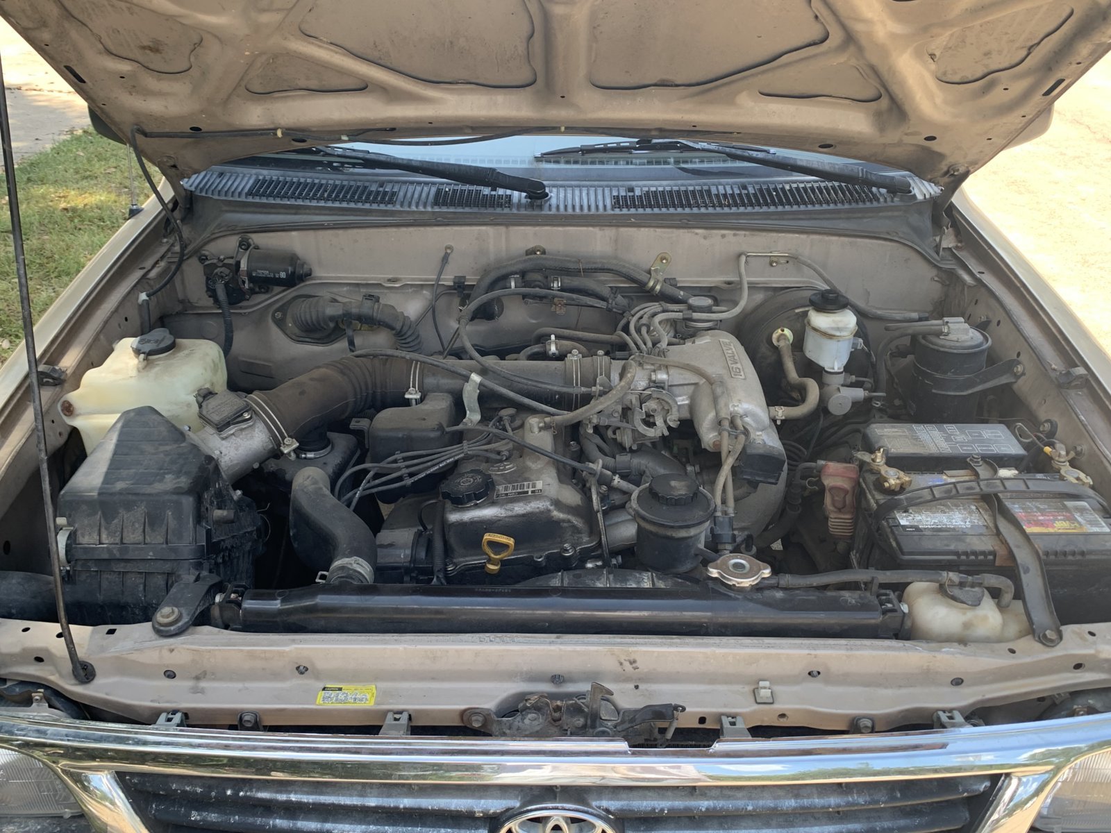

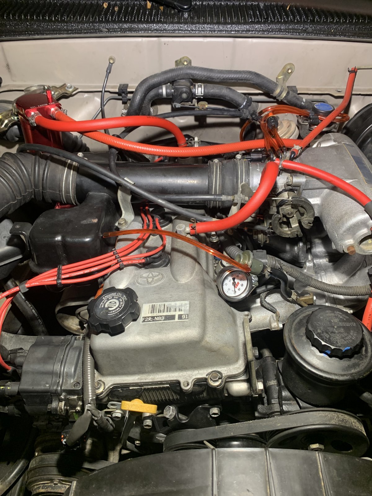

    Steven
    Sugar Land TX
    1996 Taco 2.4L 2wd Automatic
    Clock Volt meter/LSPV Delete/Hyundai 16’s/FP gauge/after 9months of wrenching ZERO oil leaks
    2.4L and 2.7L virtually the same
    I went thru a 96 2.4L…..mainly engine all fluid changed
    With lots of help/advice from others members here….and 9 months of wrenching
    runs like a top!
    Search my threads…I’m pretty good about posting pix
    B4 and after pix
