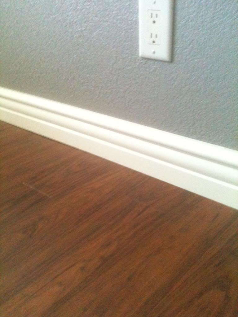

    Don't use laminate in kitchens or bathrooms. Even the best quality laminates will absorb water through the joints.
    Laminate is good against scratches. Make sure to get at least a rating of AC3 or AC4 (higher the number the better it is for traffic). I think Pergo and Quickstep are great brands and both very easy to find.
    As far as underlayment, my preference is to get laminate that does NOT have the pad already attached. It is very easy to lay down underlayment.
    Here is a recent bedroom I did (new paint, baseboards, laminate flooring).
