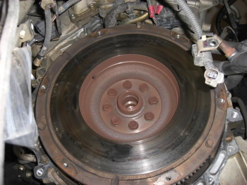

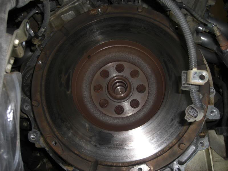

    Torspd Custom Turbo kit [] Borg Warner 9180EFR Turbo [] Haltech Elite 2500 [] TiAL Q BOV [] TiAL V44 Wastegate @ 15psi [] CP Pistons [] CP Carrillo Rods [] ARP Head studs [] ARP Main Studs [] ARP Header - Head Studs [] Ported Heads w/ 1mm oversized valves intake/exhaust [] Brian Crower Forged Stroker Crank [] Darton M.I.D. Sleeved Block [] Kelford Camshafts [] Torspd 160* T-stat mod [] APR Large Fuel Rail [] Walbro 460 LPH E85 Fuel Pump [] FueLab FPR [] APR T56 Conversion Kit [] KP RACING Built T56 [] McLeod Racing Custom Twin Disk Clutch [] One Piece Aluminum Driveshaft [] MGW Shifter [] Custom lowering kit [] Ohlins Front Coilovers [] QA1rear shocks [] Custom Ron Davis Radiator [] Dual SPAL Electric Fans []
    Is the truck torn apart? If so, get pictures.
    I have. Plenty of times.
    The Fluffer likes this.
  14. Sep 4, 2015 at 6:06 PM
    Torspd
    Torspd Tor-nication
    Sep 18, 2009
    #22958
    26,439
    Tor
    The Great America!

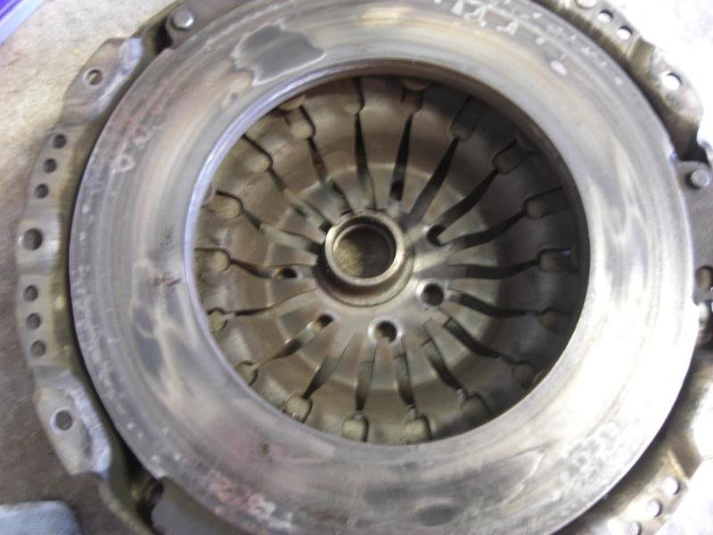

    MMVI 4.4L 4x4 Access Cab
    Those heat spots saturated through the bottom. Couldn't be machined out. As multiple passes proved it worse.
  15. Sep 4, 2015 at 6:11 PM
    Torspd
    Torspd Tor-nication
    Sep 18, 2009
    #22958
    26,439
    Tor
    The Great America!
    Clutch disk was still good. Pressure plate looked the same. OEM clutch. Springs didn't have enough clamping force.
