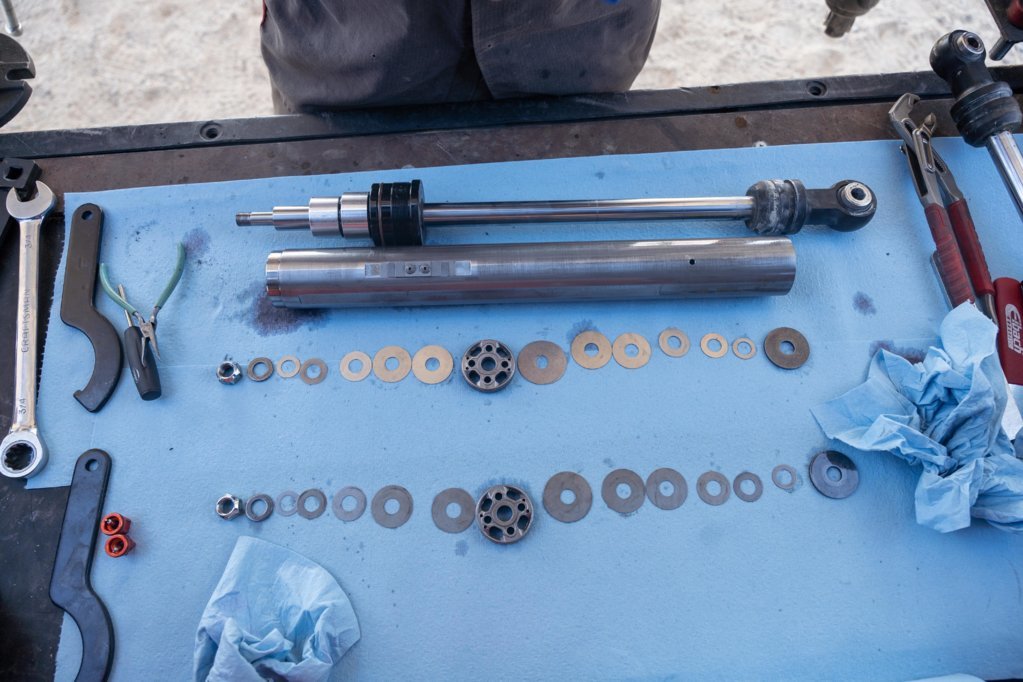

    The design is fairly simple:
    Their IBP's use an inner sleeve that necks the main piston down to a 2.0. There are 1 way "reed valves" along the cylinder which allow some oil to bypass the main piston depending on which zone it's in. You can tune the valving in the main piston and you can change the port size and placement in the inner cylinder as well as the shim thickness to dial in each zone as you like. For instance if you want the ride zone softer you can increase the hole size, use lighter shims on the cylinder, add holes/valving to lighten it up, or lighten up the main piston which will soften all of it. It's rebound zone is a little weird and i can't get it to behave as nicely as an external bypass, it's pretty much just a ride zone specific bleed hole in the cylinder.
    Very cool tech, but i'm doubtful that it's suited to this application. If anyone gets a set in so-cal i would love to ride in the truck with them to see!
