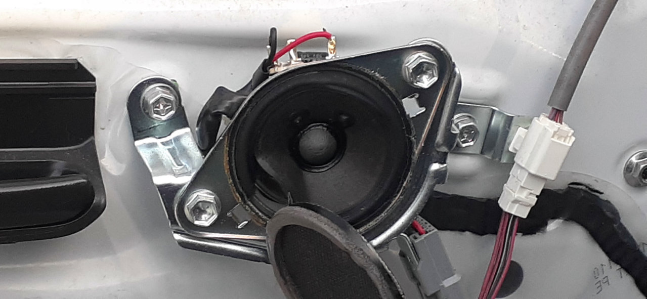

    My stock speakers finally went out, so I bought some new ones. I took the door panel off and the new speakers do not fit. The stock speakers have a plastic mounting plate that screws into the door and the tweeters are attached to a metal piece that screws into the door...

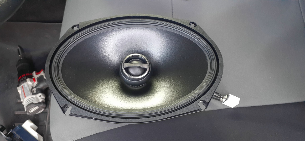

    How do I mount the new speakers?! Here's the new speakers

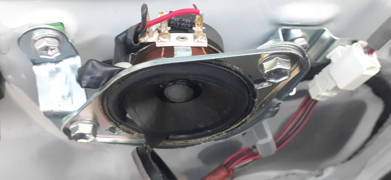

    Here's the stock speakers/tweeters. The tweeters are connected to the metal bracket.

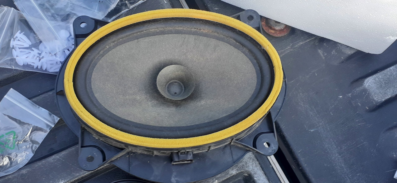

    you just need to buy the adapter rings or make your own. take a look at any audio web site and they will sell the adapters

    Here's the hole for the bottom speaker, but there's nothing to mount the new speaker to...

    You need to buy adapters.

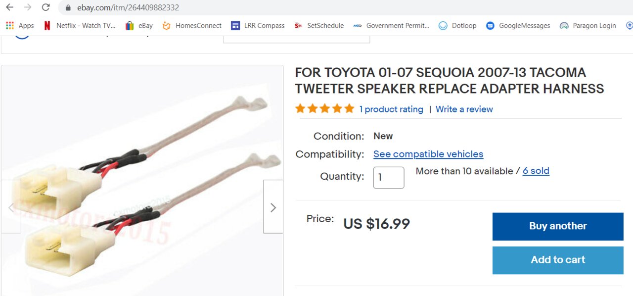

    Thanks, I just ordered these... What do I need for the tweeters?

    bro slow dow you gotta’ learn to figure this stuff out it’s not rocket science… open the tweeters and look for a template or read the instructions and see if a mounting hole size is listed or if you can just measure the template

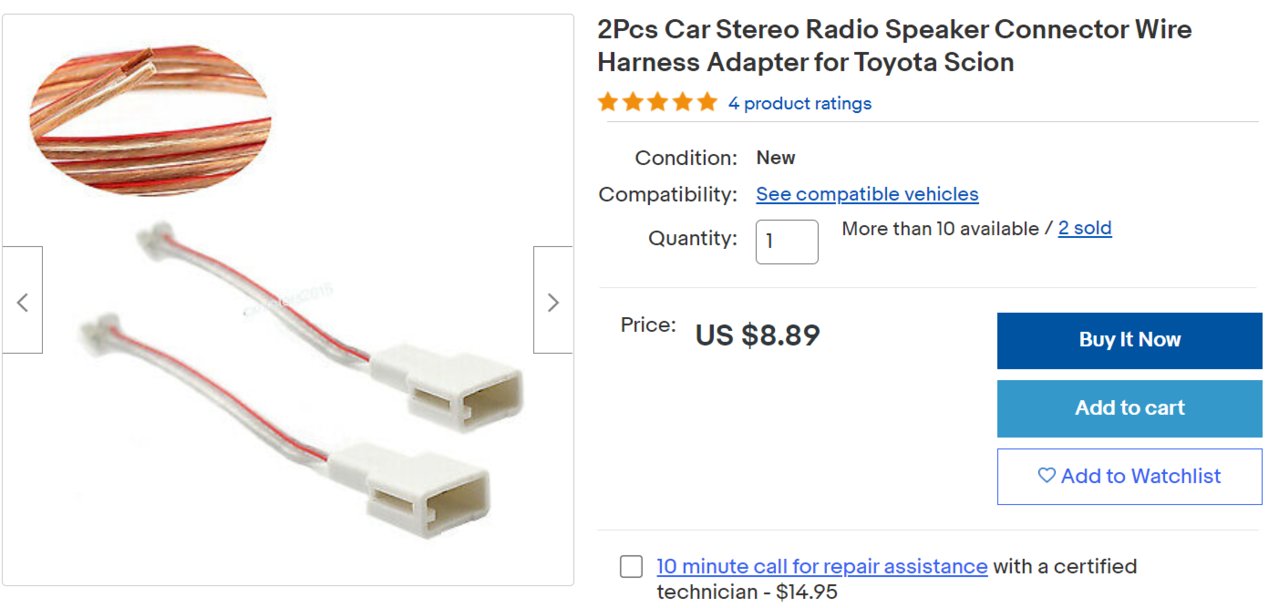

    Just bought these adapters... not sure if they're the right size... can anyone verify? 2013 TRD Sport front door lower speakers and upper tweeters. no speakers in the back access cab area.

    Yeah u need the adapters for the 6x9 speakers
    The 2 3/4 speakers are incorrect. You need tweeters and a crossover to work with your 6x9 speaker in the frontyour Rear doors can use 6.5 speakers. I recommend a coaxial speaker 2 way or 3 way on the rear passenger doors so that they can deliver the full range of sound in the rear

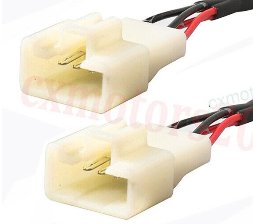

    For my tweeters I just cut the harness off the factory ones and connected to the new ones.
