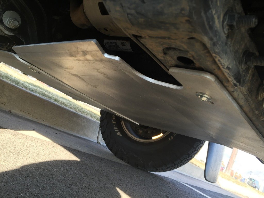

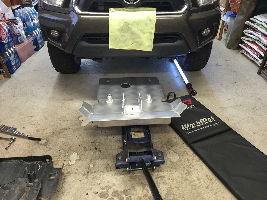

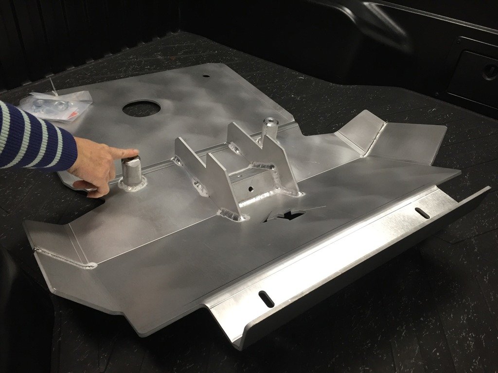

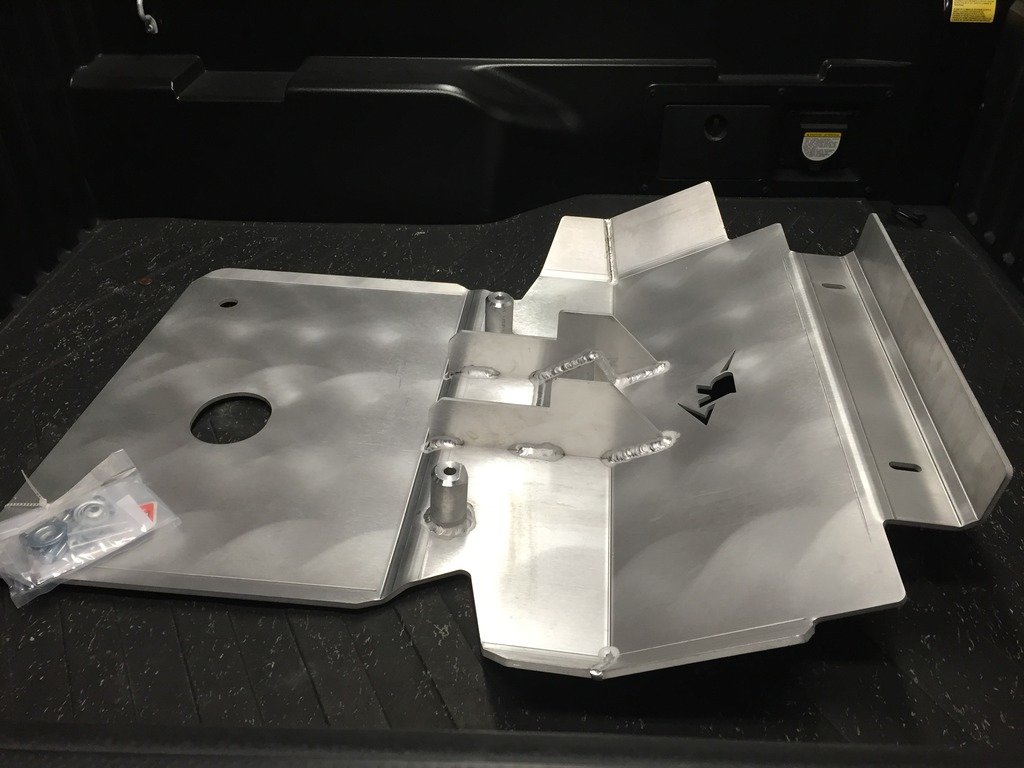

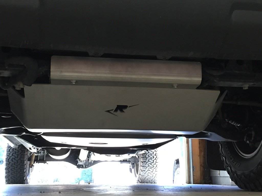

    Hi all. Just installed a combined front and engine skid plate. I went with a 1/4" aluminum skid from Ricochet Off Road. They are local to me, which made taking a look easy and saved on shipping. They are great to work with. Very helpful and great follow up. The skid is well designed and fit well. Ricochet specializes in ATV skids but they also do Toyota skids, especially for FJs. The person I worked with is Brad. He is the key behind the Toyota skids. He owns an FJ and developed so he could have skids. Hardware is 8.8 metric and looks to be high quality. Whole skid weighs about 30 lbs I estimate. Anyway, great product and service. Here are some pics:

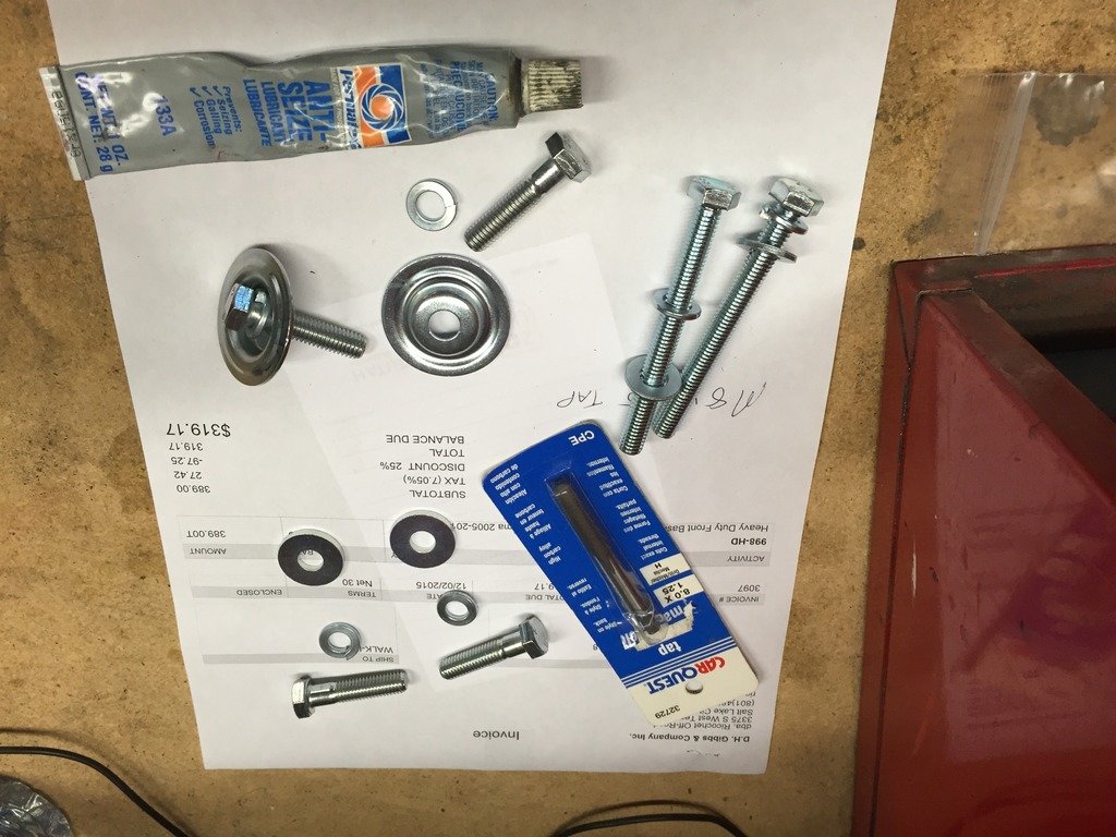

    One thing of note; can't truly tell from your pictures, but you may want to double check that you're using SS fasteners. Using zinc plated with Alu. will only exacerbate dissimilar metal issues... Might want to add some form of isolation washers in between your mounting pads and the bolts as well.

    That seems to be the common perception but its actually the other way around. Here is a chart showing how little galvanic potential there is between aluminum and zinc.
    http://www.pemnet.com/design_info/galvanic.html
    Its still a good idea to use dielectric washers of some sort.

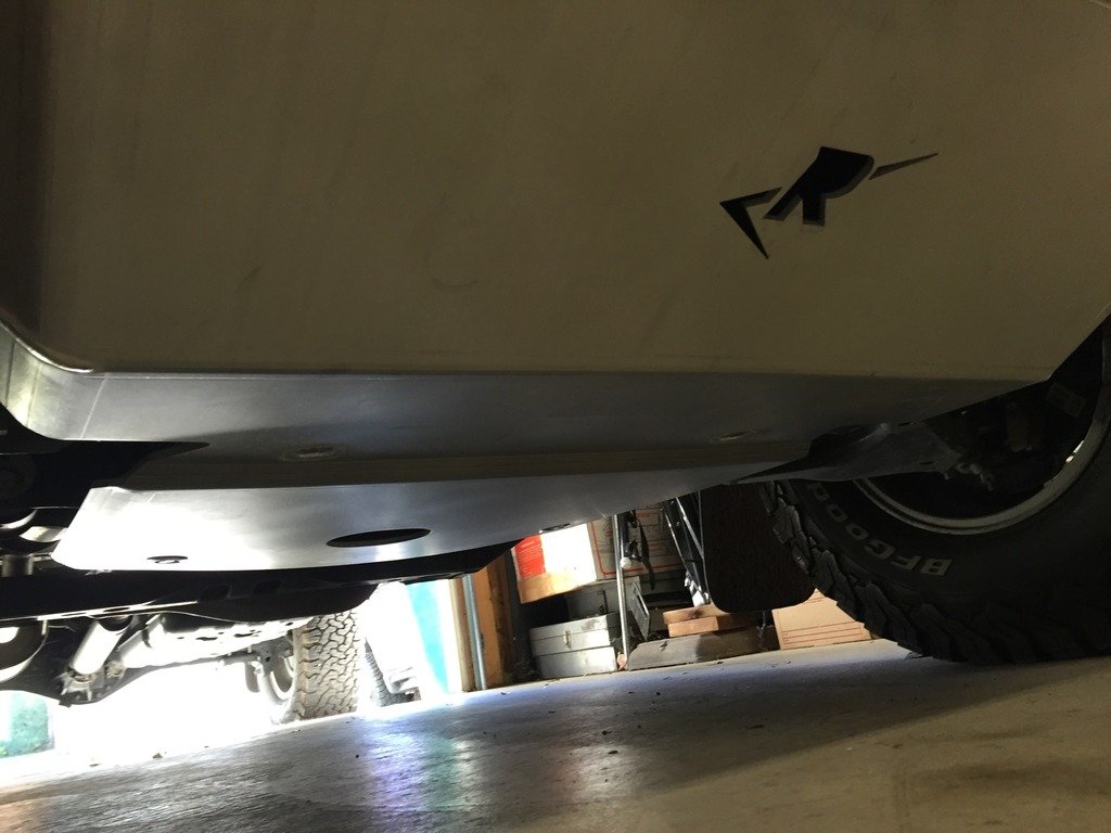

    I also just recently picked up their trans skid. It is for an FJ so it took drilling an additional hole. These guys are great to work with and helped me sort through the trans skid install. Here are a few pics of the trans skid installed.

    In case anyone is installing the bash plate, as came with no instructions, definitely chase all the threads first. Two of the shorter bolts go to the rear, two to the front, the two long ones in the middle. The large concave washers go to the rear. The two spacers go to the front, in between the skid and subframe. The middle and rear bolts utilize the smaller flat washers, the front- the larger pair. Lock washers for all bolts (just below the bolt heads). A little anti-seize on all threads is a good idea. Also my two front bolts didn't quite lineup, even after loosening/removing the other bolts- the holes are slotted front to rear, but my problem was side to side- took a little material off one of the slots and then used a small pry bar to help line it up.
    the Ricochet bashplate weighs 28 lbs, the oem plate 8 lbs- mine (oe) had a pretty good crease in it discovered when I removed it:eek:
