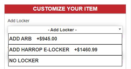

    Just to clarify for others following along.. that $920 you mention may be adding the locker only. Regear is closer to $3k for a 4x4 (~$1,500 for a 2wd truck) unless you're doing the gears yourself.

    https://eastcoastgearsupply.com/i-23993416-8-75-tacoma-elocker-third.html
    This is the product I was referring to, assembled 3rd member with E-locker and choice of gearing. Understood that the install labor will be significant though, up to the price range you mentioned

    I dont think you can just add that, and have an E-locker on a Sport. It will take way more than that to get it to work, power switches, wiring, etc... Ski

    I agree with @skidooboy, I believe the ECGS link you posted is for Tacoma's that have the factory/OEM e-locker.
    This links appears to be the options for swapping out SR/SR5/Sport clamshell with a locker: Either the ARB or Harrop options.. below is the option fees from ECGS when ordering a 3rd member.
    So $895 for the clamshell/gear swap plus the fee above.
    https://eastcoastgearsupply.com/i-2...everse-ifs-clamshell.html?q=arb+tacoma+locker

    I see it now, thank you
