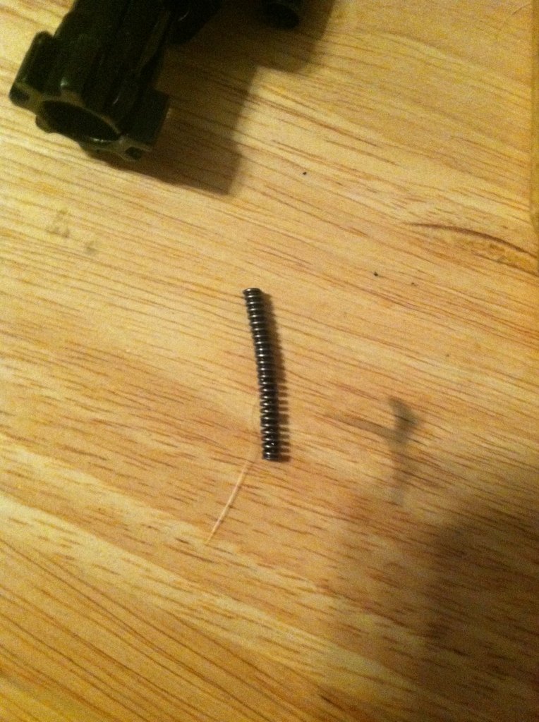

    Ok guys I just broke everything down to take some pics and look what I found....

    Here's some pics I just took...this long skinny spring fell out when I took the BCG apart...and it's bent....
    8419683F-B677-4182-AF82-CBC3760FDE32-110_e9fbd6658fa52d6aa092c9e890543835f99847a0.jpg
    Sorry for the big pics never used photobucket before

    So you didn't take the bolt apart? Just the BCG right? That's your ejector spring. I think your ejector roll pin and ejector launched themselves.

    Yea... that shouldn't be in there.
    uh oh

    Well... it should be inside the bolt. The bolt being housed in the BCG.
    That spring should be behind the ejector, and all of it retained by a small roll pin.
    It shouldn't just fall out unless you've removed the roll pin/ejector.
    Certainly shouldn't be loose unless you've removed it.
