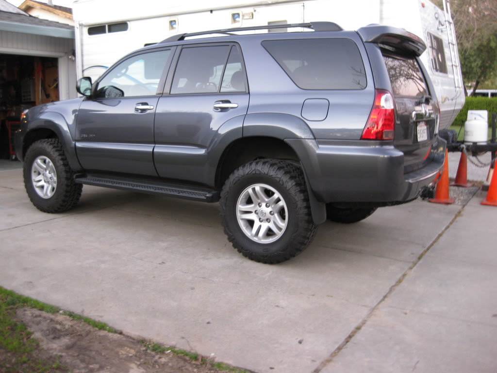

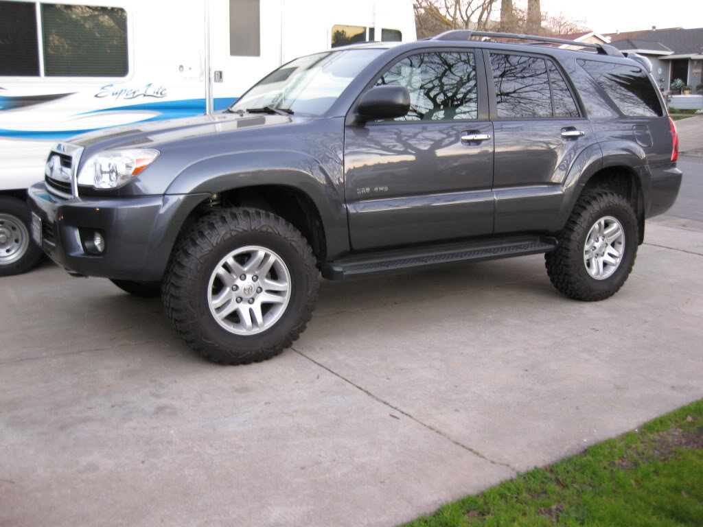

    Here's some inspiration. My wife's mall crawler:

    THAT is the stance I want. How much lift front and rear is that? 3"?

    Yessir. Toytech's ultimate coilover lift. Front coils set at 3. Minimal trimming to clear 285's
