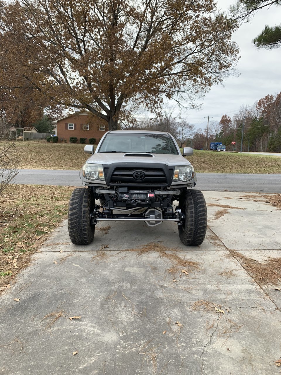

    Hey guys. Finishing up my build on my ‘09
    Been looking through threads here and figured I’d join so I could get some advice or feedback from everyone. I’m a member of other 4x4 forums but it seems nobody on them really messes with newer stuff.
    Anyways,
    Here’s my taco. I may start a build thread?? We will see.
    E7507814-87F2-44B6-B2F9-D9EFF22987BB.jpg A02B2D19-B4F3-4C33-A9AC-77DA2C61ADAC.jpg

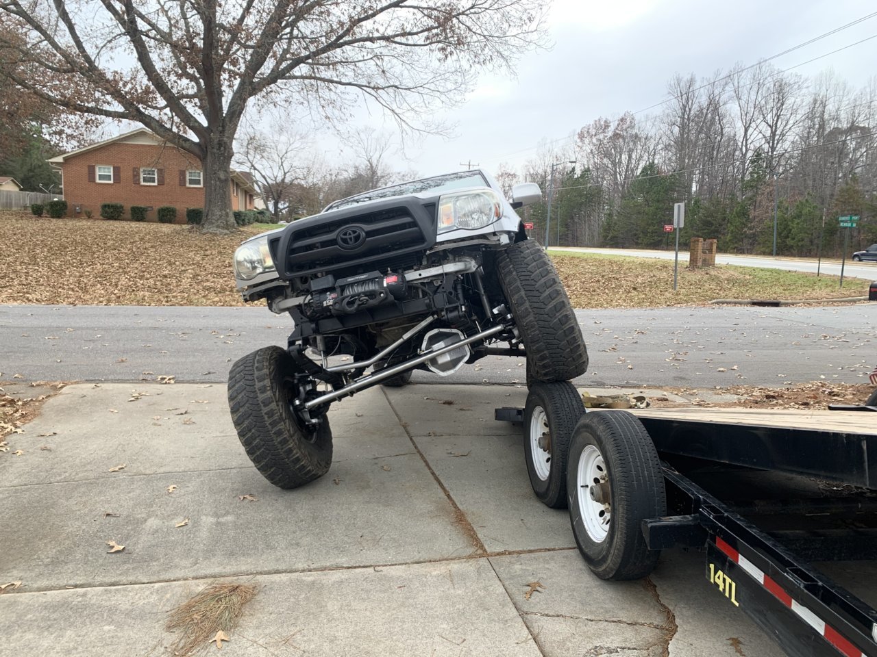

    What steering kit is that? And what front springs, I cant tell on my small phone screen if they are RUFs or not. How much up travel do you have before pan to axle housing contact?

    It’s all 1 ton Chevy TRE’s and drag link ends. Had to use offset TRE’s to clear the diff.
    I’ve got about 5 inches of up travel. 3 till bumps hit and they compress a good bit on hard hits.
