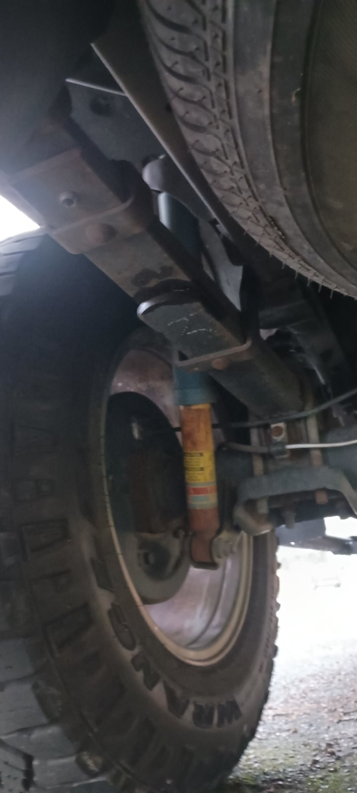

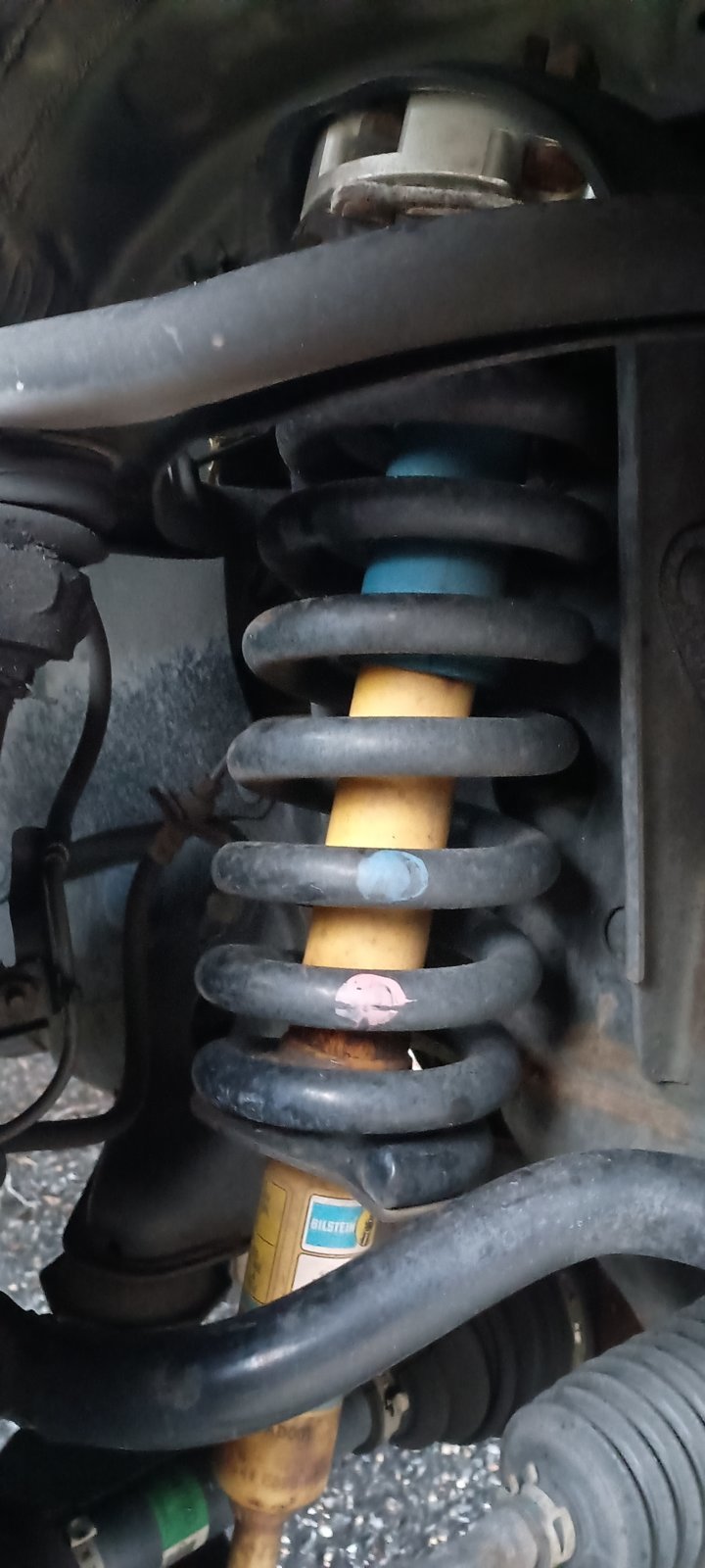

    Hey, guys. Found this forum recently and finally joined.
    I very recently picked up a 2014 Double Cab V6 TRD sport and I am loving it so far.
    I am trying to find out if this truck has been lifted. I don't know anything about lifts so I apologize if this is a stupid question.
    The truck tires are larger than the door sticker. Sticker says p265 65 r17 and the tires on it now are 265 70r 17s
    Can you tell by looking at the suspension really quick?
    IMG_20240107_161058124.jpg IMG_20240107_161058124.jpg IMG_20240107_161058124.jpg IMG_20240107_161216966_HDR.jpg

    Looks like you have a spacer lift in there. Those silver pucks up front are not stock.

    looks like spacer blocks and slightly bigger than stock tires
    I think stock was 265/65r17 and 31” = 265/70r17

    The stock tires are 65s and these are larger 70s.
    When this was lifted, was the only thing done adding those spacers?

    How does your truck sit? Is it level, or does it have a slightly higher nose than tail? A stock Tacoma is fairly level, so having a spacer lift in the front and nothing in the back seems a little odd. Or was a heavy bumper installed on the front perhaps?

    Because the front is generally a little lower than the rear, from the factory. A front lift or leveling kit will 'level' it.

    if you're not gonna be wheeling it hard, you'll be fine. they probably put that spacer in there to level the truck, a lot of people prefer that look rather than having some rake (front a bit lower), which means the truck is leveled when you put stuff in the bed and it compresses the rear suspension.
