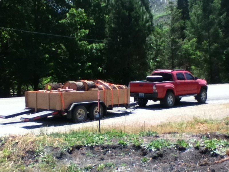

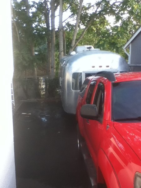

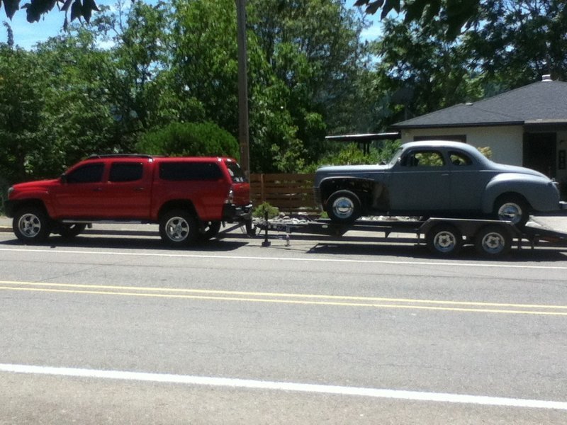

    Do you guys tow with your Tacoma of course pulling my boiler was a breeze

    How much does your trailer weigh is it an air stream

    The airstream is currently being rebuilt and is extremely light.
    I have towed/hauled +6k, but I wouldn't recommend going into that range without experience and properly setup with airbags/ WD hitch/ sway control.
    At 4200lbs, you will benefit from having airbags.
