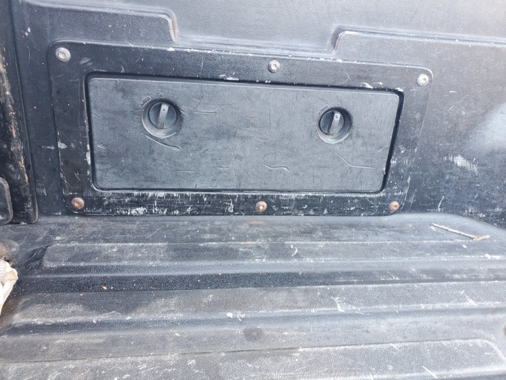

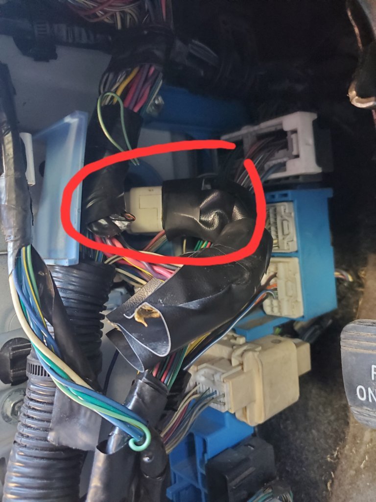

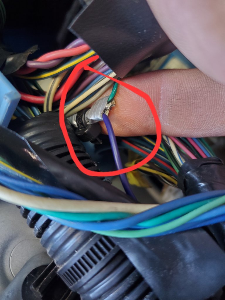

    About a year ago, after somehow locking both sets of keys inside the truck, I wired in a "Trunk Opener" momentary switch from a JY Avalon and mounted inside a storage cubby inside the bed.
    One switch leg, I tapped into the green/black Unlock wire that's in the wire harness that comes into the cab from the door behind the driver side kick panel and the other leg is tapped to ground.
    Never again will I be locked out. 20241210_151622.jpg 20241210_151115.jpg 20241210_151001.jpg 20241210_154145.jpg 20241210_154137.jpg
