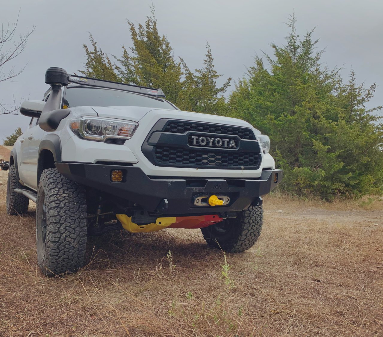

    18 Tacoma TRD off road OME BP51 front Fox 2.0 Resi rear OME Dakar Meduim Yoko G006 325/75r16 Black Rhino stadium wheels Cali raised ditch light brackets Baja Designs S1 pods Baja Designs Squadron SAE fogs Prinsu Cab rack TRD Pro grille AVS rain guards Backwoods adventure mods hi-lite bumper BL Apex 12k winch Dobinsons 4x4 snorkel Sy-clone prefilter ARB rear diff breather relocation RRW rock sliders RCI full skids At the helm bed stiffeners lil b LCA skids Warfab Phantom rear bumper Warfab tie rod sleeves C4 fender liners Dirt king UCA Duro bump stops
    I’m on 285/75r16. I had to do minor fender trimming and no cab mount chop.
    My truck has a 2” lift in the front, 1.5” in the rear and my rims sit at -6 offset.
    The biggest issue on clearing this size tire is getting your tire away from the Upper control arm. The sweet spot is 0 to -10 offset. Also with after market upper control arms you can adjust the caster but it’s not truly needed until you hit 3” of lift.
    2” of lift and proper wheel offset and you should be fine but every truck is different.
    Or just get a new front bumper and not worry about front rubbing :D
