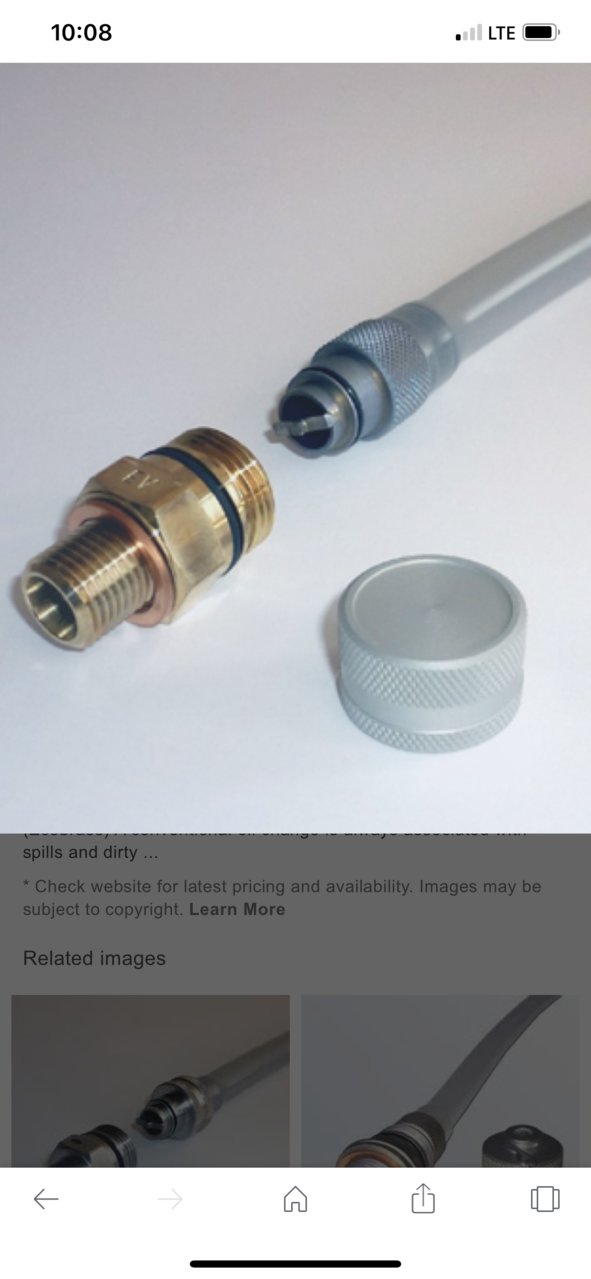

    Look up the Stahlbus drain valve. It's a spring loaded ball seat. Comes w a hose and Schrader style fitting. Much lower profile and German Engineering, that's what I went with.

    Should have been Stahlbus, boom.

    Look at post 30 :rolleyes:
