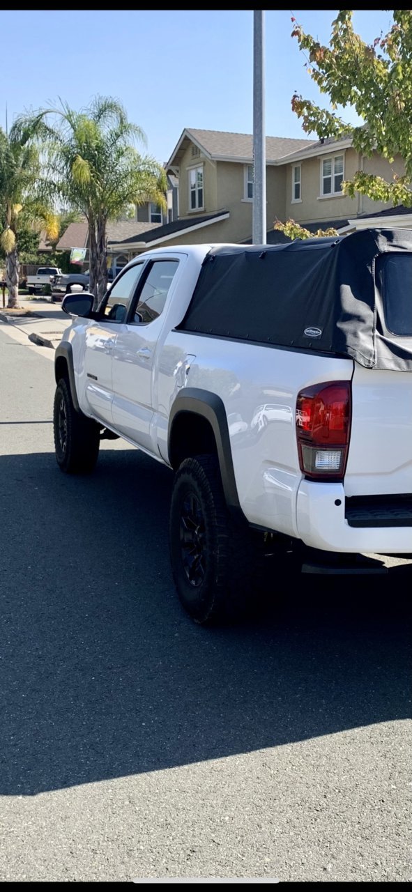

  15. Nov 29, 2020 at 9:27 AM
    Law950
    Law950 Well-Known Member
    Oct 29, 2016
    #200987
    161
    Ed
    2017 White Tacoma TRD Off Road
    Leveled with Icon Stage-3 suspension Toyo Open Country MT's, (LT265/75/R16) TRD Performance Exhaust TRD performance Air Intake

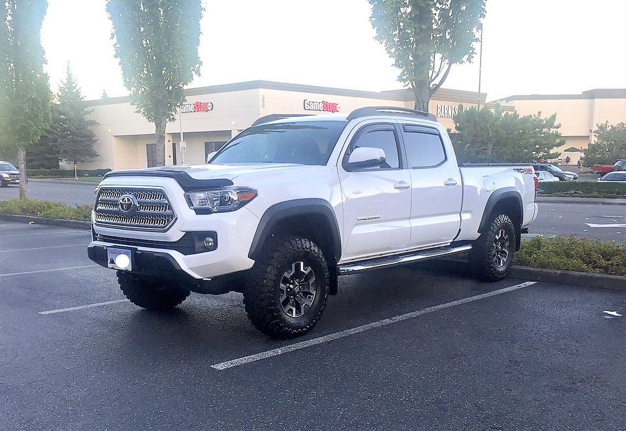

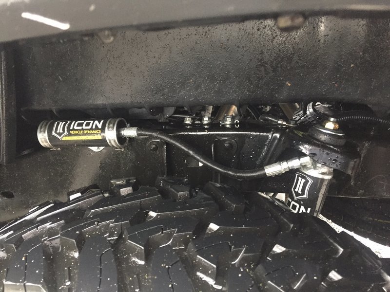

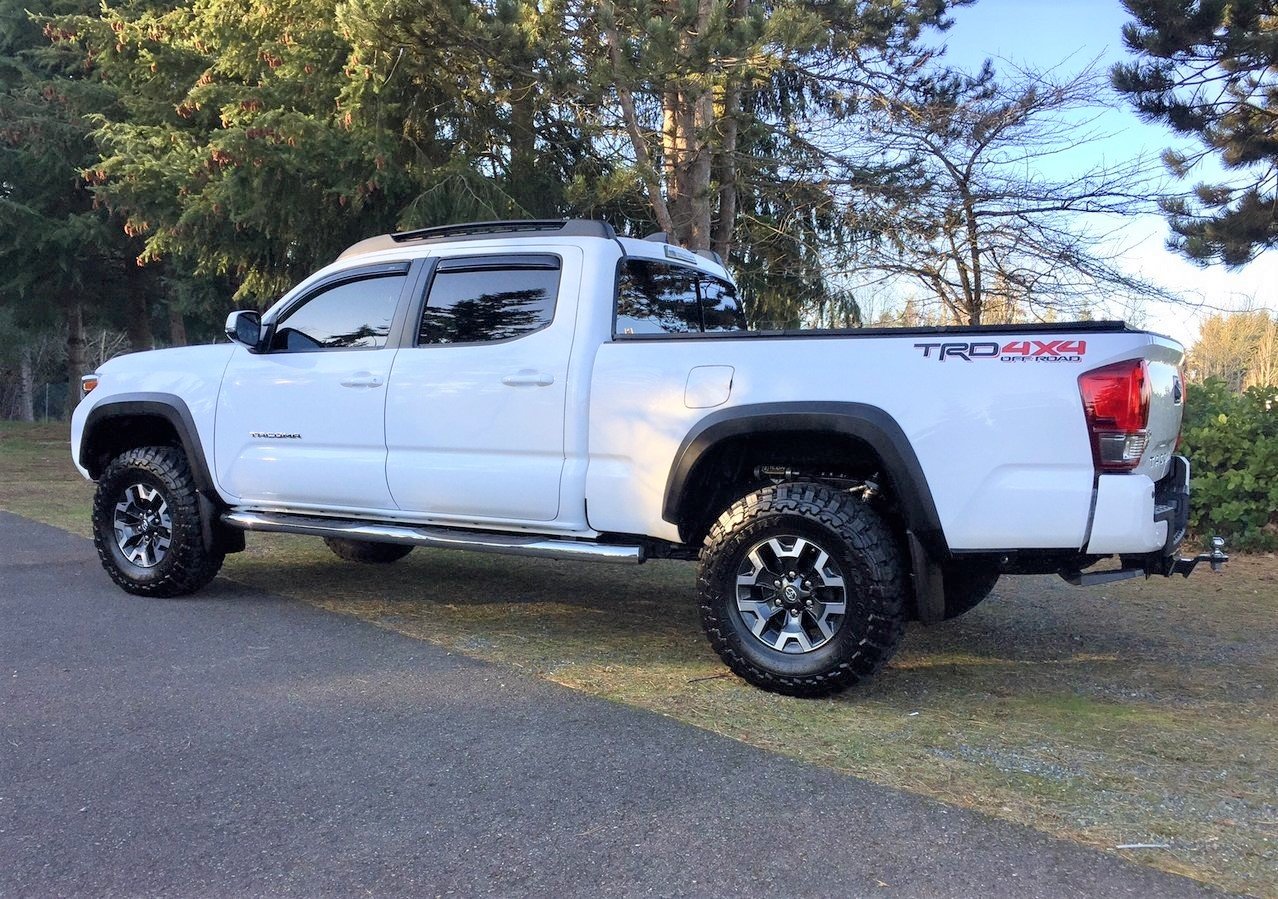

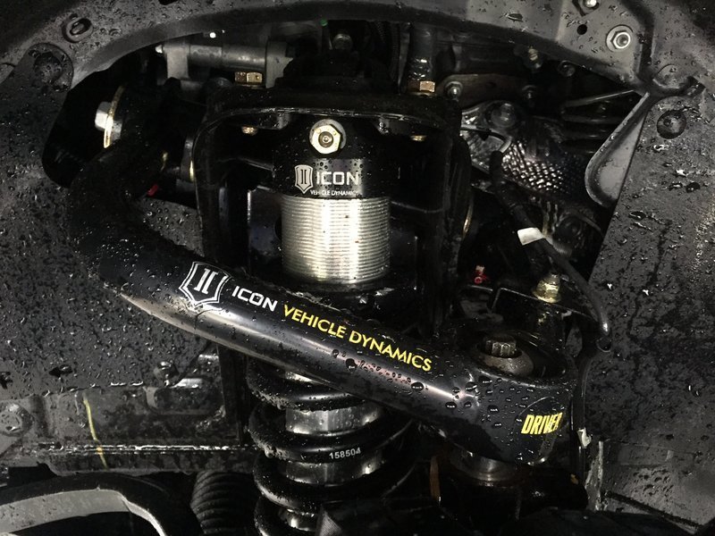

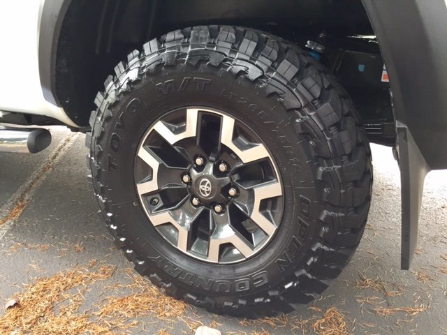

    I was in the exact same boat as you, and I also wanted the exact specs you are looking for, and for the same reasons. I have a 2017 TRD-O/R LB and I went with the Icon Stage-3 full suspension, which gave me two inches of additional lift and leveled my truck. I kept the stock wheels and fitted them with Toyo Open Country MT's in 265/75/16. The Icon's are a bit spendy but it gave me everything I was looking for in ride quality on and off the road.
  16. Nov 29, 2020 at 9:29 AM
    #16
    viclava
    viclava [OP] Well-Known Member
    Jul 23, 2020
    #335364
    130
    Scott
    North Central Washington
    2020 Tacoma TRD Off-Road
    LED lights Eibach 2.5" coil and shock liift with 2" AAL W/2* shim in rear, RTT
    That’s a sharp looking truck
    Law950 likes this.
