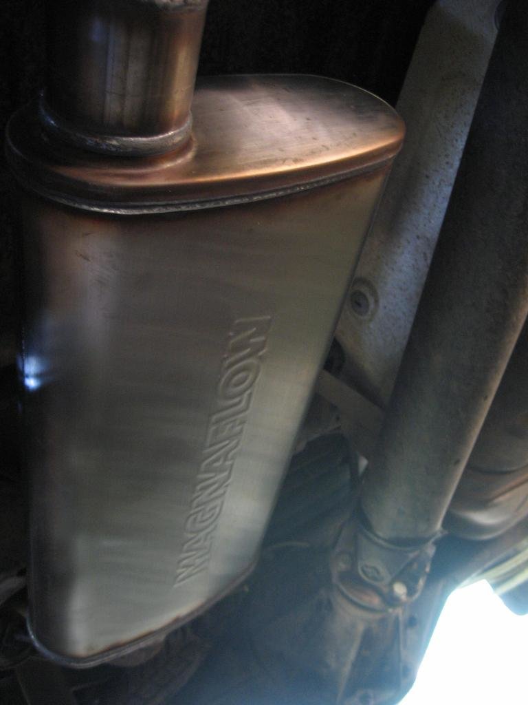

    I went from stock to an 18" Magnaflow, which sounded really good, but after about a week the sound was bothering me, so I went back to the stock muffler and dumped the pipe just behind the axle so that nothing is seen from the outside. It's basically as quiet as the longer pipe, with just a little bit more sound at very low rpms.
    The 22" will likely be more deep and mellow. But if you go to a larger diameter pipe than stock, you will lose some low end torque.

    A 2.25 Magnaflow needs the ends swedged out by a muffler shop a little to fit the slightly larger 2 3/8 exhaust pipe. They all have the hydraulic device that expands the ends in about 3 seconds. Even though the ends are 2.25, it has a 2.5 inch core. I ran this 2.25 Magnaflow stainless steel #11255 for about a week...
    and while it sounded really good...
    http://www.youtube.com/watch?v=OrDcnSSa82Q
    ...after a week the sound bothered me so I took it off and went back to the stock muffler. The Magnaflow was welded very cleanly so I cut off the welds and removed the small inner sections of stock pipe so that it's an easy slip on fit. If you might be interested in a barely used almost new muffler, it's for sale for $65 including shipping.

    That's exactly what I discovered by trying another muffler. It didn't take long to want to go back to stock. I'm sure glad I left the old one hanging around and didn't throw it out! :)
    Marine: There's a cheap and easy compromise.
    I cut my exhaust pipe and installed a tip so that it dumps just behind the rear axle and deflects away from the spare.
    In normal driving, it's as quiet as stock, but there is just a little more pleasant deep sound at very low rpms. I've been totally pleased with the results. :)

    What you are going to find is that sound is totally subjective. Pleasing to one is annoying to another. I have the 5x8 24" body Magnaflow (12586), One less then the largest universal muffler they sell. It has more sound, a bit less then the TRD that I tried, but not much. It has an annoying sound peak at about 2200 rpm. Not quite a drone though. If not for that peak, I think it would be perfect.
    Do note though that this is a v6. To me, anything that I've heard that is not stock sounds a bit ricey at idle and just off idle. After that they tend to get a better sound, but it's still a v6.....

    My 4 cylinder and the 18" Magnaflow had a similar peak resonance at 2,000. It bothered me because that's where I drive most, so I took it off.
