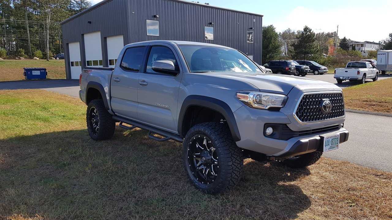

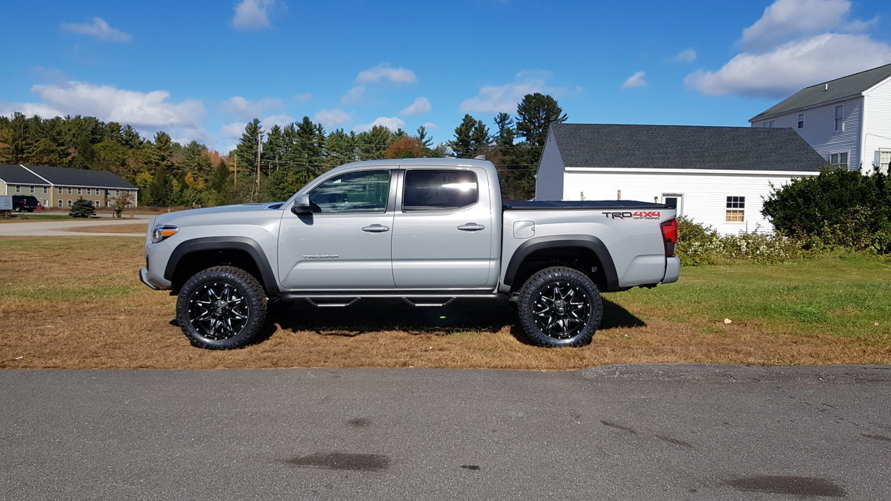

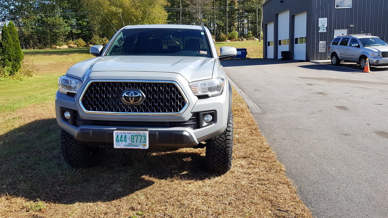

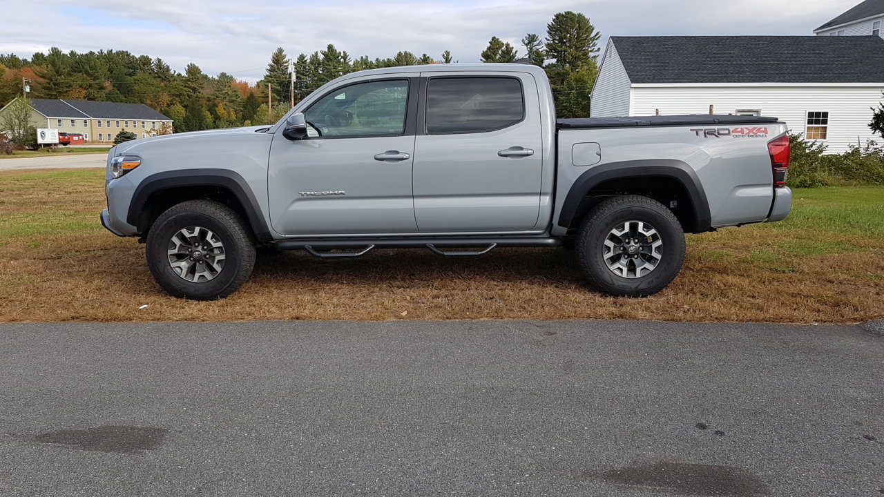

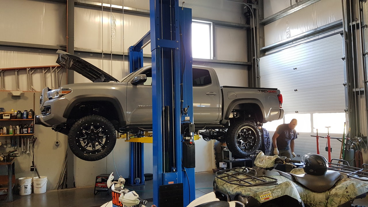

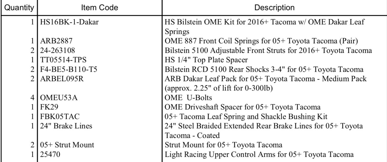

    Today I got my 2018 TRD Off Road lifted. It came out really good IMO. No rubbing, noises or vibrations. The truck had 1500 miles on it when we did the install.
    Here is what Shawn at Toy-Tech in Barrington, NH installed for me:
    The lift invoice from Headstrong Off Road. Bilsteins 5100's / OME 887's and full real leaf packs and SPC UCA's.
    I bought the wheels separately from Ready To Mount Wheels.
    Fuel Lethal wheels 20x9 Black Milled +1mm, Nitto Ridge Grappler tires (4 ply), mounted & balanced, TPMS sensors programmed and installed, new lugs.
    Here are a few photos of the truck before and after. $2195 Shipped.
    I choose a +1mm offset for a tucked in stance.

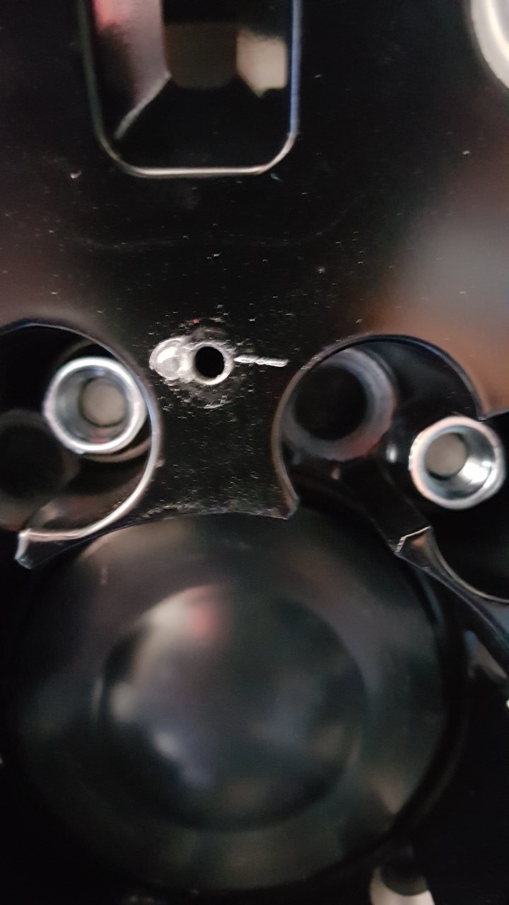

    I ran into a few small issues:
    1. 1 of my TPM Sensors came on after about 40 miles.
    2. One of the wheels had a minor defect under the center cap. The center caps are held in place with 2 small Allen heads. It looks like the tapper was off then stopped and restarted the tapping. See the photo. This defect cannot be seen unless the center caps are off.

    All said and done, the ride is nice and I am happy I did the modification.

    Very nice e!

    That is really nice on the mods .
    I would be lying if I said I was just a little jealous.
