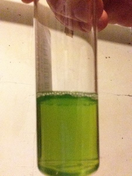

    My antifreeze

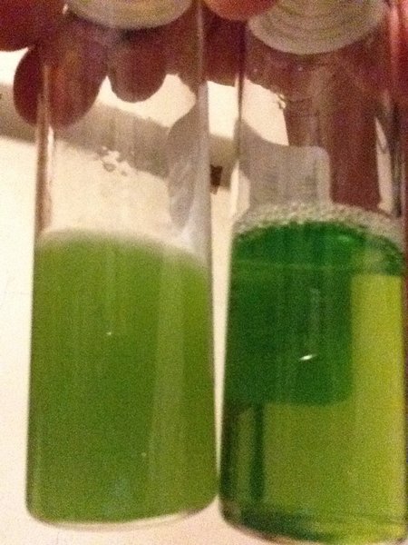

    15ml of my antifreeze with .25 ml of motor oil added on the left (shaken), my antifreeze on right. Notice the oily smudge on the glass to the left.

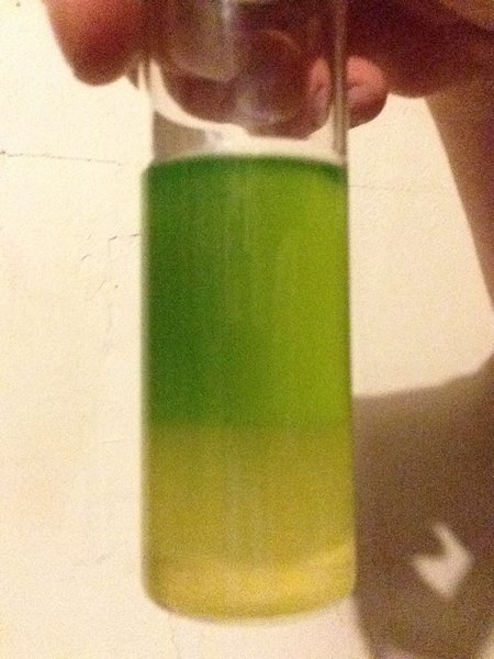

    My antifreeze with methylene chloride. Shaken in an attempt to extract, allowed to settle.

    My anti freeze with oil added. Shaken with methylene chloride and allowed to settle. Oil extract is in the bottom layer of organic solvent.

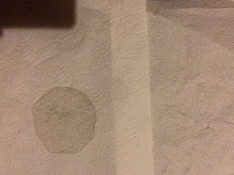

    Organic chemistry tech checking in.
    Poor controls and lousy sampling but I thought it would be an interesting way to check for oil. Unfortunately I don't have access to a mass spec instrument. So blotted the solvent on paper towels.
    Towel on left is methylene chloride solvent from oil and coolant bottle, towel on right has solvent blot from my coolant.
