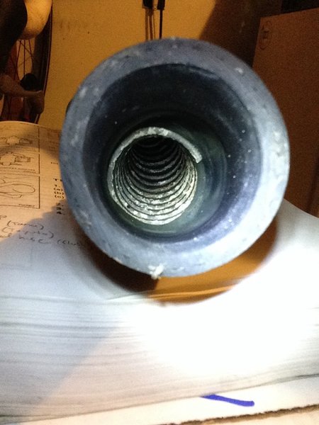

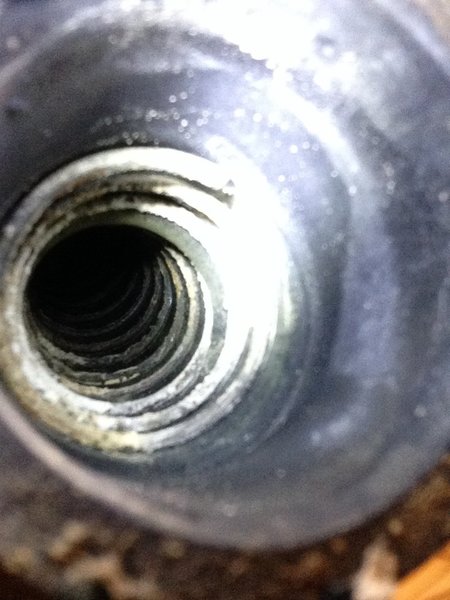

    ahh, well there is your white stuff.
    its from that stupid inner spring that corroded and those things often break apart leaving spring pieces who knows where stuck in your radiator
    never never never under any circumstances should you use a radiator hose with an internal spring. it tells you the hose is just cheap crap and it needs a spring so it doesn't kink or collapse in on itself and they always end up turning to crusty crud

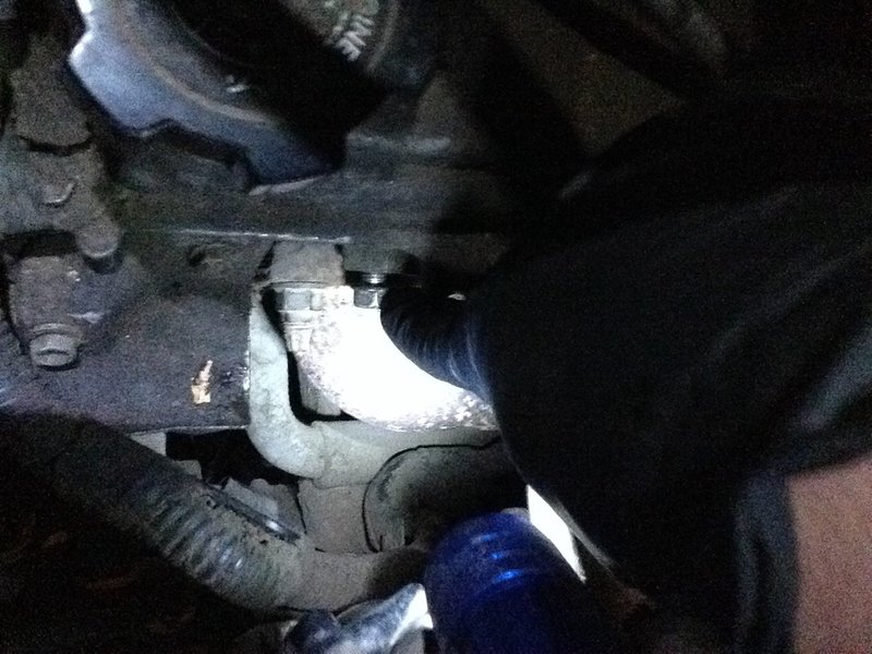

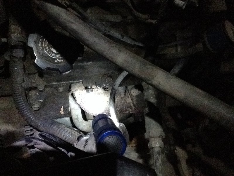

    image.jpg A bit off topic but while going over the top of the engine I see this loose bolt. Can any one tell me what it's for? I'll look up the torque specs when I know what if is.

    just went look, that's where a bracket mounts to hold that wiring harness up and off of the exhaust manifold. its kinda "tee" shaped and it connects to that bolt and the one all the way farthest to the left (on the alternator bracket) then goes straight up about 4" and the wiring loop clips onto it.

    Thanks for the reply on that. Guess mine has been re routed.
